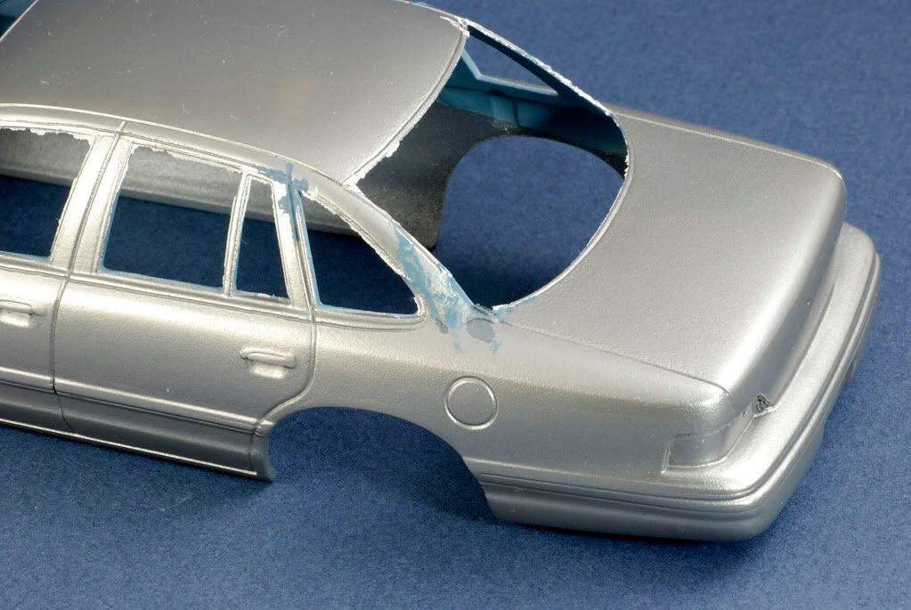

Foxer Posted August 18, 2009 Author Posted August 18, 2009 (edited) Think I was too embarrassed to put a pic up at first.. I KNOW better than what I did! Forgot to paint the headliner before doing the body. I was obsessive snugging down the tape around the windows, but obviously not enough. Primer is Plasticote sandable primer .. grey Color coat is from Paintscratch ... 1962 Ford Light Titanium needing a clear coat. Automotive touch up paint .. Lacquer Clear coats are Testors One Coat Lacquer. The clear has been one for over 2 weeks and has been polished. The blue paint is Modelmaster Enamel. I first sprayed the headliner with Krylon white sandable primer .. some of that leaked and may be the real culprit to this. I did react to the color coat that was on the headliner. That stuff is virtually unremovable. I had one body in the purple pond for a month with NO effect. The ragged areas around the windows I'm not too worried about. it all needs a black window trim painting. That's why I thought I would be ok with this.. just didn't expect the large leaks. The one spot at base of the C pillar is the only place that went through to the primer. I'm thinking at this point maybe tape off the roof and respray after cleaning it all up. Whether I can blend the area with the bare plastic spot is a question. Edited August 18, 2009 by Foxer

SteveG Posted August 18, 2009 Posted August 18, 2009 Think I was too embarrassed to put a pic up at first.. I KNOW better than what I did! Forgot to paint the headliner before doing the body. I was obsessive snugging down the tape around the windows, but obviously not enough. Primer is Plasticote sandable primer .. grey Color coat is from Paintscratch ... 1962 Ford Light Titanium needing a clear coat. Automotive touch up paint .. Lacquer Clear coats are Testors One Coat Lacquer. The clear has been one for over 2 weeks and has been polished. The blue paint is Modelmaster Enamel. I first sprayed the headliner with Krylon white sandable primer .. some of that leaked and may be the real culprit to this. I did react to the color coat that was on the headliner. That stuff is virtually unremovable. I had one body in the purple pond for a month with NO effect. The ragged areas around the windows I'm not too worried about. it all needs a black window trim painting. That's why I thought I would be ok with this.. just didn't expect the large leaks. The one spot at base of the C pillar is the only place that went through to the primer. I'm thinking at this point maybe tape off the roof and respray after cleaning it all up. Whether I can blend the area with the bare plastic spot is a question. If it didn't bite into the finishing you mave be able to wetsand it out with a 3200 polish pad. You could also try a little enamel thinner with a Q-tip. If you've already polished and waxed the body your going to have trouble applying paint again as most of those products will cause fish eyes. Next time you need paint a headliner after the body use Modelmaster acylics and brush paint it. Clean up is a breeze and you won't have worry about leak through.
Zoom Zoom Posted August 18, 2009 Posted August 18, 2009 Yikes...it's a mess . Considering your bodywork, you really should do what it takes to get it properly fixed. You either need to strip, or spend a lot of time sanding all the edges smooth...it will be easiest to repaint the whole model than try a spot repair. Did you airbrush or use the spray cans? I agree with Steve; I never spray headliners...if I did, I'd do it first and mask it to protect it from the body color, not the other way around...way too much chance of a disaster just like this. Headliners are so "not visible" that nobody can tell if you've brush painted it with acrylic.

Zoom Zoom Posted August 18, 2009 Posted August 18, 2009 Sounds like you are in one of those "rock and a hard place" situations. Considering the putty work on the rest of the model, you could face plenty of issues of any stripper attacking your bodywork in other areas. I would avoid "spot stripping" as any stripper left over could cause problems. If this were mine, I'd be getting my sandpapers and small sanding blocks ready and repair the damage that way, and then spot prime the repairs, scuff the remaining silver, and reshoot the silver over the entire car (you won't need much to cover what's on there now, you'll be doing more of a blend). When block sanding you may find you need a couple spots of putty (like the area down to the primer at the base of the C pillar, to make it smooth/blend w/the rest of the work). It may take some time, but likely less time than starting from scratch from stripping all your paint/primer and damaging the putty. Very recently I've had to do spot repairs, they are frustrating, and one instance I had to give up and start w/a fresh body (new model, no loss of custom bodywork). I try to do everything to avoid stripping paint, and even though your model looks a bit messy, it might work out okay. You'll find out quickly if the sanding is going to work or not. Just remember all the time you spent on the main part of the body...you'll have to do a ton of work there again if you have to strip everything.
