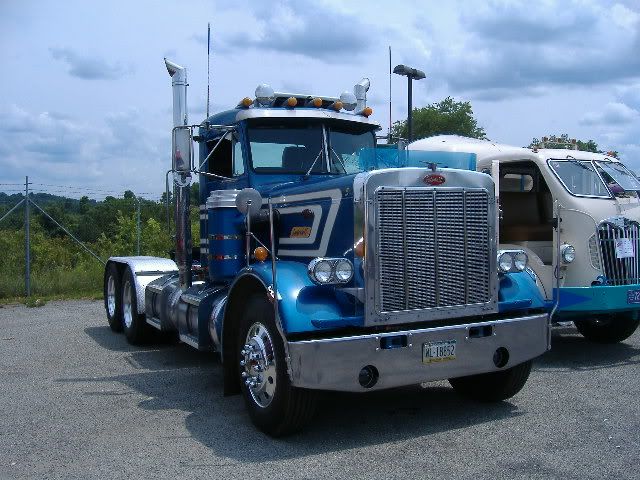

Casey429 Posted December 1, 2006 Posted December 1, 2006 Oh an I forgot to add, the Superliner was used to pull a 55 ton Rogers lowboy. It could pull a D9, completely assembeld and not break a sweat. Also, I have this pic of a 1977 Pete with a KT450, just to give some ideas.

SpreadAxle Posted December 3, 2006 Posted December 3, 2006 Casey, is that blue pete one that runs around pittsburgh, I've never seen it, but I sure would love an hour or so to drive it. it sure is pretty
