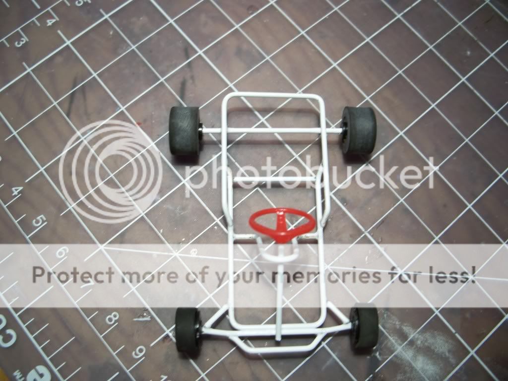

Wayne Buck Posted October 29, 2009 Posted October 29, 2009 (edited) For making roll gauges, I found that my local hobby shop sells thin metal rods that are coated in styrene. I don't know who makes them, but they are in the rack with the plain styrene rods. They have them in two sizes which is perfect one for the outer bars and one smaller for support units. I bend them with my small pliers to fit the application. They hold their shape and stay together with super glue and/or epoxy. The aluminum tubing can be used and works best if you insert a thin brass rod in the aluminum tube to help keeping it from losing its shape at the point of the bend. just added to the post....I remembered that some months ago I began a gaser dragster where I built the chassis from scratch. You can see in these quick photos how the two sizes of plastic tubes work together. This is all bent with pliers and glued together. Sorry the pictures are not better, but it was a quick shot. I also shot the two size tubes so you can see them raw. I hope this helps. ^^^ What he said. In my LHS, there are a few different sizes of plastic coated metal rod in with the plastruct styrene stuff. I primarily use the 1/16" for roll cages. I think its called butyrate... I made this with the smaller rod the other day.... Edited October 29, 2009 by NJ-Wayne

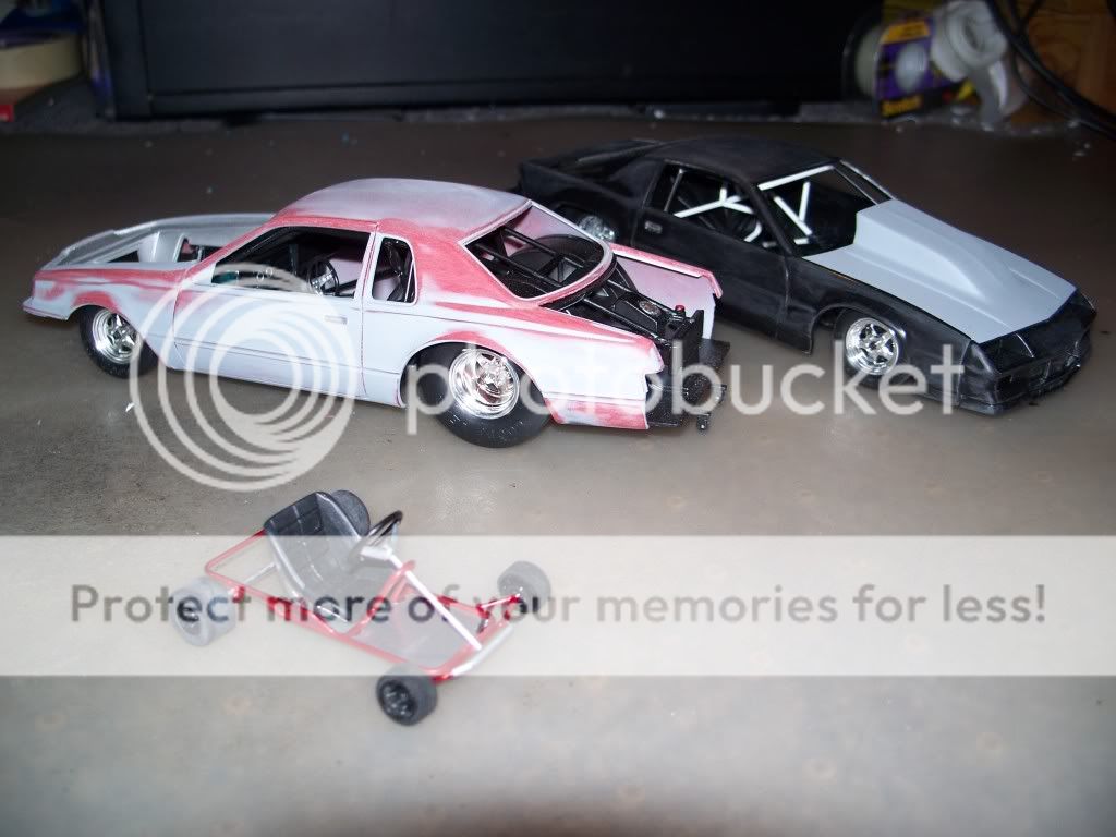

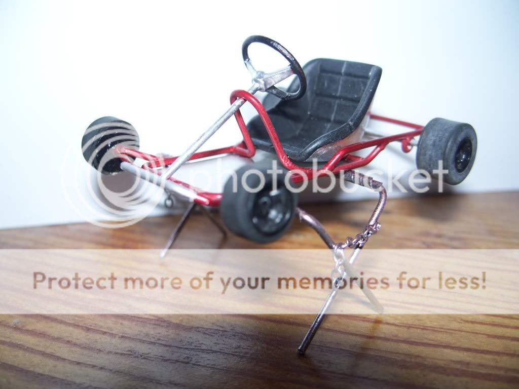

James Flowers Posted October 31, 2009 Posted October 31, 2009 (edited) ^^^ What he said. In my LHS, there are a few different sizes of plastic coated metal rod in with the plastruct styrene stuff. I primarily use the 1/16" for roll cages. I think its called butyrate... I made this with the smaller rod the other day.... That is cool. Did you use Hot Wheels car tires? You should show how you did this under Work in progress thread. What do you plan for a drive train? Edited October 31, 2009 by mustanglover1951
Wayne Buck Posted November 2, 2009 Posted November 2, 2009 That is cool. Did you use Hot Wheels car tires? You should show how you did this under Work in progress thread. What do you plan for a drive train? Thanks. The wheels are off of a little HO scale tyco Indy Car. Not sure what to do for a motor yet, but thinking about trying to scratch build a 5hp Briggs or tecumseh. I just threw it together real quick to put in a diorama I've been working on. Gotta have an old go kart sitting in the corner of the shop! By the way, not trying to hijack the thread at all, just wanted to show the nice easy bends you can make with this tubing. Here's a better picture of the frame sitting with a couple WIP's
