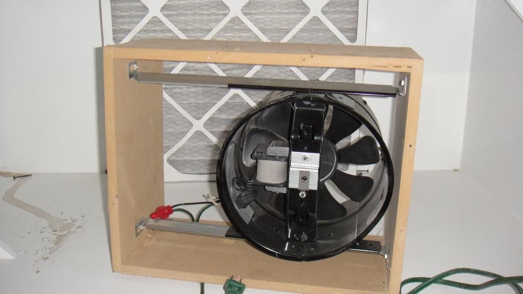

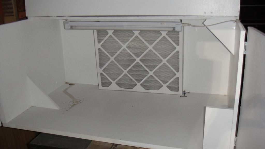

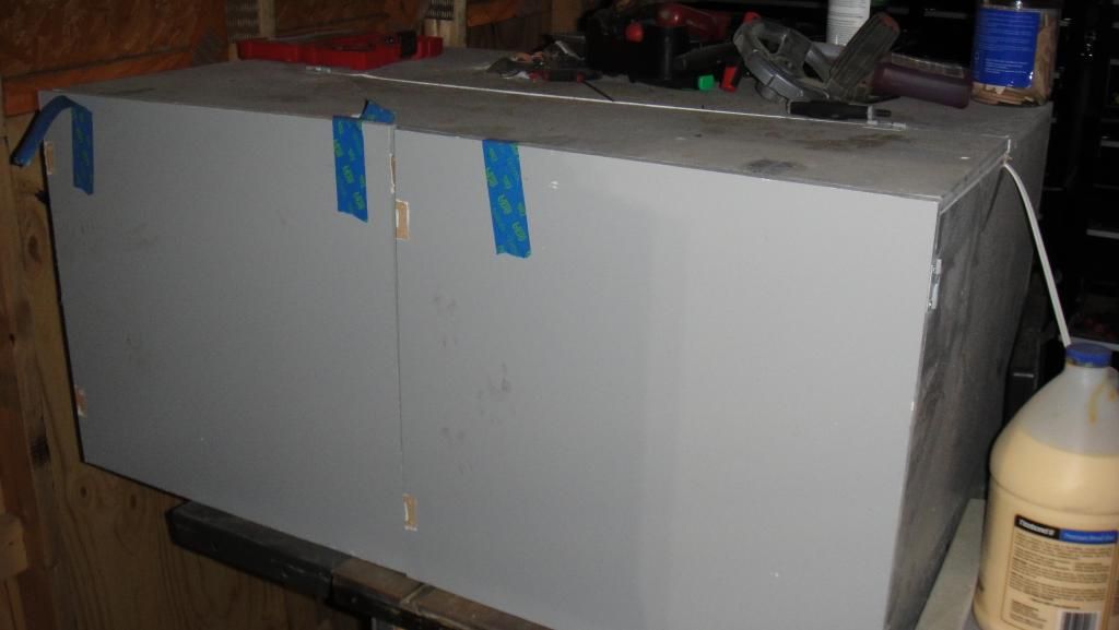

ferrarijoe Posted September 3, 2014 Posted September 3, 2014 (edited) I built mine for around $60 out of 1/2 mdf. Has high volume bathroom exhaust fan and normal ac type filter.It vents out the back threw a 5" metal dryer hose. I run it out the window.Have a power strip on it and put normal plug on fan and over hang on one side to use as self.(where glue is) Also added florescent light. If you do use a bath fan make sure it is brushless motor paint fumes are extremely flammable. So no spark is key. Mine is pretty bi since i do ships too. It is in storage right now so in pieces and dirty, but here are some pics to give you an idea. Think it would make a good pic booth too. I used it in the house with out wife knowing so it catches fumes. Edited September 3, 2014 by ferrarijoe
