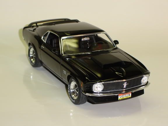

weasel Posted December 28, 2009 Posted December 28, 2009 +10 on Tamiya black, blackest black there is!! i used it on this BOSS429 if you can find Testors, they have a new '1 coat' line of paints [lacquer] and the black isn't to bad to work with...
