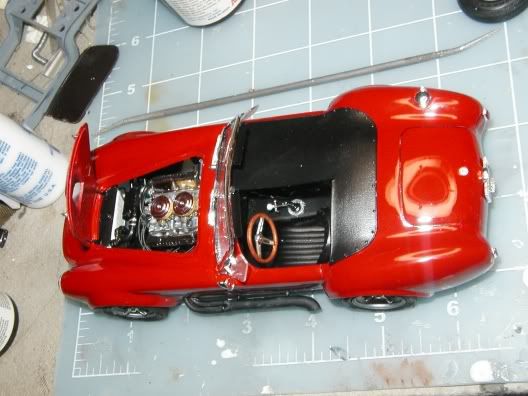

CAL Posted January 16, 2010 Posted January 16, 2010 Cal - Is there a Future spray how-to on the board? I would really like to read it - it seems interesting. What ratio do you thin it and what do you thin it with? By-the-way - Really nice looking models! Thanks There probably is a bunch of them. My technique: up the pressure on my brush to about 25psi, with a real wide spray pattren. I shoot it straight out of the bottle I start with misting some on so the heavier coats stick well. This stuff is like water really thin. I have had some bodies literally dripping with Future and they have dried perfect. Then I just go to town. Small sags and runs will go away when it dries. Larger sags and runs will need sanded out. I just layer it on pretty heavy coat after coat until I am happy with it. Works on clear "glass" parts too. And I spray it over BMF trims, badges, emblems side marker lights There is a bit of a learning curve to it how much you can get away with putting on in a single sitting, quite a lot actually, and trying to keep it all "wet" so you don't get dull overspray areas. You can tint with Tamiya acrylic clear colors: smoke, amber, red, blue, orange. you can use as glue for PE scripts It is also very forgiving. And defects just sand out and reshoot. Sides down at the bottoms are the trickiest becuase it is so thin that is were it likes to puddle, sag and run. I let it dry and recover several times drying between coats and little or no sanding. Do not wet sand it will strip it all off. New coats of Future will melt in with old dry coats. I grabbed a few bodies and played with it first awhile to get a feel for what it was going to be like to work with. It is not really like working with paints or other clears. If you understand it you can get outstanding finishes. If you use like a paint or clear you can still get good finishes but will miss the true beauty of this stuff.
