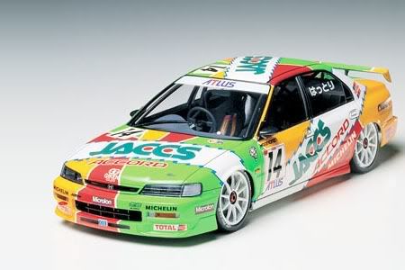

wgflatliner Posted March 10, 2010 Posted March 10, 2010 i'm working on that same exact accord. my plans are to do clear over the colorful blocks. the sponsorship decals (has the numbers, sponsors, etc) i plan on putting on top of the clear coat. the end result looks like the colored blocks are part of the paint, and the decals that are supposed to look like decals indeed look like decals. i hope it turns out good! as far as trying to use paint to paint on what would be decals, that's more than likely going to give you thicker edges than the decals. that's been my experience anyways.
