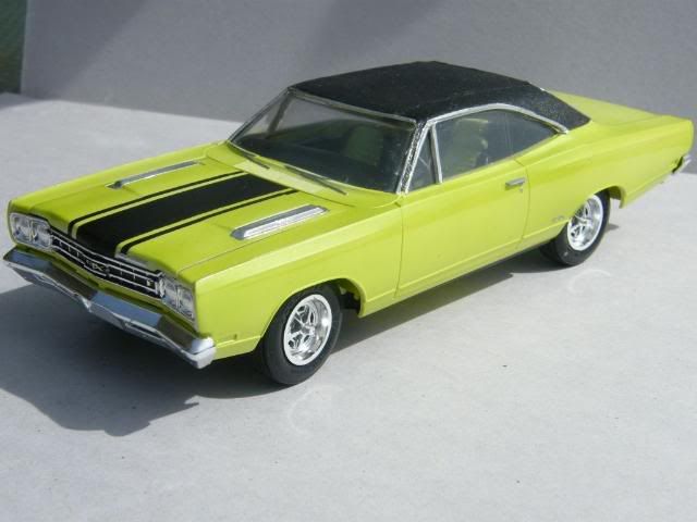

Car Crazy 81 Posted March 3, 2010 Posted March 3, 2010 (edited) What about Rust-Oleum "Textured" Black i'd used that on my 68 Charger it came out just fine it can also be used on replicating undercoating on frames. Heres what the Rust-Oleum Textured paint looks like for a vinyl top. Heres what it looks like on a frame. Edited March 3, 2010 by LSU Fan 1981
