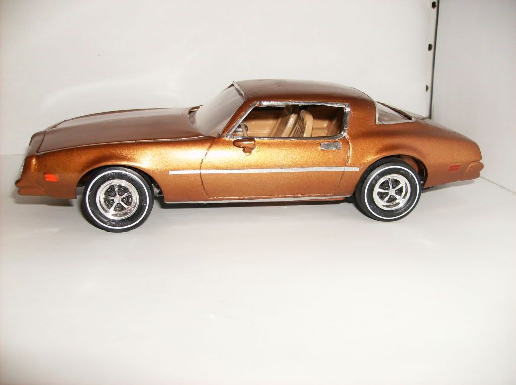

Nick Winter Posted March 23, 2010 Posted March 23, 2010 One easy way is to get some of the AMT Firestone supersport tires, they have a recessed cricle, all you do it take a brush and paint it in, then wipe off the excess That's what I did for jimmy's F'Bird
