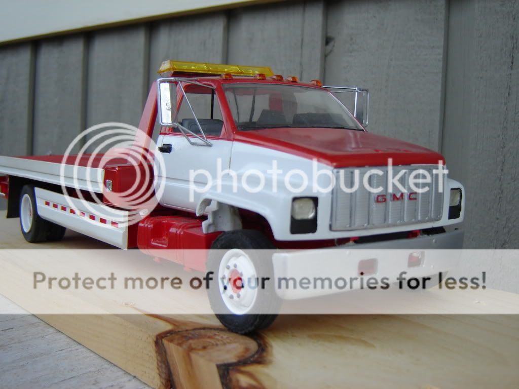

chuckyr Posted March 24, 2010 Posted March 24, 2010 http://s429.photobucket.com/albums/qq13/danielgailloux/GMC_Topkick/
rollinoldskoo Posted March 24, 2010 Posted March 24, 2010 the resin mentioned above is more like this one i made.... the newer ones are a different body
Sergey Posted March 24, 2010 Posted March 24, 2010 the resin mentioned above is more like this one i made.... the newer ones are a different body Very Impressive Pick Up, although it has many inaccuracys: GMC badge on the grill and "Chevrolet" on the rear gate. 22,5' wheels & uder Cab fuel tank with Pick Up body is quite a custom. Have you used PickUp bed from Silverado?

rollinoldskoo Posted March 25, 2010 Posted March 25, 2010 Very Impressive Pick Up, although it has many inaccuracys: GMC badge on the grill and "Chevrolet" on the rear gate. 22,5' wheels & uder Cab fuel tank with Pick Up body is quite a custom. Have you used PickUp bed from Silverado? slow down with your comments man..... this is a model of a 90's topkick..... do some homework and check the links posted... sauerkraut has the same style body style posted.... and the tailgate? dude its a sticker.... and who really cares that much besides an IPMS show?
Sergey Posted March 25, 2010 Posted March 25, 2010 (edited) slow down with your comments man..... this is a model of a 90's topkick..... do some homework and check the links posted... sauerkraut has the same style body style posted.... and the tailgate? dude its a sticker.... and who really cares that much besides an IPMS show? O-Key, my mistake. Peace. Can you share some pictures of the prototype (the real PickUp) for your model? I'm collecting the information to build my own 90's Top kick using Perry's Resin Cab: http://www.perrysresin.com/catalog/pics/p_topkick.jpg Edited March 25, 2010 by Sergey
