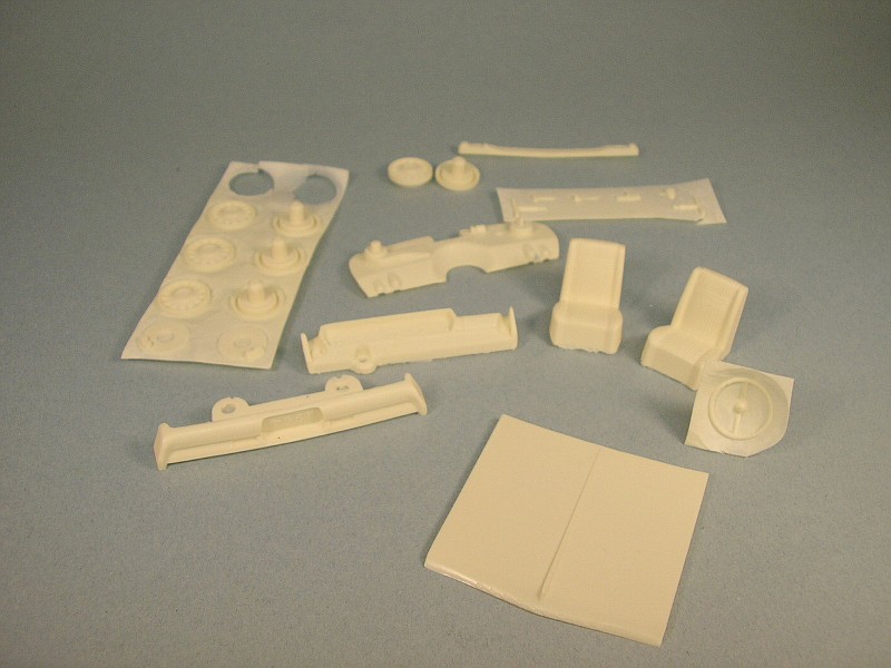

MrObsessive Posted May 2, 2010 Posted May 2, 2010 (edited) I teased you guys with a sneak peek photo a while ago, of a kit I was going to start. Well as some of you guessed, it's the very nice resin 1964 Oldsmobile Cutlass 442 from P&P Resin Works. A very nice casting as I saw no air bubbles or a badly cast part anywhere! Here are some pics of what you get............. There's also a nicely cast interior tub which I forgot to take a pic of...........I'll be making some changes with that though along the way. I'll be using the AMT '66 Olds kit for donor pieces such as the chassis, interior bits, and engine. I'll also be making my own glass for the kit using clear stencil sheet as my usual practice. With warm weather here now however, don't look for frequent updates..................yardwork, housework and a full time job (3rd shift) have seen to it that my modeling time is pretty limited. Stay tuned for an update later though of what I've done to get started with the inner fender wells so far............ Edited May 16, 2010 by MrObsessive
MrObsessive Posted May 2, 2010 Author Posted May 2, 2010 One of the first things I want to do, is to make a reasonable engine bay for the kit. I'm not a fan of the lifeless, round "fenderwell only" look of a lot of the old kits. So here, I'm measuring out a donor AMT '66 Olds kit for use in the '64. In 1:1, 1964-67 GM midsizers all used the same inner fenders as well as cowls and windshield shapes. Well, comparing this to the '64, it looks as though I'm gonna come up a little short. I'll have to dig up some of my reference photos to see what we can do. Here's a nice engine bay photo (one of a number I have) of the '64. That air cleaner is going to be a tough one as I can't think of anything close at the moment. Some scratchbuilding is probably in order. In the meantime, I did cut the entire engine bay from the donor kit. I think that I'll have to separate everything however due to the shape of the '64 fenders, and for it to appear correct in scale. I did cut everything apart, and I'm "widening" the inner fender wells. I've got my work cut out for me it seems............. That's is for now folks..............I've got some work to do on the outer fenders themselves according to the 1:1 pics as well as try to test fit the firewall, floorpan and frame so things fit with no drama down the road. Thanks for lookin'!
