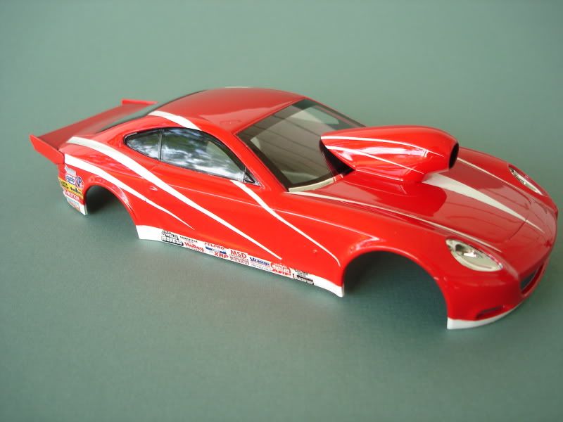

chris coller Posted June 1, 2010 Posted June 1, 2010 I just turned one into a pro stock slot car body
