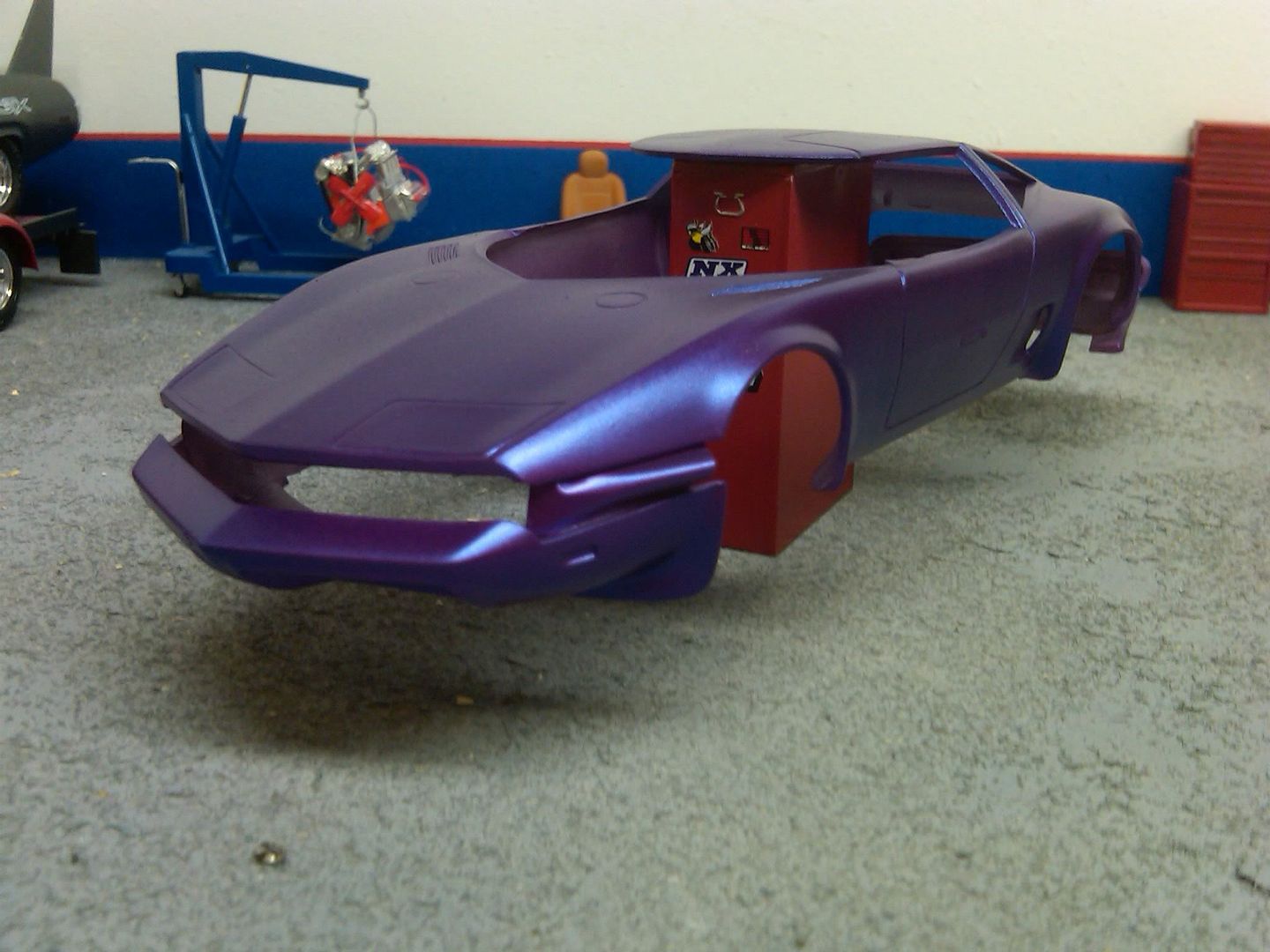

diymirage Posted June 25, 2010 Posted June 25, 2010 ive only painted one model with nailpolish it was a 99c bottle from meijer called pizzaz frost or something i thinned it out with laquer thinner to the consistancy of milk...in this case it was closer to 3 parts thinner to 1 i used a grey primer, german silver base coat and about 11 (eleven) coats of nailthinner (admitted i may have watered it down just a tiny hair to much) havent finished the model yet but here is the body

raymanz Posted June 26, 2010 Posted June 26, 2010 ive only painted one model with nailpolish it was a 99c bottle from meijer called pizzaz frost or something i thinned it out with laquer thinner to the consistancy of milk...in this case it was closer to 3 parts thinner to 1 i used a grey primer, german silver base coat and about 11 (eleven) coats of nailthinner (admitted i may have watered it down just a tiny hair to much) havent finished the model yet but here is the body That's a VERY SHARP Body and Color looks KILLER! Good Job!
diymirage Posted June 26, 2010 Posted June 26, 2010 That's a VERY SHARP Body and Color looks KILLER! Good Job! why thank you hard to beleive thats a chevy
