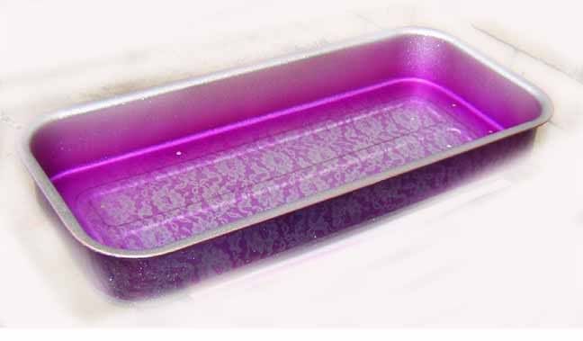

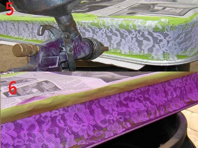

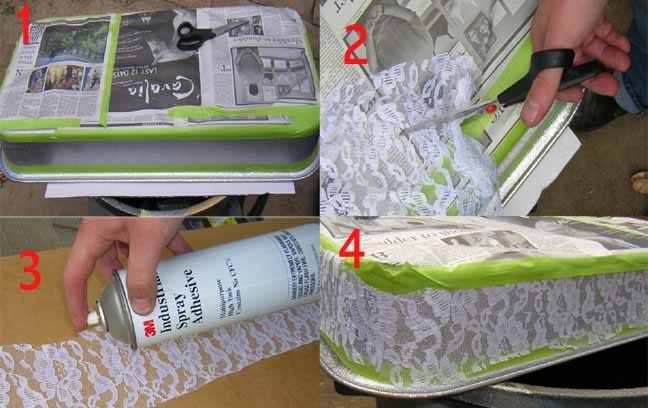

Joe Handley Posted June 26, 2010 Posted June 26, 2010 Funny you bring this up, I had thought about doing something along those lines on one of the HPI ponycar bodies (probably he AAR Cuda....) just for the heck of it I even found these pics at the time too. It's being applied to a Radio Flyer style wagon, but is enough to get the just of how to do it on an external surface Hope it helps you some, and definately post up some pics when you get that LB done!

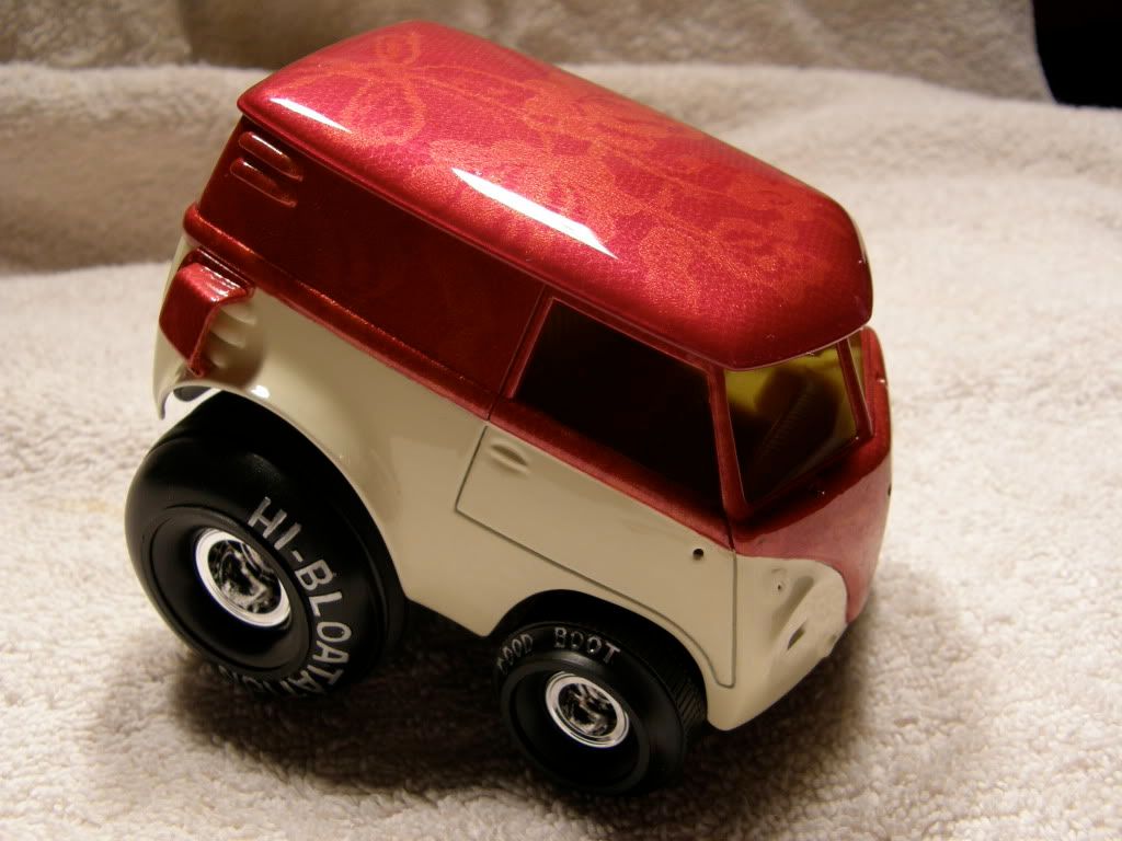

Karmodeler2 Posted June 27, 2010 Posted June 27, 2010 I went to Hobby Lobby, convinced the lady I was buying lace (which they have several different "scales" per say) for a paint job and just did it. It turned out okay and I was pleased. I tried it on spoons first, then did a different lace on the boards.
Joe Handley Posted June 27, 2010 Posted June 27, 2010 (edited) In 1970 I was in my senior year of high school and heavy into muscle cars of the day. My own ride was a 66 Chevelle with a transplanted 427 in it. I had done a bunch of buddies' cars paint jobs and did do a couple of lace jobs. Pretty simple to do. Jairus is pretty accurate on the time frame. Vans were probably the biggest receiver of lace paint among other techniques maybe followed by drag cars. Cobwebbing was big as was using a rainbow of colors in many panels outlined by pinstriping in never ending lines. Then there was metalflake and pearl paint and let's not forget all that wild psychedelic ###### on all those VW vans too! Oh and another one I forget the actual name for was when you would paint a spot with the airbrush and then blow all the paint out in all directions with just the air alone. I think it was called a "freak drop" or something like that. I also recall another technique where painters would apply saran wrap all scrunched up onto freshly sprayed paint to get a weird effect. Painting lettering that looked like chrome was big too. I'm sure there are others but it was some 40 years ago and my memory definitely ain't what it used to be! I think I know what you're talking about with the "freak drops", but I can't remember what those are called off hand either. The saran wrap thing is still being used by people who paint RC bodies too but now call it "marbling", usually spray some kind of pearl paint onto the inside of the body that take saran wrap or cheap, store sourced plastic bag and twist it into the still wet paint then back coat it with another color afterward. Another trick some RC guys do is to get some of the rubber like shelf liner that is molded to have a woven style shape to it. You lay it down over the lexan in the same way you would the lace, then shoot a silver or light gun metal color paint through the liner, you then remove the liner and back the first color with a metallic black, dark gun metal, or charcoal. If done correctly it will give a bit of a carbon fiber or woven graphite appearance to what ever you apply it to. *EDIT* AhHa! finally found the kind of liner I'm talking about for the Carbon Fiber/Woven Graphite look! http://housewares.hardwarestore.com/37-188-shelf-and-drawer-liners/magic-cover-natural-weave-liner-126179.aspx I've also seen people use this stuff and as a mask and claim it "looks like Carbon Fiber", but it comes out looking more like a line grid type graphic instead. http://www.homedepot.com/Building-Materials-Drywall-Drywall-Accessories/h_d1/N-5yc1vZ1xi3Zaq0l/R-100671081/h_d2/ProductDisplay?langId=-1&storeId=10051&catalogId=10053 Edited June 27, 2010 by Joe Handley
iBorg Posted June 27, 2010 Posted June 27, 2010 Karmodeler2: I absolutely dig you Deal's Wheels Van. Have you thought of adding some freak drops to it? Really not hard to do. Thin the paint down a bit more than normal. Than hold the airbrush still and shoot a small circle. Then move in closer and blow the paint with the air without adding any more paint. If you pay attention to where you angle the brush you can cause the paint to move in the direction you want. The trick for me was to always remember to aim in the opposite direction of where I wanted the center to be. Mike
BigGary Posted June 27, 2010 Posted June 27, 2010 (edited) Lace definately hit its peak in the early 70s. The lace on the van above is as overblown as the wheels and tires but way out of scale. As with so many fads, it soon passed. Gary Edited June 27, 2010 by BigGary
