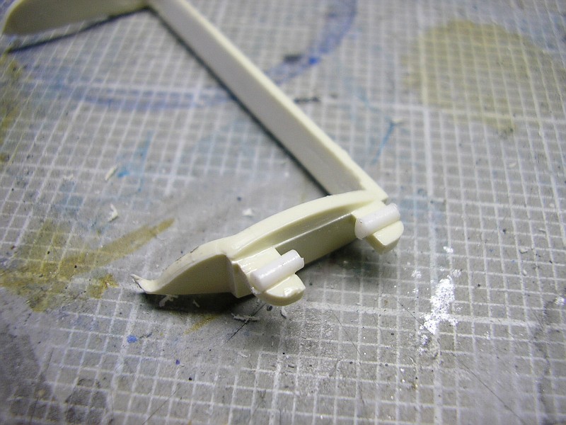

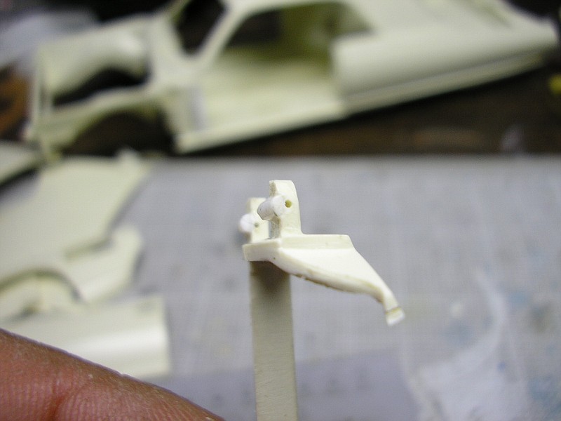

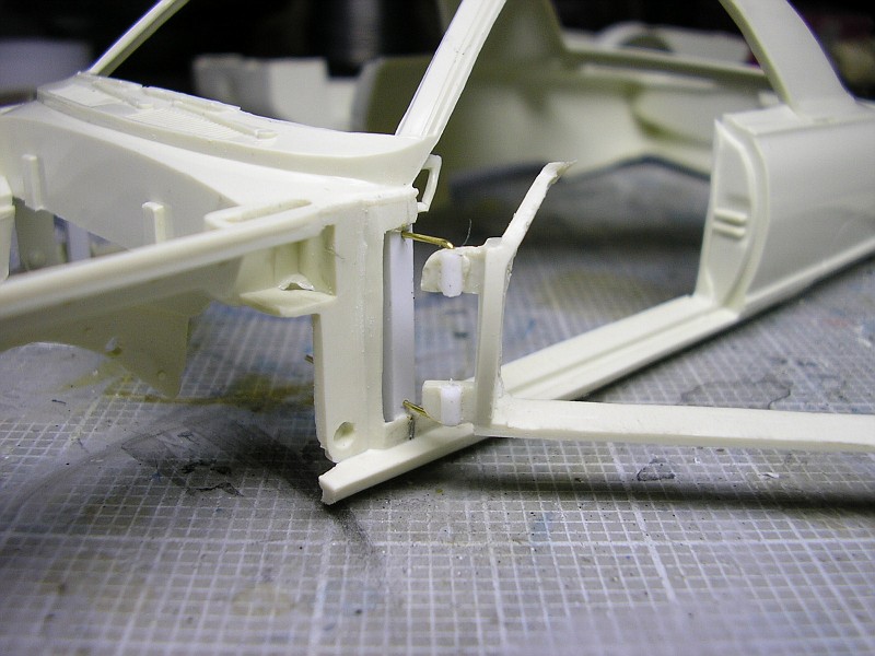

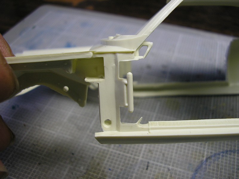

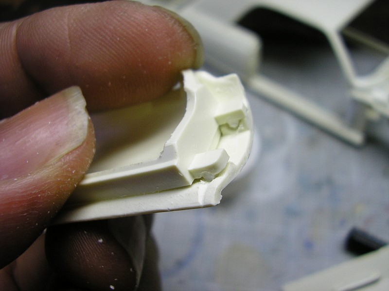

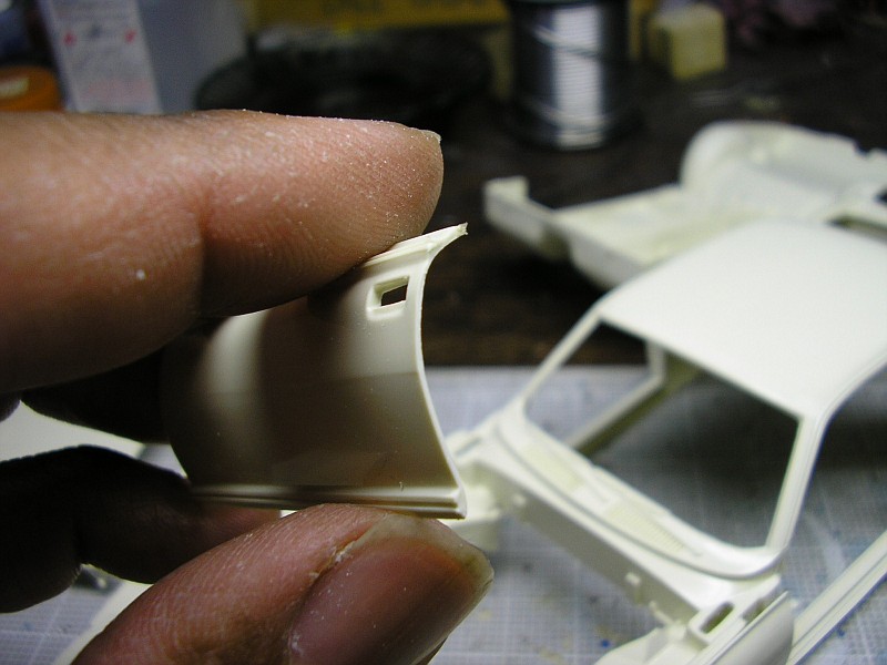

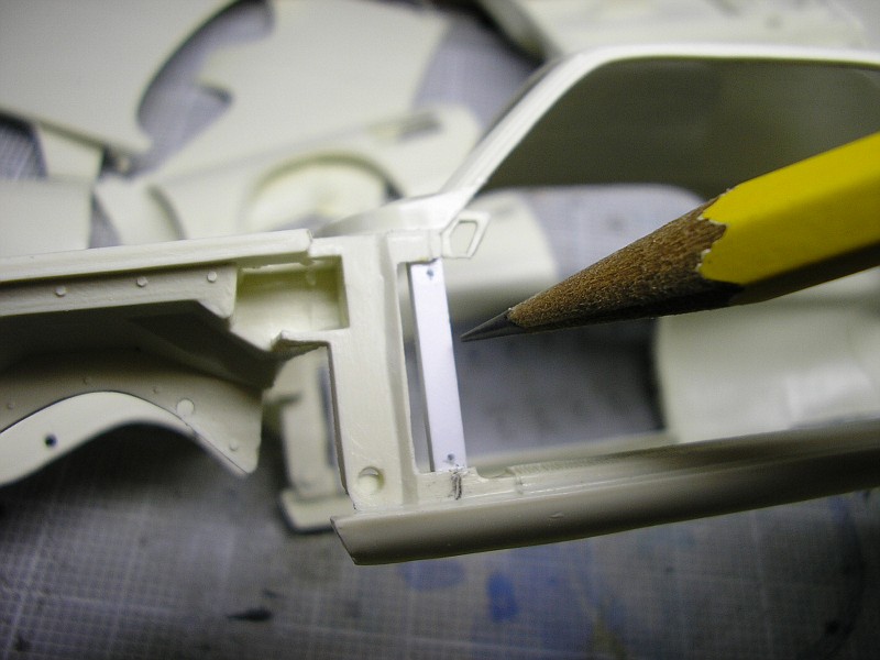

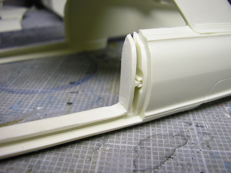

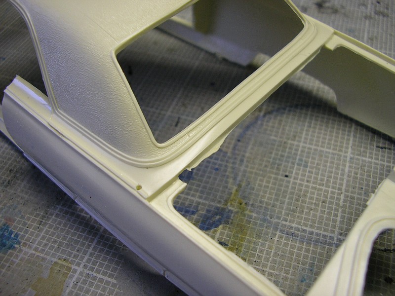

MrObsessive Posted February 2, 2007 Author Posted February 2, 2007 I figured I might as well start on what may be the toughest aspect of this model..........hinging the doors! This update focuses on one side as obviously the other side will follow suit as well! This went along pretty smoothly...........I just wished I could have known these techniques back in 1985 when I built this model last! I took the cutters and cut away the original hinge here................good thing I marked off where the hinge points were as I'd surely forget! I then took my Dremel Moto tool and grinded away at the too thick door, to a thickness which is more in scale at the trailing edge of the door. I don't want to make this too thin as it can become a problem when painting and polishing.................the edges will be hard to keep paint on. Hmmmm.................Johan molded the inner door panels as part of the door jamb. While this is expedient from a manufacturing standpoint, in 1:1 it's not realistic as your door jamb is part of the door skin, and the inner door panel is a separate piece as part of the interior. I simply took both sides of the exacto blade and cut as best I could the inner door panel away. Here's the separated door panel..............later I will build the door panel back up with sheet plastic to more closely match the contour of the door jamb. To build up the hinge area I got some plastic rod which closely matches the circumference of the original hinge area. Yes, there's a method to my madness as you'll see! The rod was glued in with Ambroid Pro Weld and was left alone to sit overnight. Once I let things sit overnight, I test fit the area over where the door would have "trapped" the original hinge over the body. To deepen the area, I ground out a bit more of the channel in the door with my dremel. Hmmm...............fits pretty good.........I think though that I'll grind out just a scooch more so everything fits flush. Since these doors pivot (as opposed to the swing out type), they will need something to pivot on................I took a #75 drill bit and used the pin vise to drill holes in the plastic rod area. Mind you, this is all eyeball engineering........I have no scientific precise measurements to tell me exactly where the holes should be. :wink: I placed the door jamb inside the body, and then marked off on the body hinge support approximately where my "hinge pins" will rest. The hinge support is evergreen plastic square rod...............I can't remember the size-----I try to pick something that looks in scale. Here's what I use for hinge pins.................simple brass rod (about .020 dia.) Just bend them at right angles to hold the door jamb in place. So far so good................the door jamb swing open and closes without any binding.............almost........ I'm gonna have to cut away some material at the leading edge of the door jamb hinge area. When I try to open the door, the "excess tabs" push the leading edge of the door jamb outwards..........obviously, that won't work! :shock: The trailing edge of the door jamb when fully shut................I may replace the tab that Johan molded in to keep the door shut with some type of catch. This may be a watch pin (ala my '69 Charger Daytona) or some other contraption I can fettle together! Inside of the door jamb hinge support.................when everything is fully painted and detailed, these pins will be epoxied in the holes. When the epoxy has fully dried (overnight) then I'll simply cut them away flush too the hinge support. Then I can put in the rest of the interior with the kick panels, etc. Here's the door "skin" up against the door jamb. There's a faint horizontal crease on the door that doesn't quite line up with the rest of the body. Using the method I did with the '05 'Vette..............I'll redo this crease to make it more in line. The door is fitting pretty well, as I mentioned above, I want the leading edge of the door to fit just a scooch tighter against the hinge area/interior door jamb. Note that I still have to cut away the tabs that were sticking out and causing the binding. Just a little bit of binding was still occurring, so I got the Dremel and ground some plastic away on the hinge support. I tried to "round them" so when the door opens there is some clearance to keep them from pushing away from the support. AHHHHHHHHH!! Much better since I cut those tabs away! No pushing out, no binding............everything looks honky-doory! One thing to keep in mind when hinging doors, is you want to make sure your hinge support is exactly vertical and not leaning either way. If the bottom of the hinge leans to the inside of the door, it'll make the door appear to be "hitting the curb". If the bottom edge is to far to the outside of the body, the opened doors will look like "butterflies", and look just as peculiar. The door jamb here looks to be nice and level, although I have to account for the fact that the body is very slightly warped. As time goes on, I'll be checking the opening and closing of the doors for a fit appearance. I'll try and finish up the drivers side door, and then move to the other side throughout the weekend into next week------then I'll try to clean up the other body flaws. :shock: Stay tuned! :mrgreen:
62rebel Posted February 2, 2007 Posted February 2, 2007 Bill; i found the same itchy spot on the AMT 56, 57 ford and 58 impala doors; that the inside panel was molded as part of the door shell, and took a similar approach by cutting them off the "frame", cementing the frame in place to the door skin, and installing the inner panels later on. this greatly simplified creating customized interiors for me, and eased doing the fine detail work on that great '50's trim. if i were a little more ambitious i'd create some working window lifts... but i'll leave that to YOU!
