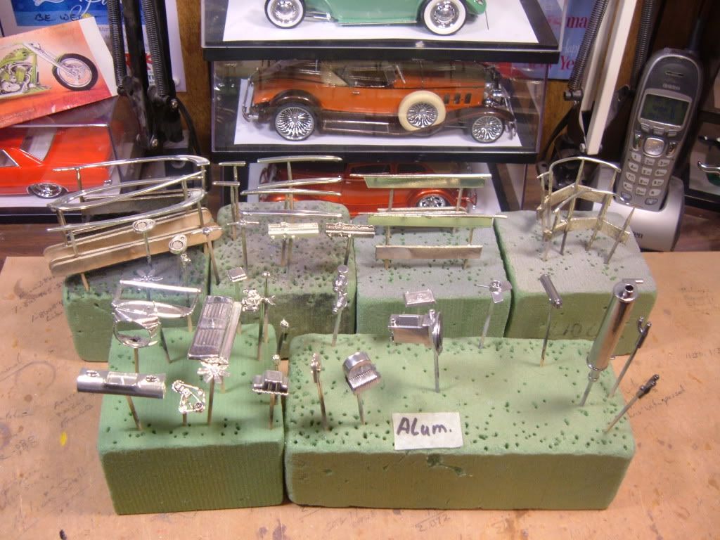

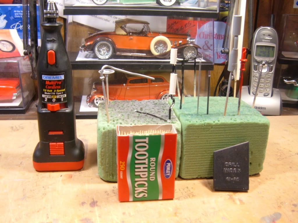

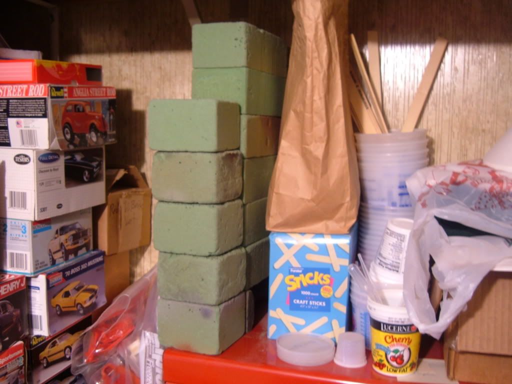

E St. Kruiser50 Posted July 3, 2010 Posted July 3, 2010 (edited) I have a simple little system that's worked well for me for about a dozen years. In the first pic you see tooth pics, a set of micro-mini drill bits, a cordless Dremel with an accessory drill chuck for mini-drill bits, and a couple chunks of floral foam from Michaels Crafts, that I cut into smaller pieces. I drill a small hole in a plastic part that is usually already been cleaned up and readied to be painted, and insert the tooth pick into the hole for handling while painting, and the rest of the time it's in the foam block, either waiting to be painted, or curing after painting. For really tiny parts the tooth pics can be sanded down to a very tiny point and one of the smallest drill bits in the set can be used in the plastic part. I usually use a larger drill bit most of the time as it makes handling not so "tedious" or "Spindly" . The round tooth picks are tapered, so it makes for a nice tite fit, especially if the hole is drilled deep enough - DUHHH . Or, if you can't drill a hole in the part, I cut off the end of a tooth pic to flatten it a little (depends on the size of the part), add some "Super-glue" - ZAP IT, for a quick set, stuff it into the block of foam, and your set for the next part, and everything is easily accessible, and can be nicly organized and arranged. In this second pic, I have a stash of these blocks, because I may have 2, 3,4 or more projects going at one time, that I'm detailing parts for. A nice supply is always handy , and helps keep project parts separated and organized - I LIKE ORGANIZED . And lastly here's a "Family pic" of a whole buncha parts - LOL Edited July 3, 2010 by Treehugger Dave

David G. Posted July 3, 2010 Posted July 3, 2010 I have a simple little system that's worked well for me for about a dozen years. In the first pic you see tooth pics, a set of micro-mini drill bits, a cordless Dremel with an accessory drill chuck for mini-drill bits, and a couple chunks of floral foam from Michaels Crafts, that I cut into smaller pieces. I drill a small hole in a plastic part that is usually already been cleaned up and readied to be painted, and insert the tooth pick into the hole for handling while painting, and the rest of the time it's in the foam block, either waiting to be painted, or curing after painting. For really tiny parts the tooth pics can be sanded down to a very tiny point and one of the smallest drill bits in the set can be used in the plastic part. I usually use a larger drill bit most of the time as it makes handling not so "tedious" or "Spindly". The round tooth picks are tapered, so it makes for a nice tite fit, especially if the hole is drilled deep enough - DUHHH. Or, if you can't drill a hole in the part, I cut off the end of a tooth pic to flatten it a little (depends on the size of the part), add some "Super-glue" - ZAP IT, for a quick set, stuff it into the block of foam, and your set for the next part, and everything is easily accessible, and can be nicly organized and arranged. That's really clever, I'll have to try that. I have a number of those foam florist blocks that I used to use for the hydrator in my old humidor back in the day. Currently I have a couple of 1 X 2's about eight inches long around which I wrap strips of masking tape with the sticky side out. After removing the the small parts from the sprue and cleaning and de-flashing them, I stick them to the tape strips and place the board on my paint table across a couple of spray can lids. I found that lifting the board a couple of inches above the table surface seems to reduce dust problems.
