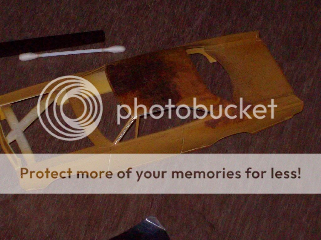

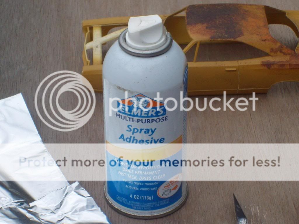

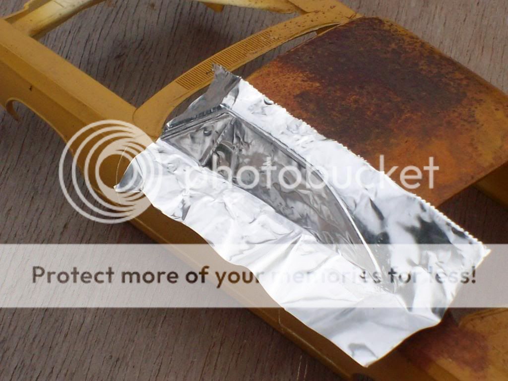

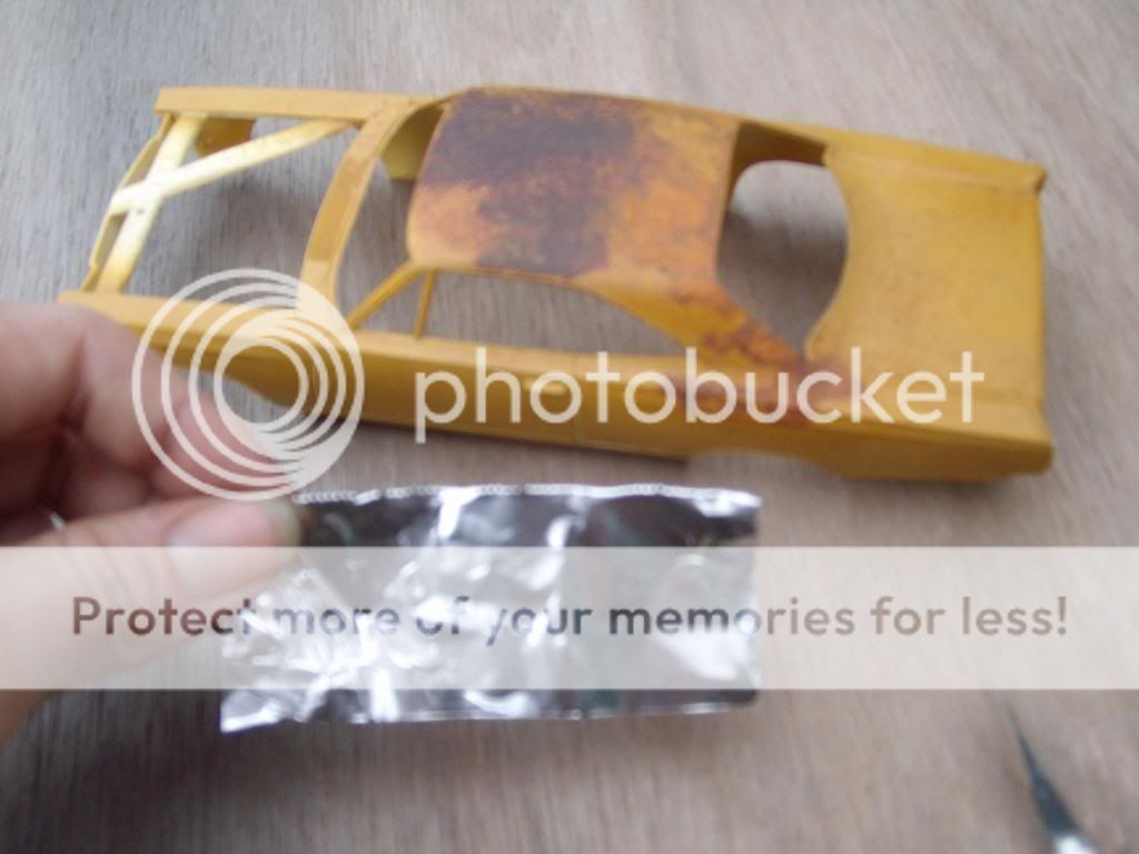

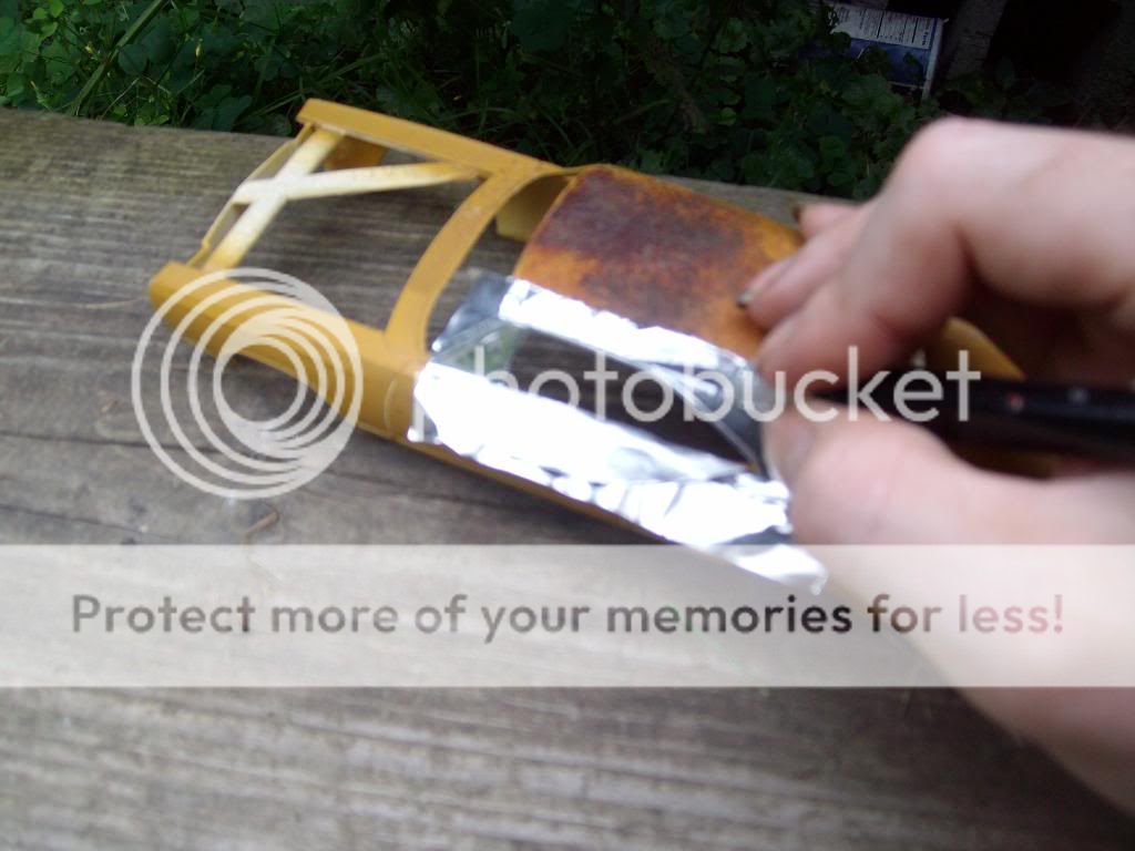

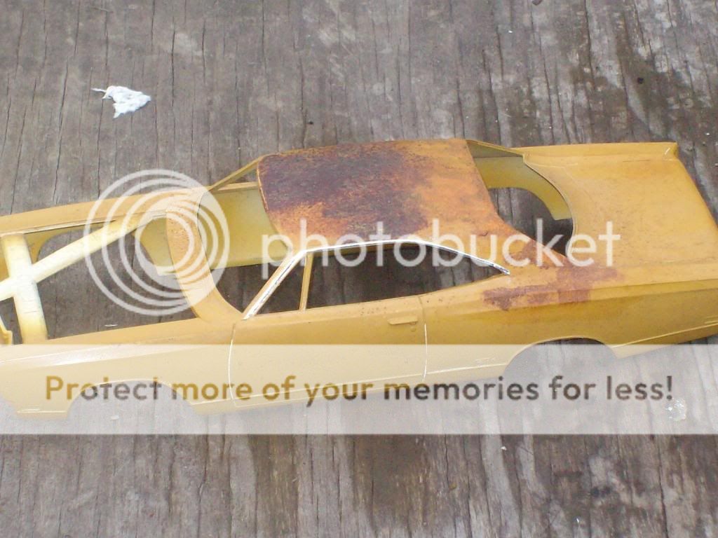

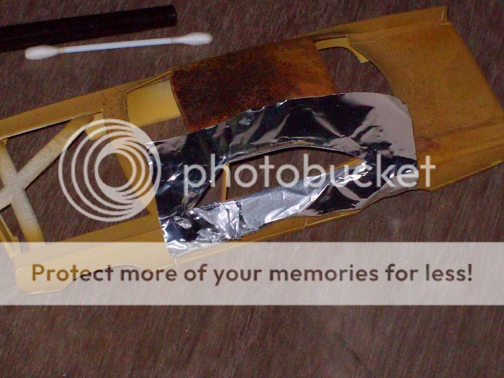

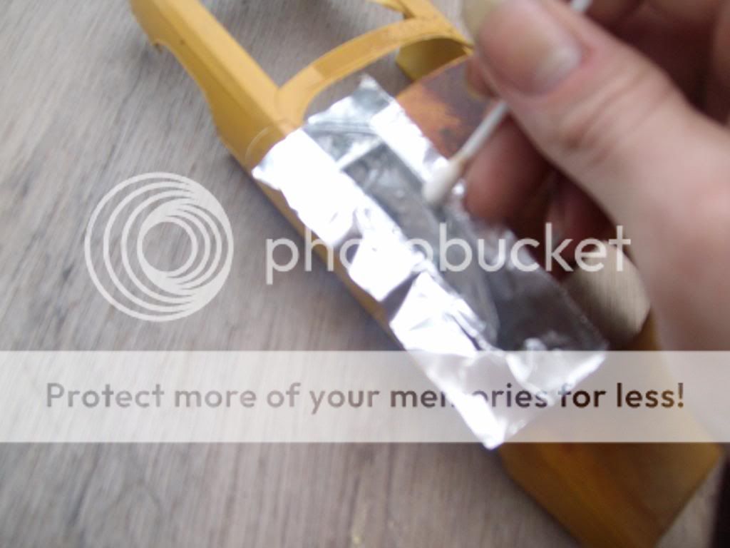

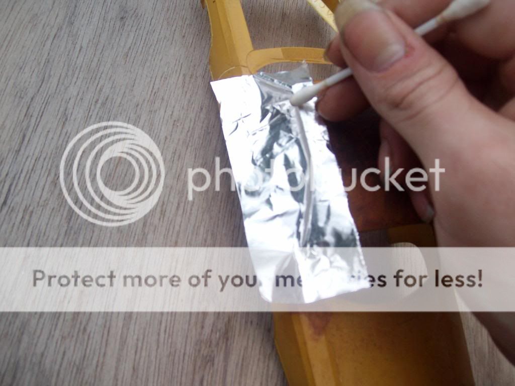

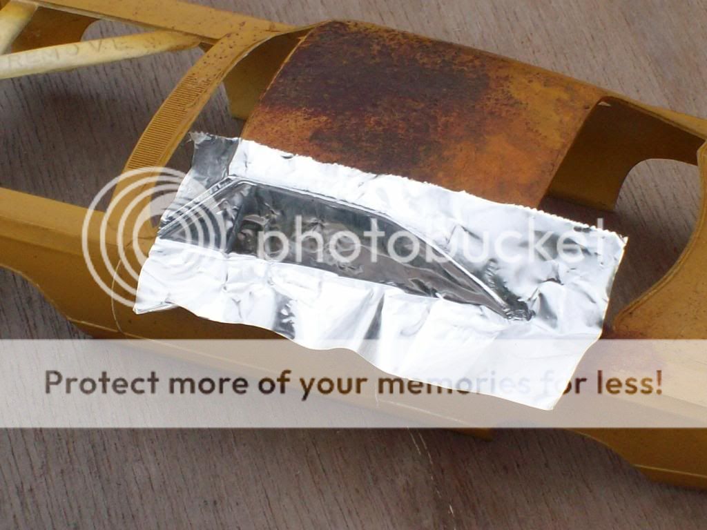

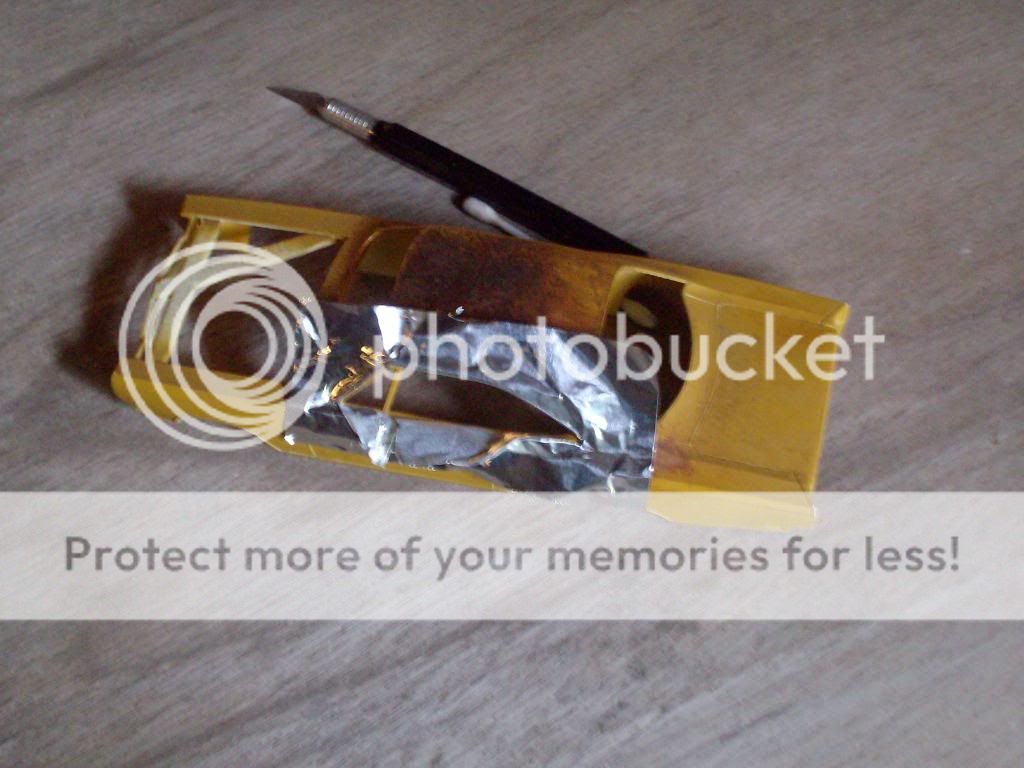

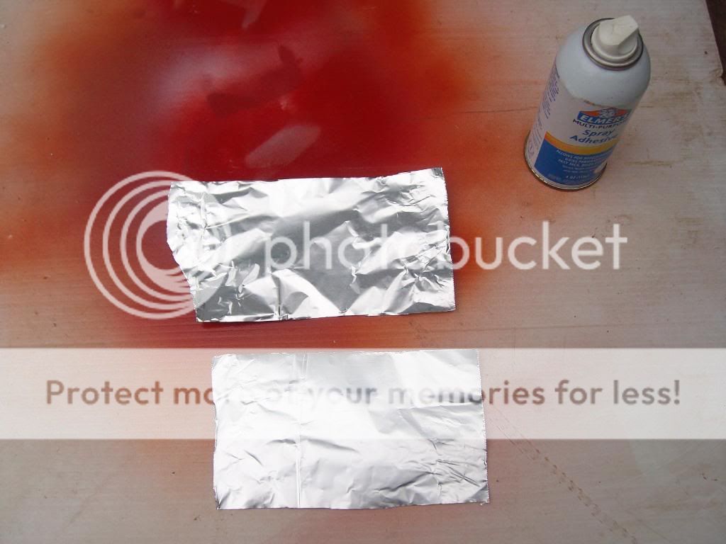

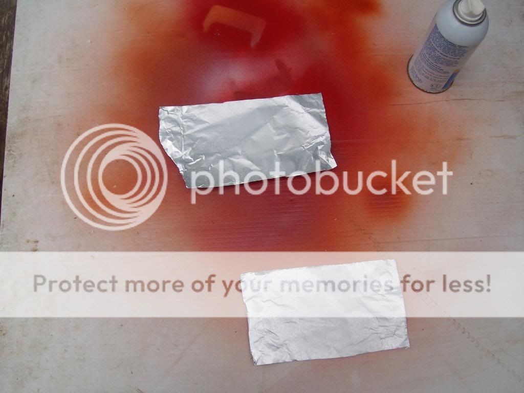

MoparWoman Jamie Posted August 25, 2010 Posted August 25, 2010 Hi you all, I thought I would add a trick of mine today here to show you where I get my BMF at. In case some of you all couldn't find real model car bare metal foil(BMF) or didn't like how it looks.. with this tip of mine you can make your own and in two styles. The shiny stuff or the dull looking stuff very easy. All you need is a flat area to work in, some new papers. The tools: sisors, alumium foil, emlers spray glue, a q-tip, a axcto knife with a #11 blade, and your model shell or what ever your foiling. (I'm using an old shell of mine that I'm working on weathering) Now I cut two (2) pieces of alumium foil. One is the dull side and the other is the shiny side. Before I sprayed them After I sprayed them. Now here is the thing, if your building a junker model and want the chrome to look dull spray the glue on the shiny of the foil. Now if your doing a street model or daily driver model and you want the foil to have that chrome look, spray the dull side with glue. Now the down side is that after so long after you spray the foil and if you don't use it in like say 6 minutes, the tackness kinda some what fades but all you do is just it another spray of the glue and wam your back in business again. But it all depends on you and the waiting time for the spray and it tackyness to set up. I mean if you just spray it and jump to using it you could end up having some glue reisdue on your finish from the excess foil that you cut away. I mostly wait around 1 to 3 minutes before using as for me it gives the foil and glue a good bite grip to the foil area and it sticks well for me. Anways, back to foiling here. Now after I sprayed the foil down and waited alittle time here I am with the first cut piece getting ready to fix it to the junk shell that I am only using to show you all how to make your own BMF. The shell is rough but to show the trick it is good enough for the job to show you how to do it. Now after I applied the foil to the area with my finger and got it rub in place enough to start working it on. Just remember this shell is rough, show I'm just using it as show how to tool. Now after you get the foil in place and all worked out in the areas, you can then start to trim away the excess with the xacto knife and #11 blade. But I want to add here the work isn't over yet with the q-tip. Because after you trim the excess away you can go back and varnish the foil down with the q-tip or your finger.. You decide. But there is more to this tut that will be posted in afew minutes here.

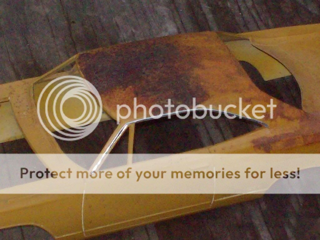

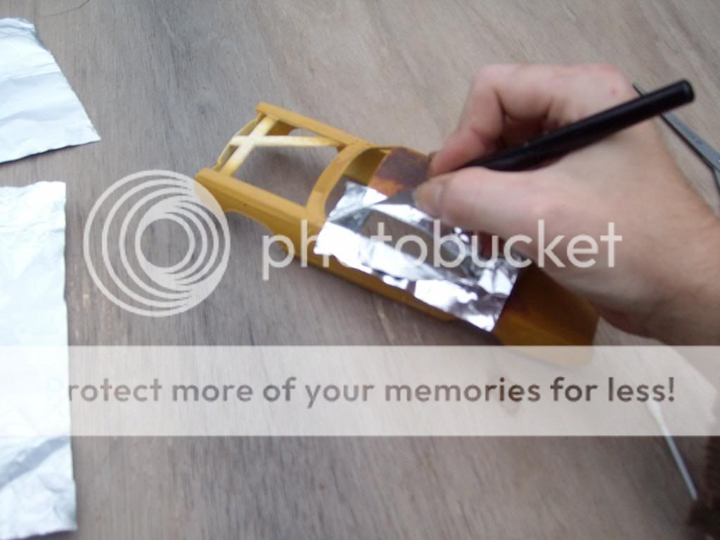

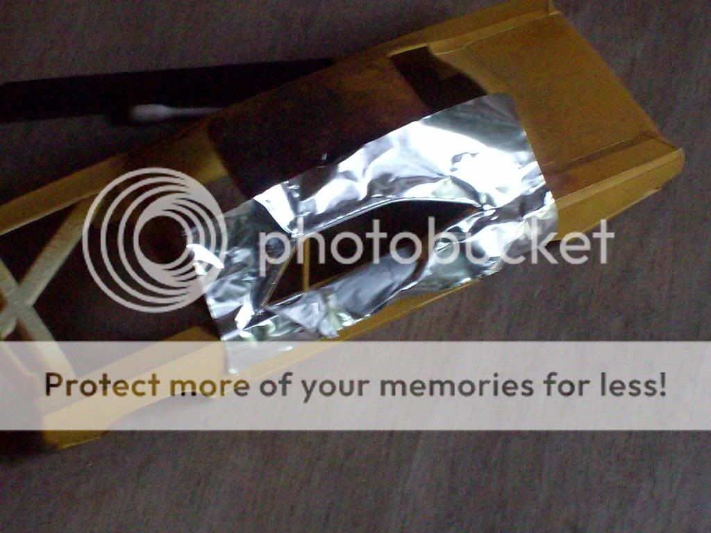

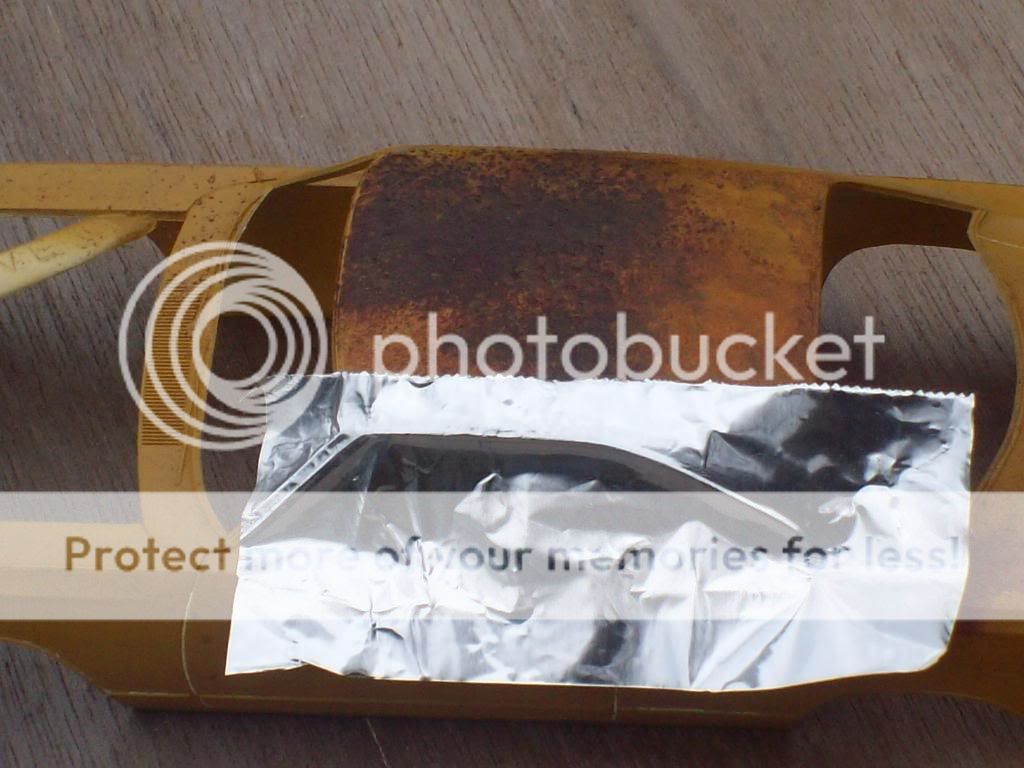

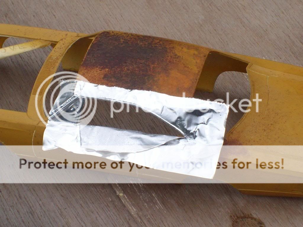

MoparWoman Jamie Posted August 25, 2010 Author Posted August 25, 2010 Okay, here I am trying to show how to trim and hold the camera at the same time LOL. had to move the shell to get the camera to focus more right on it and was still yet having some focus issues. Here is is with the excess all removed. Now here is where I went back and redid the foiling stuff indoors due to the camera having focus issues out door. This is the shinny side of the foil. I think the reason I was having focus issues with the camera was due to the how the alumium foil hits the lense during the photo taken as it's like a mirror with the flash.. because when I pull way way back from the model the photos comes out good. But I wanted to share my own way of making my own kind of BMF that I use all the time on my projects. Oh knows maybe this tut will help some of you out that can't find the model bare metal foil or can't get the stuff to stick good enough. I know ran into the kind that didn't want to stick at all and that was when I started to make my own. LOL
