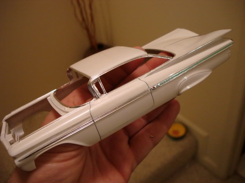

cruz Posted September 16, 2010 Posted September 16, 2010 If you want it to be pearl white, it has to be over a white primer or white base. I did this '59 over white primer.... Hosted on Fotki

slapshot Posted September 17, 2010 Posted September 17, 2010 (edited) Regardless of the subject matter of this post you just cannot post a picture of that Impala and not expect a comment. If there was ever a Pearl that beauty is surely it. Edited September 17, 2010 by slapshot

High octane Posted September 17, 2010 Posted September 17, 2010 If you want it to be pearl white, it has to be over a white primer or white base. I did this '59 over white primer.... Hosted on Fotki Marcos, That '59 Chevy is just plain AWESOME! And that's what I was told in the past is to shoot the white pearl over a white primer. I have never tried it as yet but I plan too.
slant6 Posted September 17, 2010 Author Posted September 17, 2010 That should do it. Thanks for all the help! Ill experiment a little, then give it a shot. Oh, excellent looking Impala BTW!

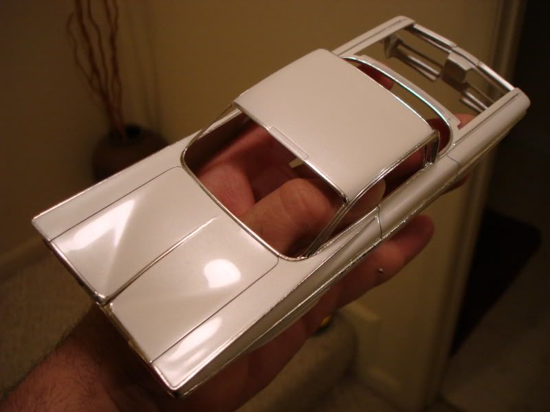

Bernard Kron Posted September 25, 2010 Posted September 25, 2010 (edited) I just saw this thread and by happy coincidence I shot some Tamiya Pearl White TS-45 over Duplicolor Wimbledon White this afternoon. The primer is Plasti-kote White Primer and there are two coats of Krylon clear over the whole deal. The TS-45 adds a bluish white cast to the warm cream white color of Wimbledon White. However, the Wimbledon White seems to mute the pearlescent effect a bit vs. shooting over a bright white primer. The paint has to cure some before I polish it. I'm hoping the added gloss will bring back some more pearl effect. Here's a picture which reproduces the overall color fairly well: Edited September 25, 2010 by gbk1
