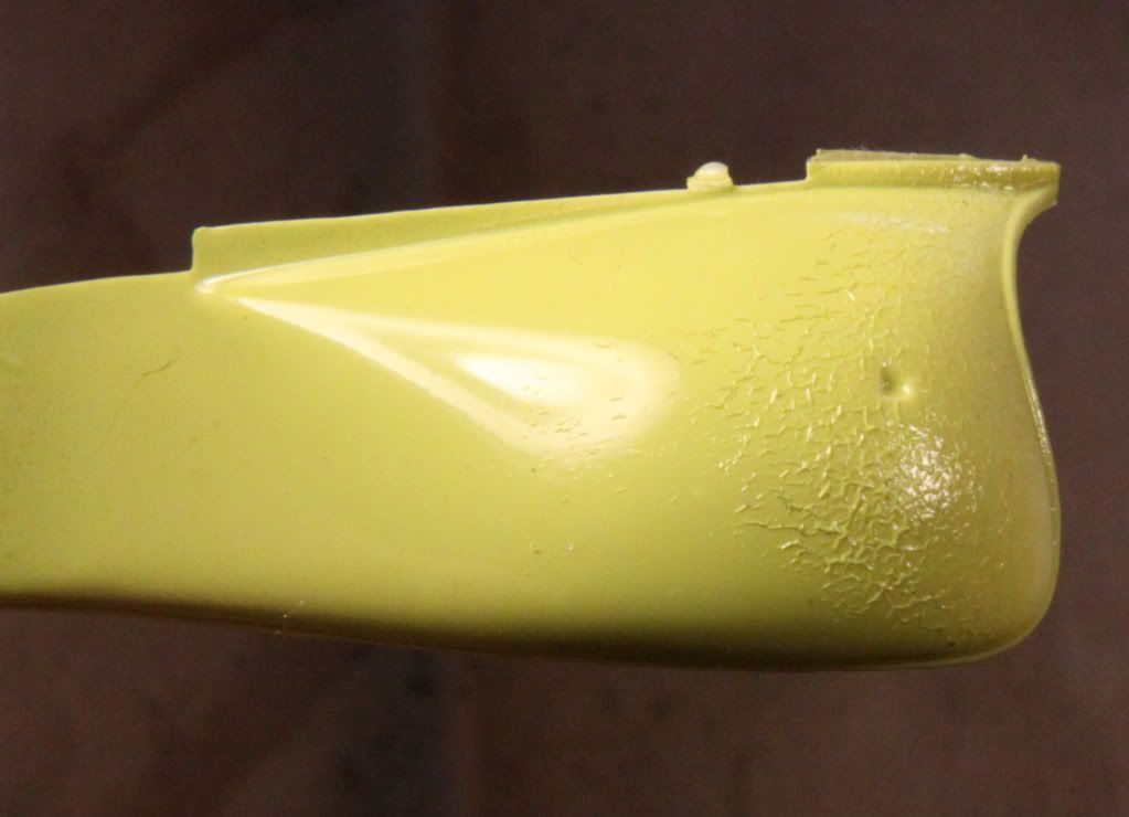

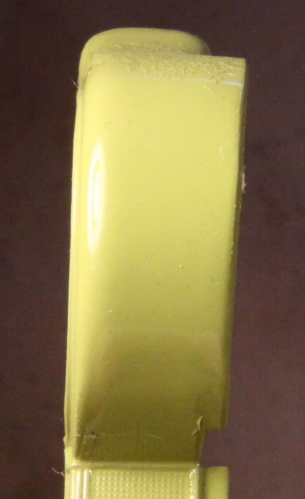

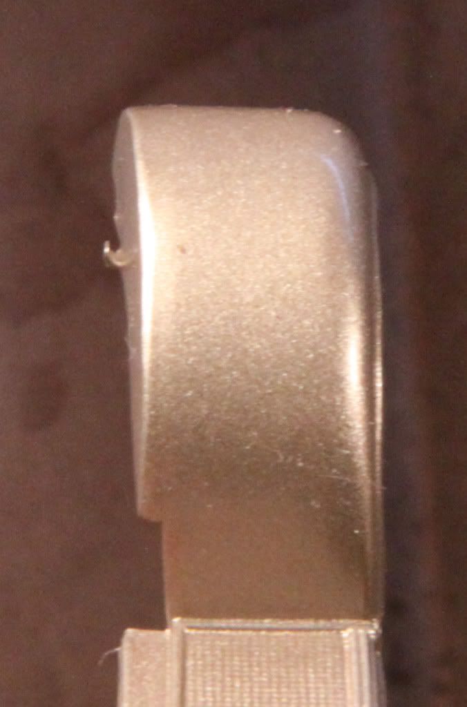

Erik Smith Posted February 8, 2011 Posted February 8, 2011 (edited) I have been experimenting with some different paints, including Krylon. It is definitely a bargain compared to hobby shop paints as I can get the large 12oz can for $4. Hobby paints are $4 to $6 and only have about 3oz. So... I purchased some Krylon Crytal Clear (from the hardware section), Krylon Fusion flat black, Krylon indoor/outdoor semi flat black and ivy leaf, and DupliColor Light Champagne Metallic. The Duplicolor is a Acrylic Laqcuer, the Crystal Clear says "Acrylic" on the can, and the rest I don't know. Here are the paints: Edited February 8, 2011 by Coyotehybrids
Erik Smith Posted February 8, 2011 Posted February 8, 2011 ...and the result: None of the paints harmed the plastic. I primed half with PlastiKote and left half bare plastic. No adverse reaction to any of the above paints. But... I tried the Crystal Clear and... it did this to the Ivy Leaf Krylon Paint. It was odd and sporadic, though, as not all the paint wrinkled: Crystal Clear worked great on the Duplicolor: I will keep trying out different combos. As a note, I also applied some Crystal Clear over some airbrushed Tamiya Acrylic and it worked really great. I sprayed it over a flat paint and was able (after a week of drying) to sand and polish it (aggressively, too) to a very fine shine. It was actually to tough for the project (old Ford) as I was trying to sand back down through the paint layers and I had to really put it to the clear to sand through. Hope this info helps!
