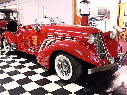

nts Posted October 17, 2010 Posted October 17, 2010 Long time since i was active on this forum, this is what i been doing since last time. Torgny
Terry Jessee Posted October 17, 2010 Posted October 17, 2010 Holy cow! Is that the Lindberg kit? That's beautiful. What wheels are those? Terry
Peter Lombardo Posted October 17, 2010 Posted October 17, 2010 This is a beautiful build of a very difficult kit. Just stunning. I am very impressed.
jas1957 Posted October 17, 2010 Posted October 17, 2010 Awful kit, great job. We need details as to what you did.
Foxer Posted October 17, 2010 Posted October 17, 2010 Thats one great build! I like it in red ... beautiful job on that one!
sjordan2 Posted October 17, 2010 Posted October 17, 2010 If that's the Lindberg kit, it's essentially the original Pyro except with chrome-plated parts. Outstanding work, with a 6.0 degree of difficulty.
Railfreak78 Posted October 17, 2010 Posted October 17, 2010 This is one of my all time favorite classics and you did a Great job on it!
Harry P. Posted October 17, 2010 Posted October 17, 2010 Unusual color for this car, but very nicely done. She's a beauty!
sjordan2 Posted October 17, 2010 Posted October 17, 2010 (edited) The color works for me, and I saw a 2-tone red version with red wire wheels. The biggest visual issues with this kit are the windshield frame, which is quite a bit off, the tread plate for entering the car is twice as deep as it should be and the grille doesn't curve quite enough. But this is the best build I've ever seen of this kit. My biggest question is how did you get the hood to sit properly??? Edited October 17, 2010 by sjordan2
charlie8575 Posted October 17, 2010 Posted October 17, 2010 Very nicely done. I must also join the questions- how did you build that kit if it is indeed the Pyro/Lindberg and get it to come out so well? Charlie Larkin
nts Posted October 18, 2010 Author Posted October 18, 2010 Yes you are right! It is the Lindberg/Pyro kit, but the rims are white metal aftermarket with tires that looks autentic for this car. There is a lot to wish with the kit (as you all know)but i dident change too many things ,the focus was to make it look nice over all and with a nice paintjob you are half way.So its not a perfect scalemodel....but its a very satisfactory build. Here is a link to the build on my swedish forum, if you make av translation on the computer you kan read the lines under the fotos,think there are 5 pages. http://scaleracers.inventforum.com/viewtopic.php?t=7387 / Torgny
nts Posted October 18, 2010 Author Posted October 18, 2010 The color works for me, and I saw a 2-tone red version with red wire wheels. The biggest visual issues with this kit are the windshield frame, which is quite a bit off, the tread plate for entering the car is twice as deep as it should be and the grille doesn't curve quite enough. But this is the best build I've ever seen of this kit. My biggest question is how did you get the hood to sit properly??? Hallo Skip ! The hood was a pain in the a....the constuction give you hope for a hood that opens...BUT it never going to work as it is, i cut off the left part of the hood so it is very thin,so the right part can slide under the left one when you lift it, even the hinges that hold the right side must be adjusted to make it work.I cant describe all the words i used when this job was done Torgny
