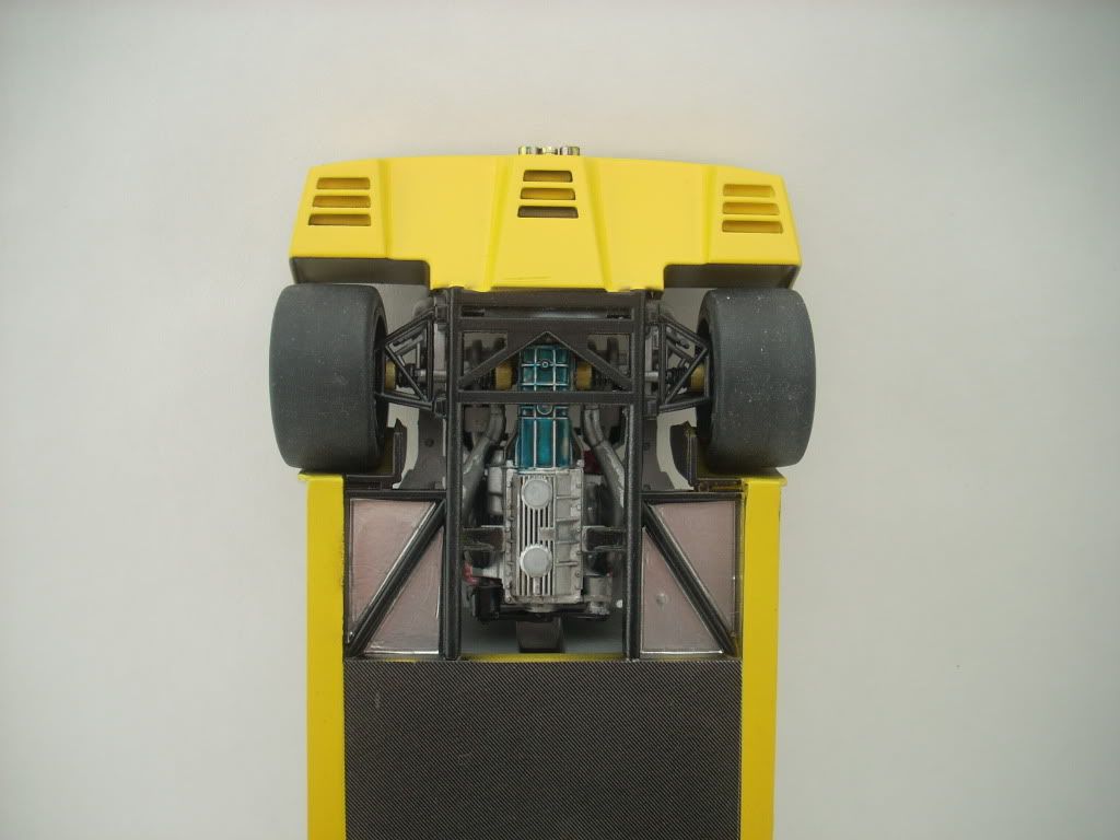

Chillyb1 Posted November 2, 2010 Posted November 2, 2010 Here's what it looks like on a model: Its uses for modeling purposes are limited. It is much thicker than BMF (or its homemade equivalents) and that thickness is visible. It is very difficult to cut, so many very sharp blades, and a surgeon's steady hands, are necessary. I don't think it is as aggressive adhesive-wise as the other posters have claimed. When I was experimenting with it a couple of years ago, I never had a problem with it lifting any paint (I was using enamels and lacquers, so I can't say what it might do to acrylics). And when you remove failed attempts or excess tape, the adhesive lifts with the tape and does not leave any mark or residue on the paint. There are types of automotive brightwork that are notably, visibly thicker than scripts and other trim bits. This aluminum tape is, I think, best suited to windshield and rear window surrounds and some rocker panels. I don't really us it very much, but because I have several hundred yards of the stuff I still look for the occasional suitable application of it. It may not be very easy to see in this photo, but the bumpers and the side/rocker trim on this Porsche are aluminum tape: The trim on these VW running boards are also done in aluminum tape: And, just for kicks, I used the stuff on the underside of this Ferrari F40:
