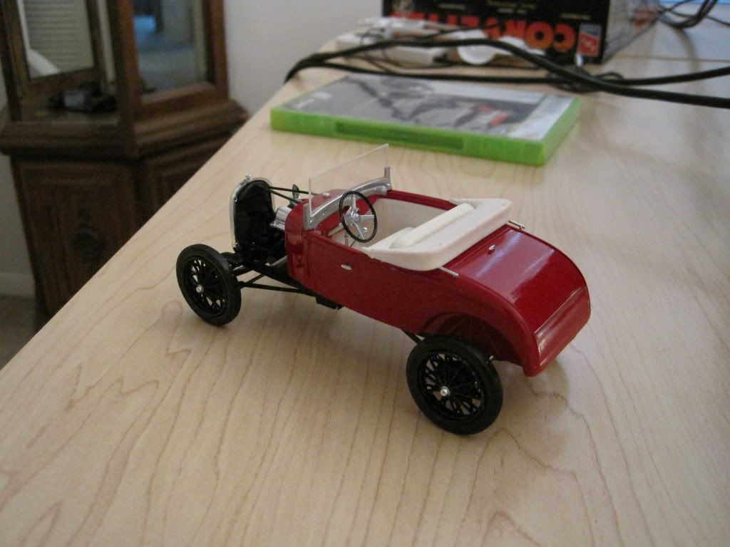

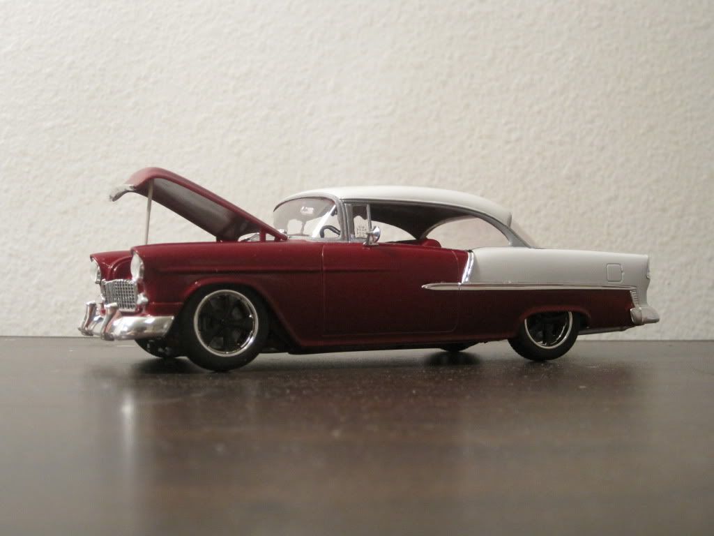

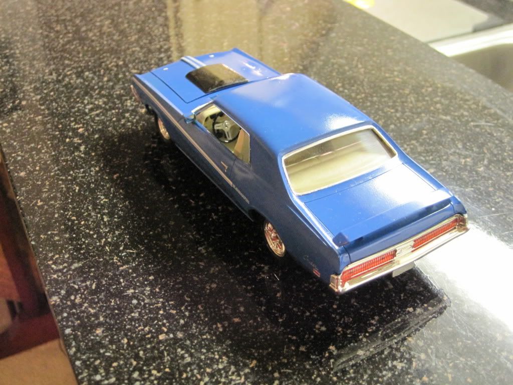

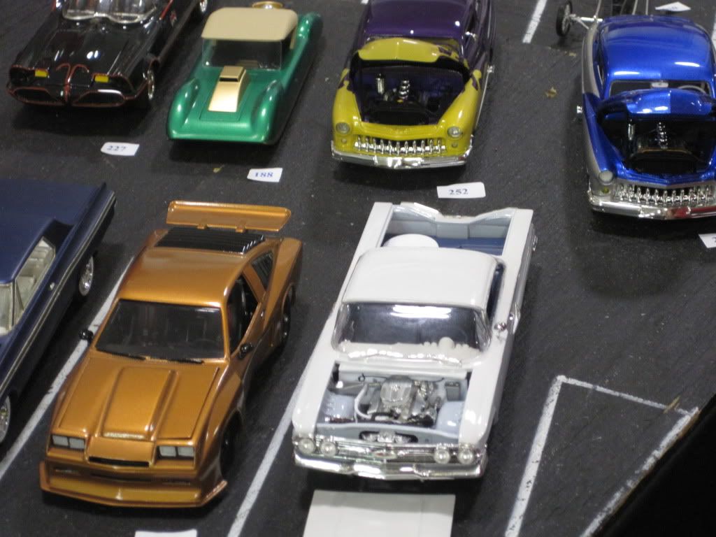

tiltawhirl Posted November 3, 2010 Posted November 3, 2010 (edited) Thank you for your help kind sir. Im also curious if different clear coat kinds may be too hot for some paints, for example lacquer clear over enamel base coat? and when it comes to different brands, what would you suggest? how are the tamiya and testors clear coats? whats the best bang for your buck? no u cant spary lacquer over enamel but u can put enamel over lacquer. and to brands tamiya in not a high gloss u will have a wet sand and polish it 2 a high shine. testors is the cheapest and if i remember right it high gloss clear i still wet sand and polish it,theres dupli-colors 3 step paint,primer,base coat and clear coat that u can get at autozone its like 6 buck a can but they have more colors and u can do like 2 cars with one can theres rustoleum enamel paints and krylon that u can get at wal-mart or home depot its like 4 buck 4 a 12.oz can examples testors enamel base and clear coat(3 bucks a can) krylon lacquer base and clear coat(4 bucks a 12.oz can) rustolem base and clear(4 bucks a 12.oz can) automotive paints base and 2 part clear coat this was can cost at of money this car have about 200 buck with of paint and clear on it (white 60' impala in the pic) Edited November 3, 2010 by tiltawhirl
