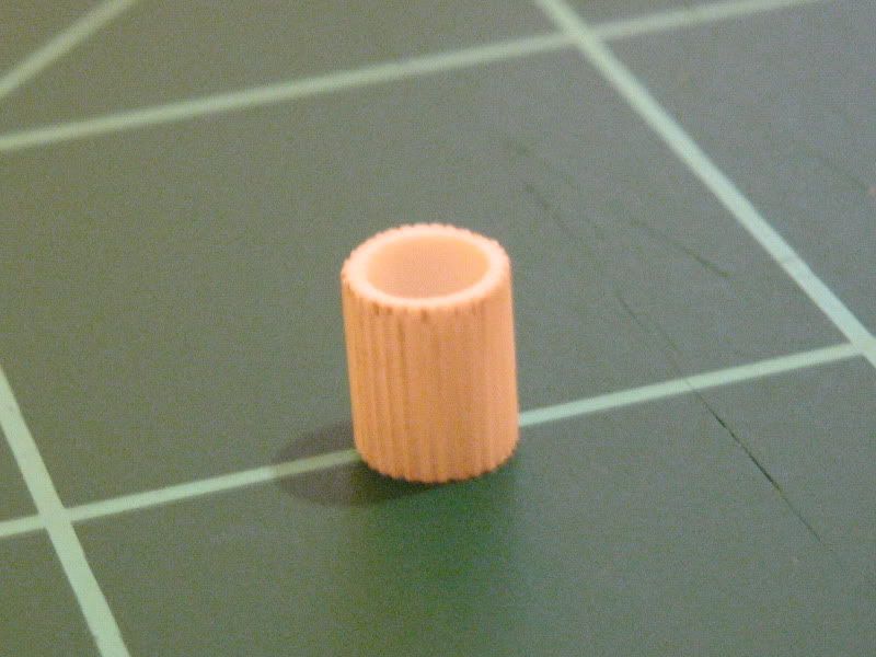

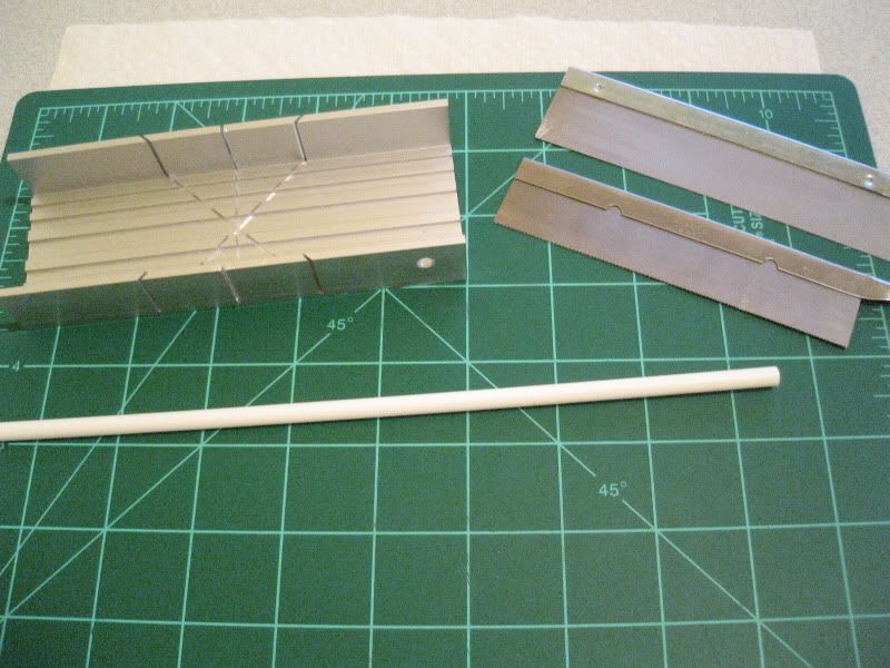

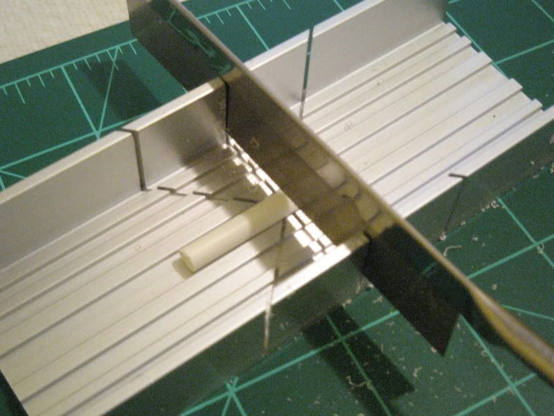

shucky Posted November 2, 2010 Posted November 2, 2010 Using that ribbed styrene for building an intercooler is also what I did before. Works really well. If you have a small miter box and the saw blades that go with them (like the xacto ones) you can make a pretty convincing air filter element using large styrene rod. Take a section of the round styrene (diameter of your choice) and place in the miter box. Now take a course toothed saw blade and slip it in your miter box in the center position (for making straight cuts). What you'll be doing here is placing the saw on the styrene rod and dragging the rod along the saw blade. This cuts "v" shaped grooves in the styrene rod. After your happy with a section, rotate the styrene and continue the process until you cut grooves in the rod all the way around. Now slice a section of the rod off in the length of the air filter element your application requires. You can make a simple cap for the filter using misc. styrene and also a hose coupling on the other end using a small section of aluminum tubing. For the filter, you can then paint and detail it however you wish. I'm at work otherwise I'd post a couple ref. pics for ya. Hope that helps!

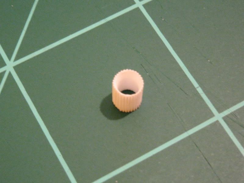

shucky Posted November 2, 2010 Posted November 2, 2010 (edited) Thanks Dave I mainly started experimenting because I wasn't very pleased with kit and after market air filters. Here are some pics of the process I described above. You dont need to use the miter box but it does help keep the lines your cutting into the rod straight. The example piece is kinda small in diameter but this was only for demonstration. Also, the other styrene type is just some misc. pieces I had laying around but you can easily see how some styrene bits can be mocked up into a convincing air filter. The one where the rod is pulled along the saw blade works and is fairly convincing, but my "go to" filter <my preference> is the one made up of styrene rod, with styrene top and bottom caps (punched from flat sheet styrene), and an aluminum section at the base which is the part that slips onto your intake tube or directly onto the turbo. The pics (I hope) will help explain this. Here is whats needed: Pulling or dragging the rod of your diameter choice along the saw blade: The result trimmed from the original rod: You can see you basically cut small teeth or pleats into the rod. A top and bottom cap (round disc) + some detail painting and you have a very convincing open element air filter. Here my top and bottom caps are not the correct diameter, I just grabbed some on my desk but I think you get the idea. The mock up filter on the right is what I'll talk about next. The "mesh" and misc: Edited November 2, 2010 by shucky

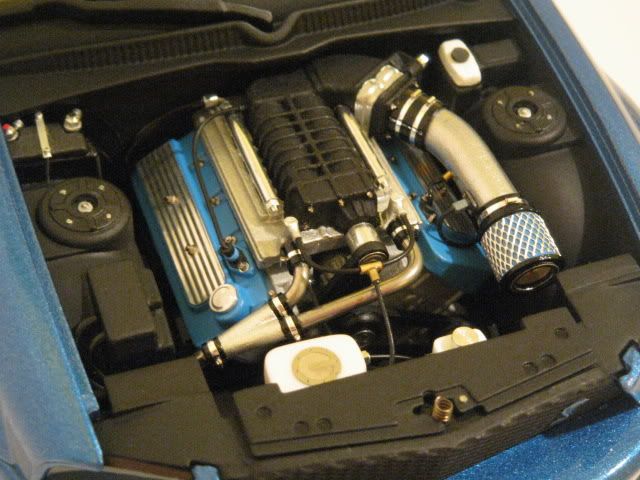

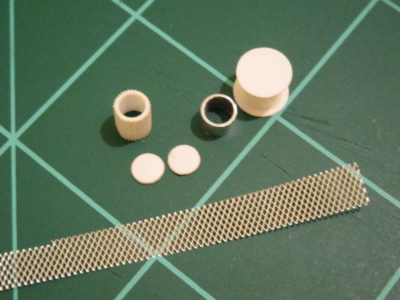

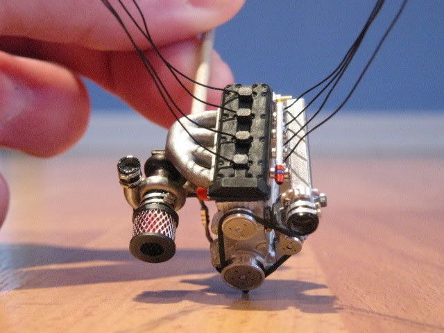

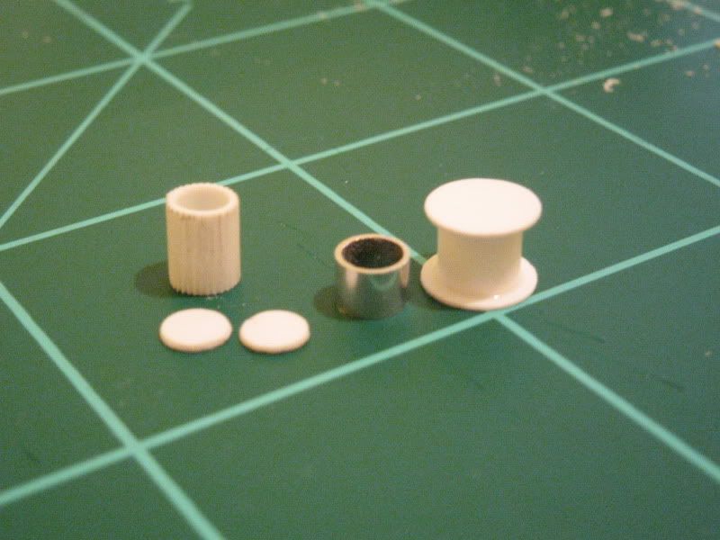

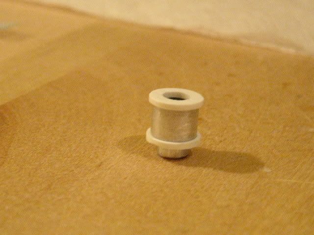

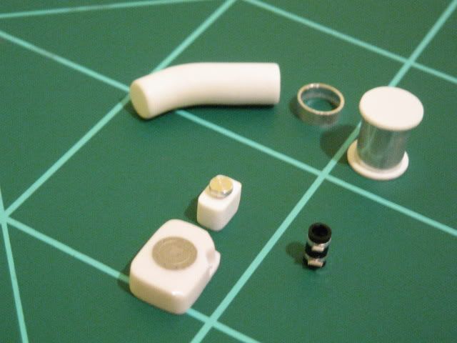

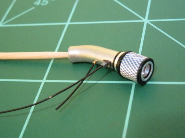

shucky Posted November 2, 2010 Posted November 2, 2010 (edited) These are the filters I've been using lately. Styrene or aluminum tube or rod (your choice), top and bottom cap, aluminum tubing base, and added aluminum mesh for the filter screen. Turbo VW 1.8T : Open element filter on GT500 : You can see what I used on these, a mix of aluminum and styrene along with the mesh (railroad aisle). On the right are the intake tube, aluminum "filter" body, aluminum "filter" coupling, styrene top and bottom filter caps: You can see the filter mocked in this pic (upper right): In this pic, the filter is nearly done. The "coupling" on the bottom is aluminum (painted black) with a strip of BMF to act as a hose clamp. Since I was detailing the inside of the filter as well, as some open element units have an open cap and air venturi inside I replicated that detail by using a "silver beading cone" from Hobby Lobby (beading aisle) which was cut down to fit inside of the "filter body." The trim ring is punched from .005 aluminum and gets placed on the top "cap" which was styrene (painted black). Hope some of this helps! Any questions feel free to ask. Edited November 2, 2010 by shucky
