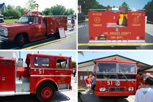

highway Posted November 11, 2010 Posted November 11, 2010 I have what I think may be Ford dually wheels that are pretty close to these. Yep, DW, you are right, the wheels in the Ford dually are a match to the the ones on Squad 51. The real wheels, as well as the kits, are a Budd 4 hole wheel. While I don't have a pic of the wheels from the kit, the kit has the same wheels as my 1:1 dually, with the exception of the four wheel drive hub on my 1:1. The kit wheels have the correct grease cap for the two wheel drive like in the Squad 51 1:1 pic. I'll definitely be watching this, it is still one of my favorite TV shows. I still watch it now, a TV station here runs it every night at 10 PM on their Retro station.

dwc43 Posted December 7, 2010 Posted December 7, 2010 (edited) hey i have been working on finding everything to build one for my dad. have you found the running boards or the lights for top. where did you get the truck cab and utility box You can use any cab from the Little Red Express truck or an 70's Dodge truck. The LRE truck does not have the correct hood. IT has the '80 and up hood. You need the '72 to ;79 hood that has the depressions in it. Get the grill and wheels from Dencon. http://www.denconresin.com/wheels.html http://www.denconresin.com/part.html Get the ute box from these guys. Number 98. The whole kit is $99 but if you e mail them, they will sell just the box. http://ssbresins.com/new-parts.php Decals from J Bot. http://www.jbot.ca/cars/ems/squad51.shtml Then you have everything you need. Edited December 7, 2010 by dwc43

dwc43 Posted December 7, 2010 Posted December 7, 2010 Dave it has the right hood, I know I have 3 of them for some projects that I'll get to eventually. I can crack one open and take a pic if need be. Look at post 11 I made. It has to have the hood with the two depressions or scallops in it. The LRE does not have that hood. IT has the 80's up hood that is flat other than the body line down the middle and on each side. To make the Squad 51 truck you need the '72 to '79 hood with the two depressions or scallops that face each fender.
Rob Hall Posted December 7, 2010 Posted December 7, 2010 (edited) Look at post 11 I made. It has to have the hood with the two depressions or scallops in it. The LRE does not have that hood. IT has the 80's up hood that is flat other than the body line down the middle and on each side. To make the Squad 51 truck you need the '72 to '79 hood with the two depressions or scallops that face each fender. Interesting..the MPC/AMT LRE kits I have are '78s and have the '72-78 hood w/ the depressions. MPC did make later 4x4 '79-80 style Dodge pickups w/ the '79-80 hood (w/o depressions). (The picture in post #9 shows a red hood that looks like the MPC LRE hood..the original issue of that kit was molded in red). Edited December 7, 2010 by Rob Hall

dwc43 Posted December 7, 2010 Posted December 7, 2010 Interesting..the MPC/AMT LRE kits I have are '78s and have the '72-78 hood w/ the depressions. MPC did make later 4x4 '79-80 style Dodge pickups w/ the '79-80 hood (w/o depressions). (The picture in post #9 shows a red hood that looks like the MPC LRE hood..the original issue of that kit was molded in red). Well, don't know how that happened then. I just dug mine back out and it has the wrong hood in it, but, the pic on the box does have the correct hood on it. Oh well, I'll change it when I get to the point I want to finish it up. Since I found all the parts now, I need to buy them up so I can do this project too.
