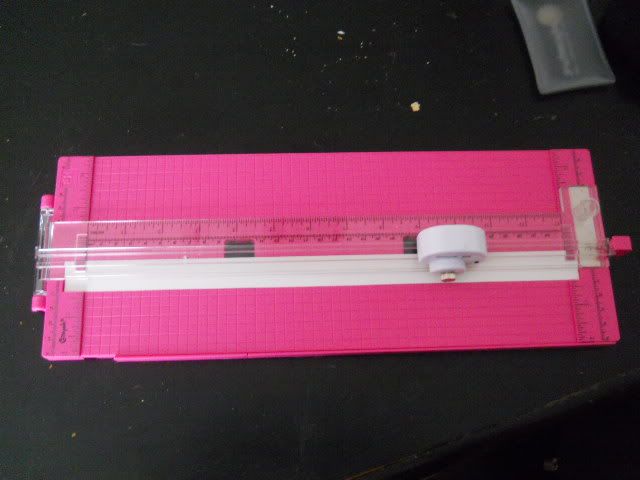

Lownslow Posted January 6, 2011 Posted January 6, 2011 when you filed the edge did you file the blade flat? or at an angle?
Darren B Posted January 6, 2011 Author Posted January 6, 2011 (edited) when you filed the edge did you file the blade flat? or at an angle? I dont know how Eric did his, for mine I filed it back and forth flat across the top of the blade itself. I do not think it matters as long as you just take the edge off the blade. Edited January 6, 2011 by Darren B

Darren B Posted January 7, 2011 Author Posted January 7, 2011 i did the same it doesnt cut but it also doesnt look tucked like tingos NVM figured it out i have to do 2 two slides I should have mentioned that, it can take several slides back and forth and a lot of pressure pushing down on the blade holder , but thats for the one i bought as I went with the cheapest cutter I could find.
Lownslow Posted January 7, 2011 Posted January 7, 2011 I should have mentioned that, it can take several slides back and forth and a lot of pressure pushing down on the blade holder , but thats for the one i bought as I went with the cheapest cutter I could find. i got the same one as yours i can tuck faster with the #11

Darren B Posted January 9, 2011 Author Posted January 9, 2011 (edited) Very nice tip. I just wonder, though, if the dents you make in the foam with the cutter wheel are permanent... or does the foam gradually spring back to shape and the lines disappear? I havent had the time to do more than just one sheet of foam on my cutter after seeing this done, I did a 2 in square sample about a year ago using the back of a number eleven blade and it still has the shape it in today. And you can probably use the back of a blade or some other long metal object like a steel or aluminum ruler but the cutter helps make the lines straight with each other. Edited January 9, 2011 by Darren B
Darren B Posted January 10, 2011 Author Posted January 10, 2011 (edited) Hey Darren, thanks for posting . I'm always o.k. with using my ideas. That's one of the reasons I post how I do things. One thing that has always made me laugh , in the real car world and models is when you ask someone how they did something , and they either shrug you off or tell you it's a secret. This usually means there not the one that did it. As for the lines lasting. I did my interior over a year ago and there is no difference in the tuft line depth. I also use 600 sand paper and lightly sand the edge of the foam once it is cut out to the pattern it's used in. To attach the foam I use CA glue , not to much , and once it's in place I drop a few drops of kicker around the edges . Then blow off the kicker with air tell the foam is dry. Not to much pressure , it could distort the foam. And yes I drilled a hole in every tuft corner for the buttons. This is why on the sight that I did the tutorial on I gave a warning not to do it unless you're completely nuts. Eric, thank you for being understanding, most people would have thought that I jacked their idea and been mad, thats why I made sure when I posted it that I said it wasnt my idea. I just fell in love with how you came up with making the lines and when I seen the full interior it blew me away how realistic it looks. I have been for years looking for a way to replicate this look. The other look that I am trying to replicate is the coffin pleat look. About 12 years ago I bought a yard of what was called velveteen in a material shop called jo anns fabric and it was paper thin and looked exactly like crushed velvet and I used that yard of material in a 81 chevy citation and it looked exactly like coffin pleat but when i went back a year ago they say its not made anymore, do you have any ideas what material to use to replicate that? Ill try some other shops in my area but the ones I went to show me material that is to thick to be scale. Heres a few pics of what I used to use for it and how it looked, not very close up shots as I didnt take pics till the models were built. Edited January 10, 2011 by Darren B

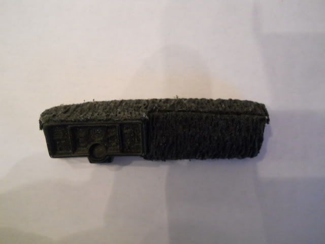

Darren B Posted January 27, 2011 Author Posted January 27, 2011 (edited) I have been playing around with medical gauze/tape for the coffin pleated look, here is a shot of it, the medical gauze/tape comes white but I sprayed this sample flat black. just glued it down to dash with liquid cement then painted after it was dry. Edited January 27, 2011 by Darren B
