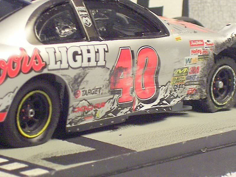

oldscool Posted February 8, 2011 Posted February 8, 2011 (edited) although not 100% correct, adjust the suspension to lower that one wheel, & then sand / or slice off the appropriate amount of tire to make it 'flat' OMG! you used one of those rare MPC Denman funny car tires for that! That is some very realistic looking rust though. oldscool Edited February 8, 2011 by oldscool
oldscool Posted February 10, 2011 Posted February 10, 2011 OMG! I only had one @ the time (about 6-7 years ago) & it fit the wheel I wanted to use perfectly. I probably shouldn't mention the other one that got torched & ruined while trying to accomplish this same look. Advice - be very careful with flames & rubber / vinyl tires.... Thank you on the rust. Maybe I came across as too serious. You are forgiven sir. That really is the best rust I have ever seen. grumpy gus
oldscool Posted February 10, 2011 Posted February 10, 2011 OMG! It's only a hobby. Oh I don't take the hobby that seriously. Just look at my builds . Maybe I used the wrong smiley. grumpy gus
