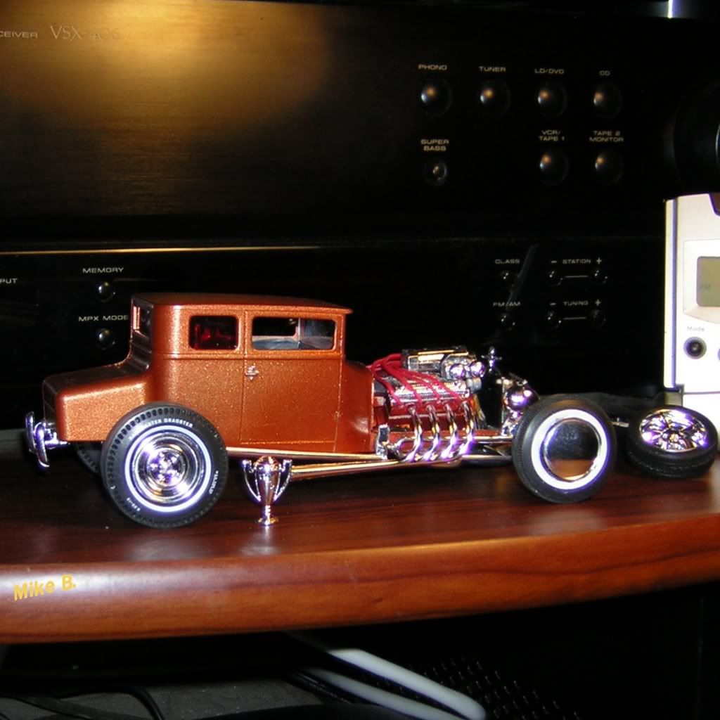

spad007 Posted March 7, 2011 Posted March 7, 2011 (edited) i just want to put a few plastic cars together with the grandkids, so , the age old question. lacquer or enamel? there seems to be about 2000 different kinds of paint at the hobby lobby. how about these 2 stage lacquers by modelmaster? I just spayed my "T" model chopped coupe Amt's 3 in one, (Rat Rod?) with Testors one coat Lacquer-1831M-Fiery Orange'the other day. it looks ok but i think it needs a clear coat. but to show kids how to paint with cans it's fast drying just the trick i would think.and not as stinky as enamel. cut up some card stock tape it up in to a model car body size/shape box use it to test and practice on. Edited March 7, 2011 by spad007
