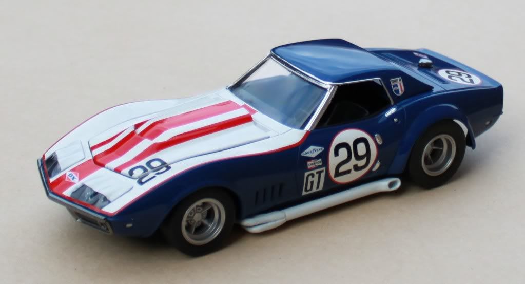

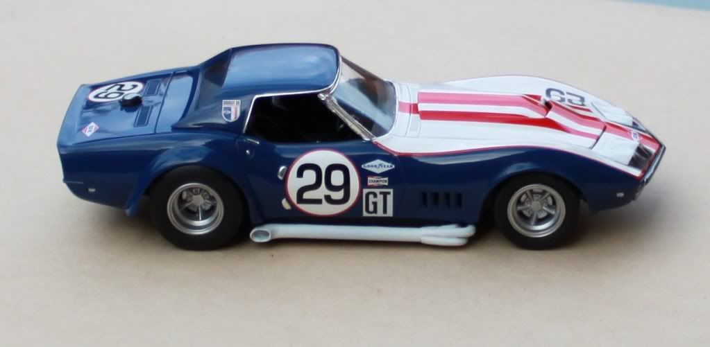

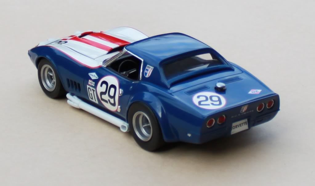

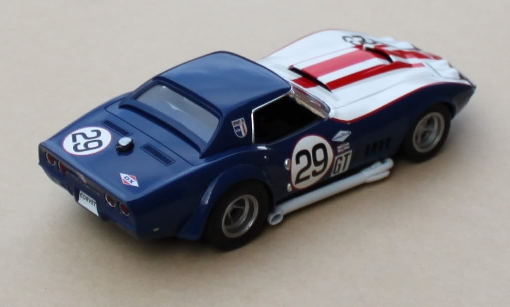

Dave B Posted March 10, 2011 Posted March 10, 2011 I bought this stock kit years ago because it was cheap & hadn't got around to building it. I later bought a'68 Sebring Greenwood kit and decided to build the 'stocker' first. I cast the wheels & tyres from moulds I already had and made the rear flares & clear headlight covers by vacforming over the 'Greenwood' bits. Then only had to make the head light buckets up & go through the parts box for suitable lights & side exhausts. The blue, white & red is all air brushed auto acrylic & I finished it of with VRM decals. Tks for looking Dave B

Chris C Posted March 12, 2011 Posted March 12, 2011 great build, especially like the wheels, those rears look tough as!

Jon Cole Posted March 13, 2011 Posted March 13, 2011 Amazing job on the Corvette. Would love some detail on how to do the headlight buckets... that is why I never built the Greenwood car.
Eric Stone Posted March 13, 2011 Posted March 13, 2011 (edited) I'm with Jon here. I lost interest in the Greenwood car when I saw the cheezy decals they had for the headlights, and found that the thickness of the covers didn't allow enough space under them to put headlight lenses and reflectors. I don't have a vacuform setup, so that's not an option... I wonder if there's any other way to do it..? Your Vette looks excellent. Edited March 13, 2011 by Eric Stone
Dave B Posted March 13, 2011 Author Posted March 13, 2011 Would love some detail on how to do the headlight buckets Sorry guys, for me it was easy as I have 2 small vac pumps. They are pumps that were used to pull down printers plates at the local newspaper. They won't do big jobs but are ideal for little bits & pieces. I just put some plasticine under the Greenwood styrene covers and pulled some clear PVC over them, they are slightly oversize but you can trim them down, they do the job. Dave B

pharr7226 Posted March 14, 2011 Posted March 14, 2011 Great work. The fender flares and paint are outstanding.

IMSANUT Posted November 5, 2012 Posted November 5, 2012 I'm curious, where did you find reference for the rear flairs. All the pictures I have been able to find on the net show stock wheel arches front and back. Same for the AIR Corvette team of James Garner.
