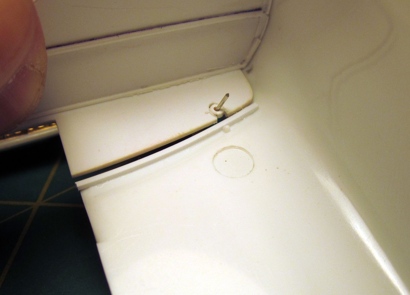

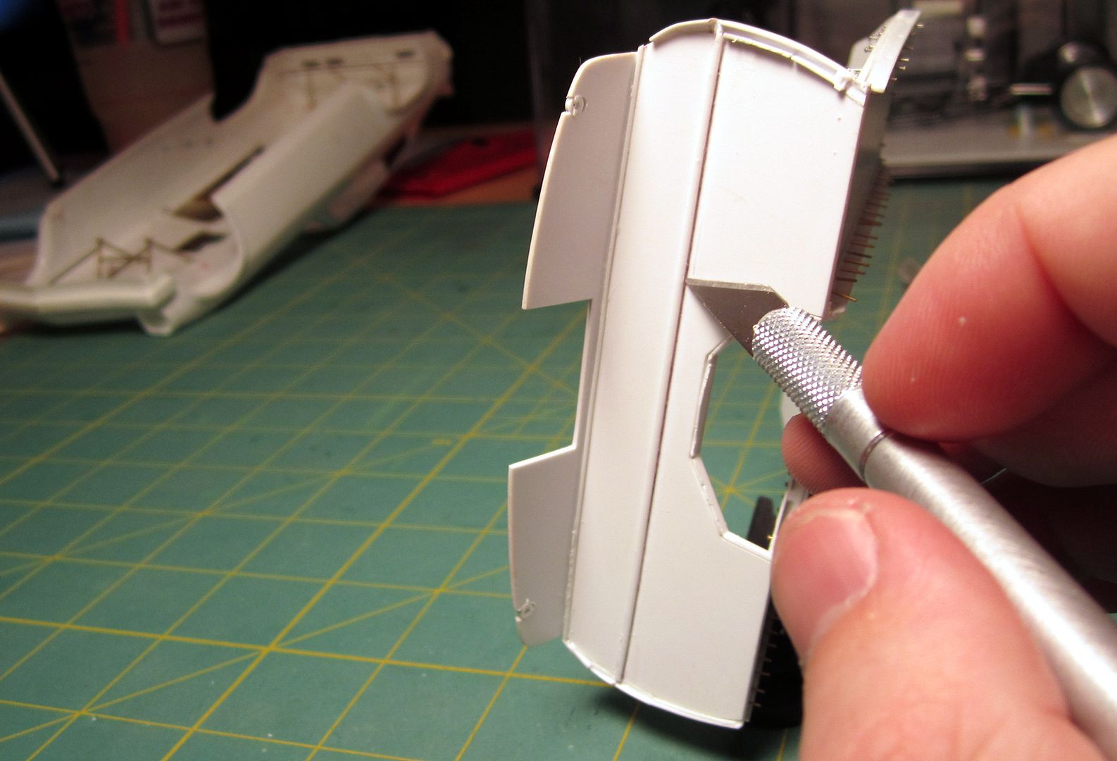

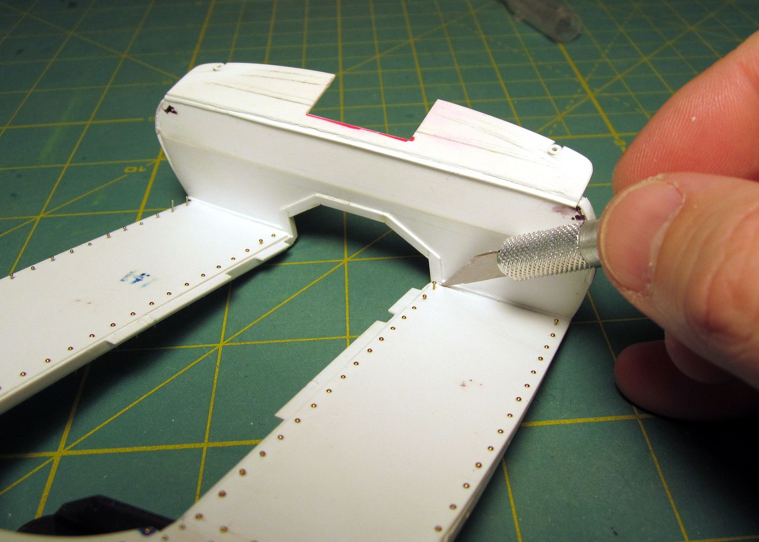

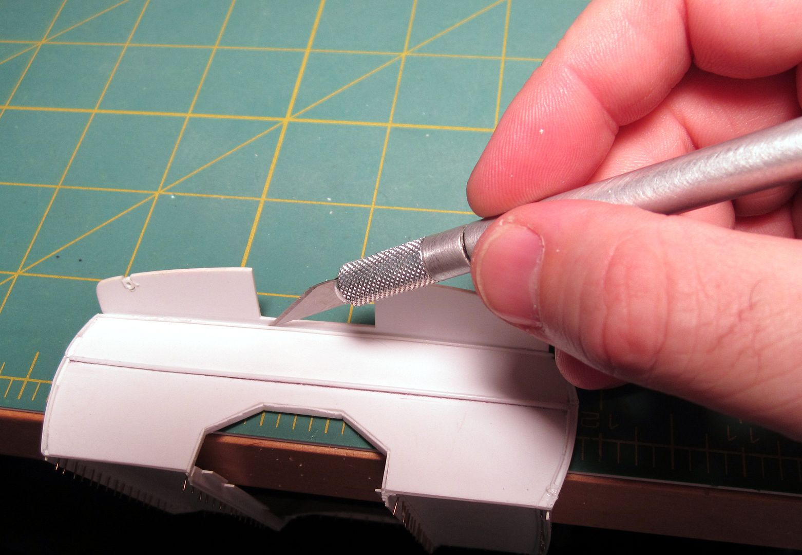

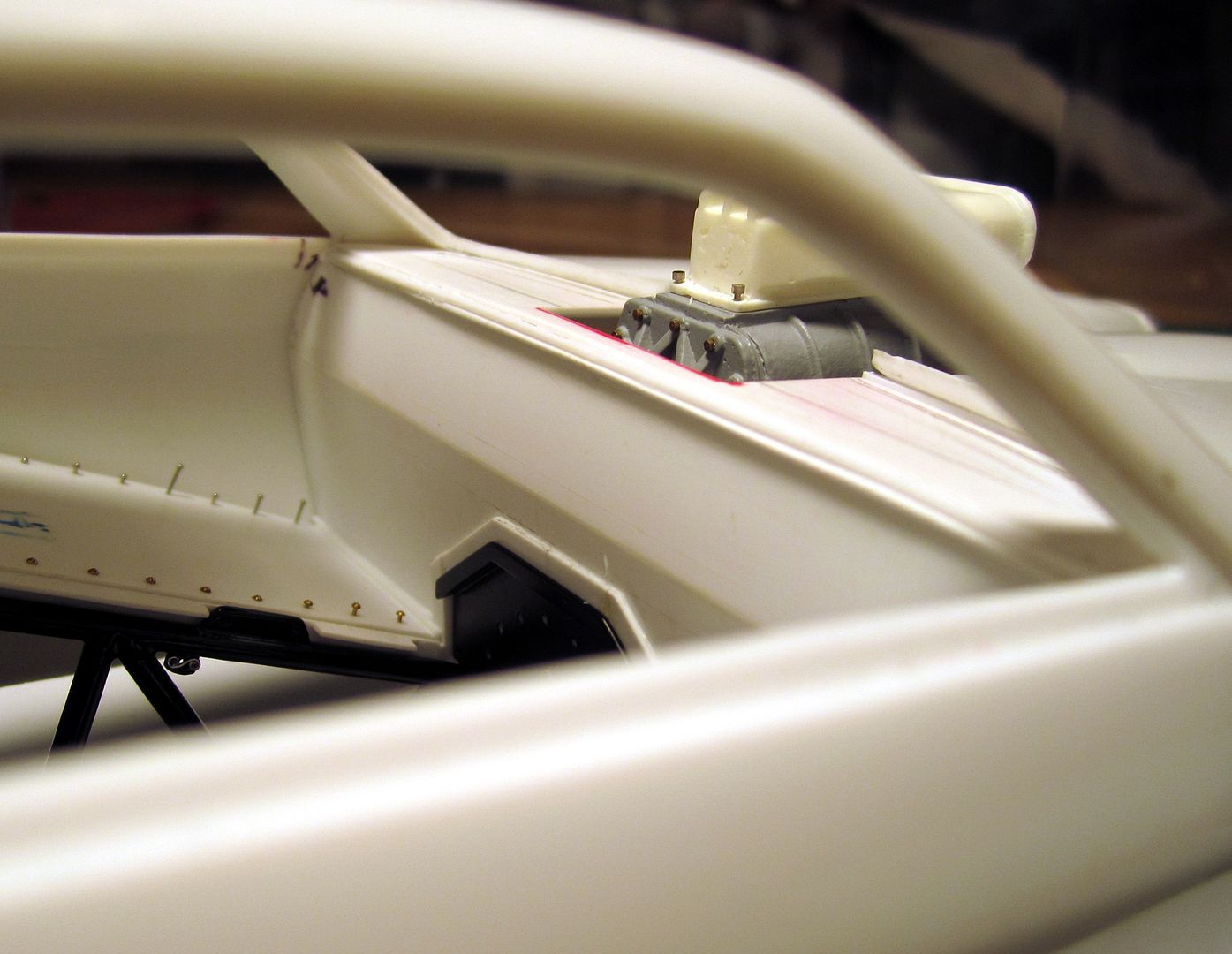

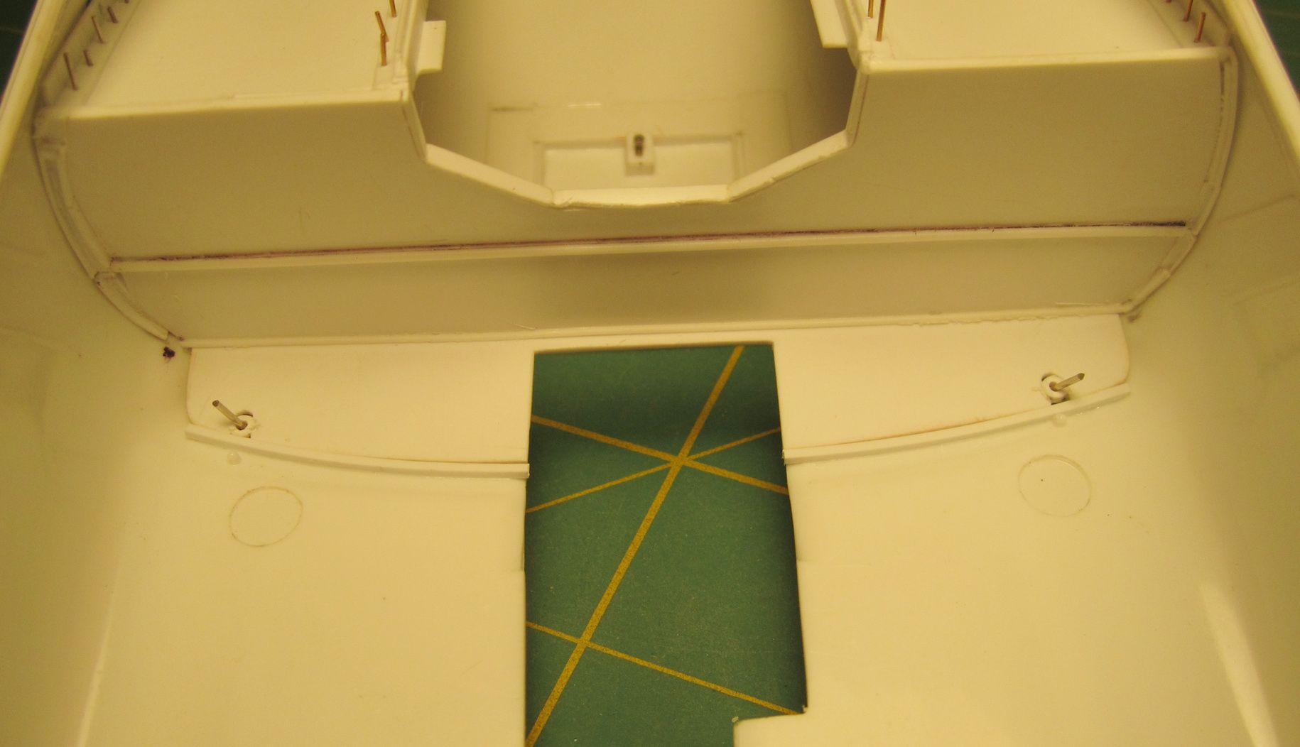

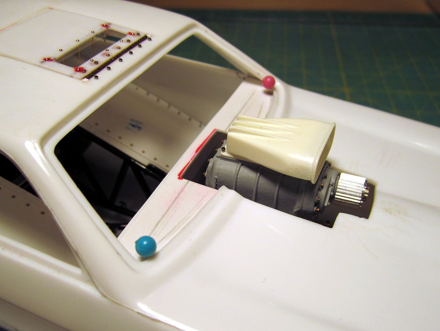

Mooneyzs Posted January 29, 2014 Author Share Posted January 29, 2014 So tonight I decided to fix the issue with the tin work from yesterday that I ran into. I will explain what I did thru the pics.... thanks for looking... I first started out by taking my Xacto Knife and scribing both side of the tin work. now I didn't go completely thru because i wanted to still be able to make it flex so to speak so I could move it into position to re-glue it: Next I did the same thing on the firewall where I originally scribed and bent the plastic then glued a supporting strip there. So I took the Xacto Knife and scribed away until it became flexible enough that I could straighten it out. when It was put into the position I wanted I re-glued another support strip to it. I was using .025 Evergreen Rod: I did the same thing for the Dash since I needed to change the angle of where it originally was at: Next I placed the tin work back into the body and then I pinned it with some pins where i wanted it so I could add some stops on the underside of the body: I laid some ,040 x .040 Styrene where the tin work would sit up against it: Upclose shot: Quote Link to comment Share on other sites More sharing options...

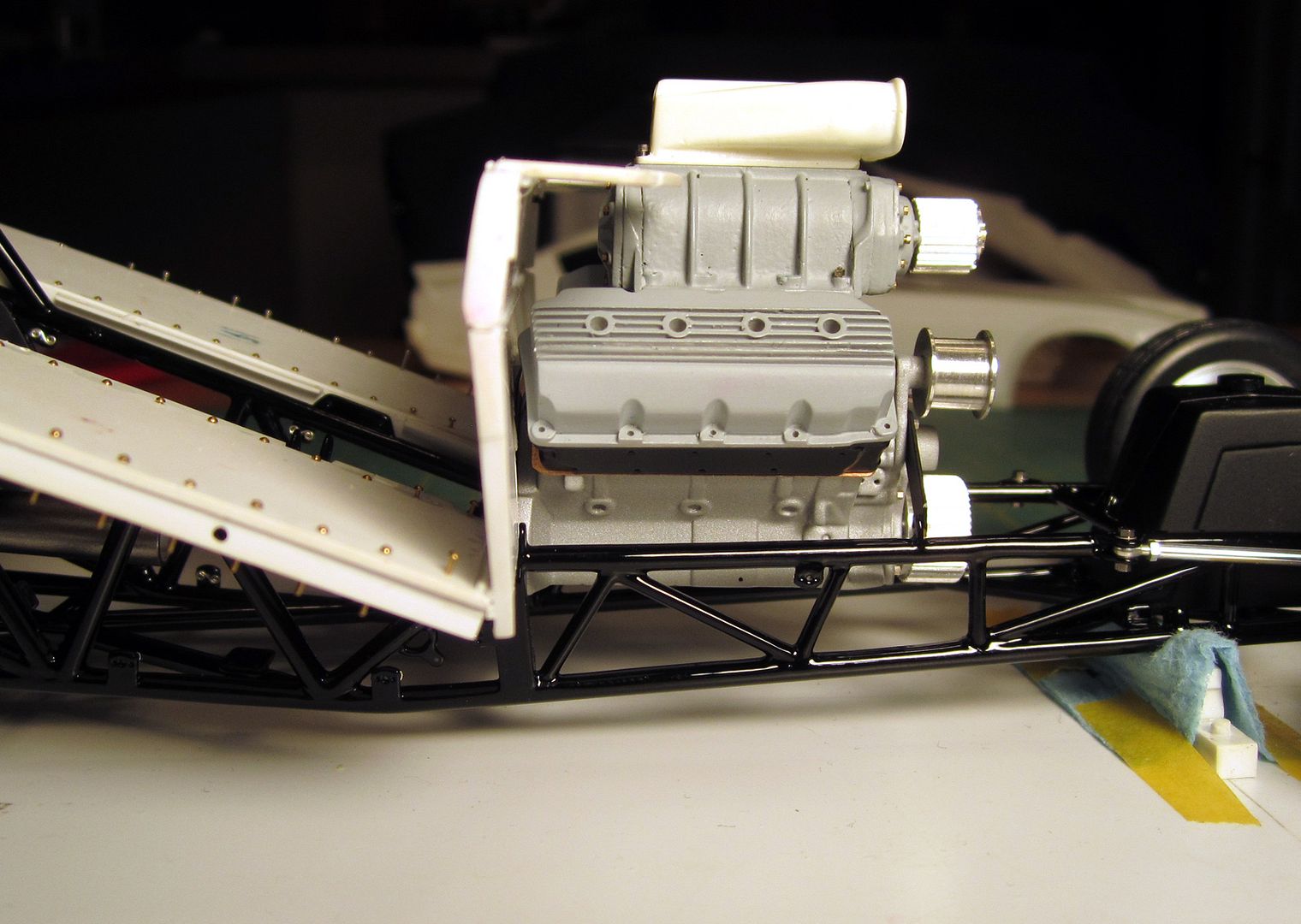

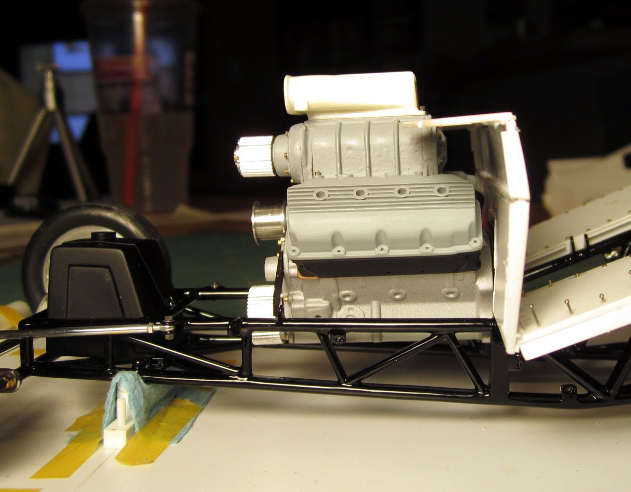

Mooneyzs Posted January 29, 2014 Author Share Posted January 29, 2014 Here is a shot looking into the interior, Now the dash doesn't have such a big angle like it did before on the fire wall portion of it: Here is the space I now have after making the adjustments to the tin work: Previously: Here it is from the other side: Previously: Quote Link to comment Share on other sites More sharing options...

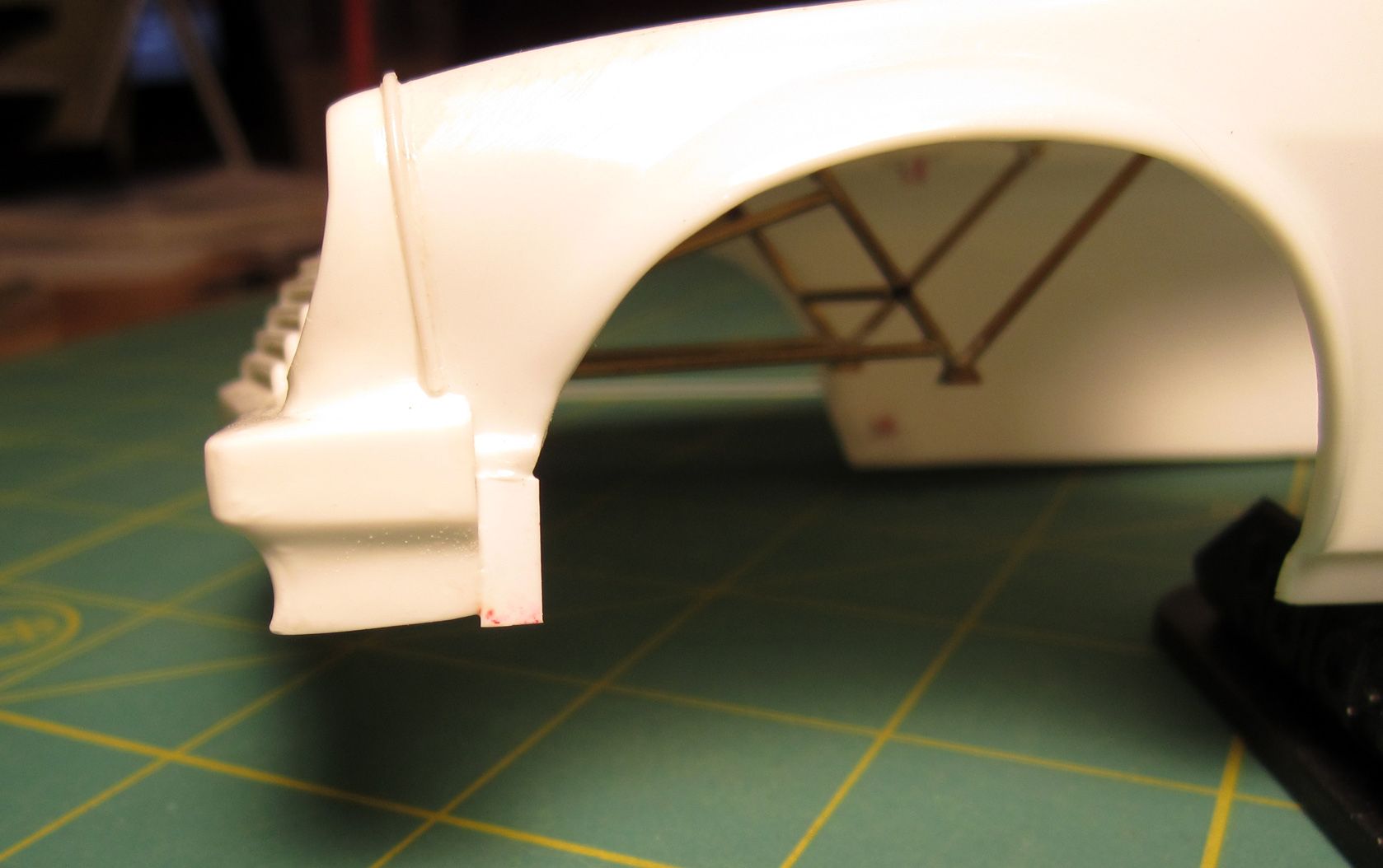

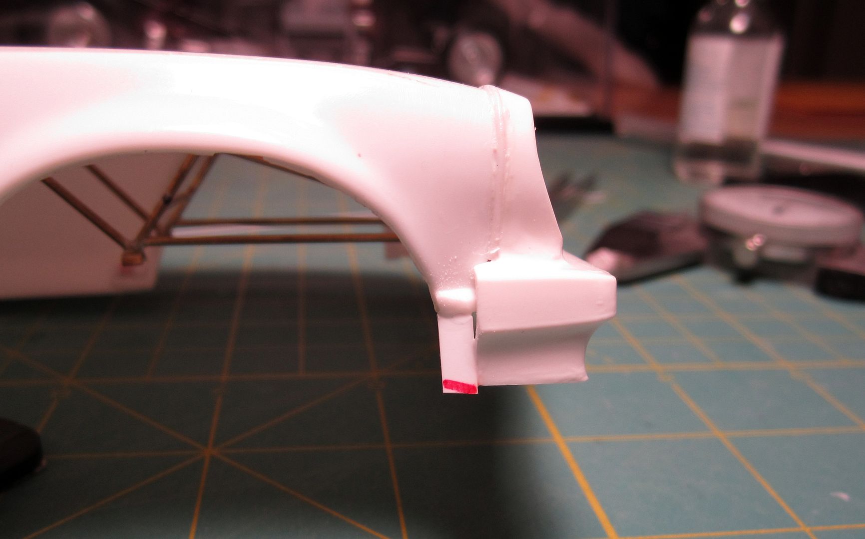

Mooneyzs Posted January 29, 2014 Author Share Posted January 29, 2014 After completing the fix on the tin work, I jumped over to fix a fitment issue from Revell with the front bumper and body. The part of the bumper needs to be filled in as well adding material to the fender (Right Side): Left Side: The Car (hopefully you can see right behind the bumper on the fender. Don't mind the arrow pointing to the body hold down latch (and yes I will be making this for the car and it will be spring loaded and will work ): Quote Link to comment Share on other sites More sharing options...
