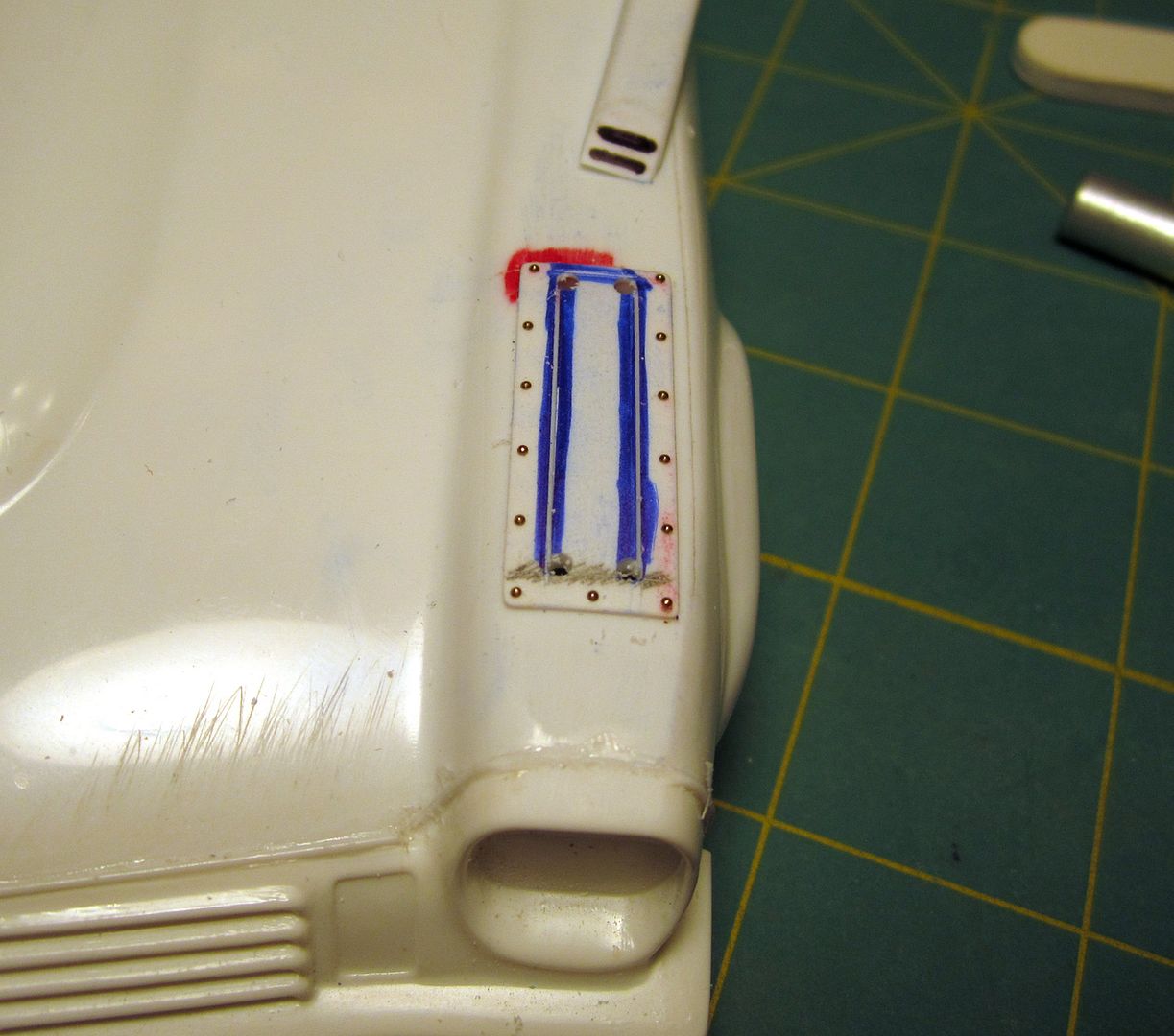

Chris,
I want to throw this out before you go much further. To me, it seems like the radius at the upper rear portion of them could stand to be just a bit more gradual as they transition into the downward sloping rear wall. Maybe it's my eyes, but yours seem to have just a bit sharper edge than the 1:1 pics. The angle looks right. They just look like they could stand to be a bit rounder over the top. Take it for what it's worth - maybe not much... :)
Scott

Mike... Lol I know I can never leave it alone...hahaha I just want to have these air dams done lol
Dave..... Thank you
Scott... Thank you for the feedback my friend, I really do appreciate it. I will work the back edge a little more and make it a bigger radius so they aren't so sharp and have a more rounded edge.

Chris....After looking at them some more...IMO ... it looks like the vent area on the 1:1 car has more of a radius to it. yours looks more like it angles back....I also tend to think that the vent its self is a bit wider on the 1:1 car...the distance between the side of the vent and the rivets on the base piece look to be less than what you have...Might just be me but that kind of what I am seeing whe I look at it...and I think the base might be a tad thick compared to the 1:1.
What you have is way better than I could do though ...so not sure I should be putting in my 2 cents worth anyway....

Dave... Thank you. on the vent you talking about the rear vent?? I added a lip to give a little bit of support but once I glue it to the flange plate that has the rivet in them, I will be opening up that rear vent some more. I am also going to be adding some bondo that will create the radius between the flange and the side pieces. the base piece I used a .020" thick piece of plastic. I could always try to sand it down to thin it or even take the part and transfer it to a .010" thick piece. I am going to have to consider that before I glue the main piece onto the flange.

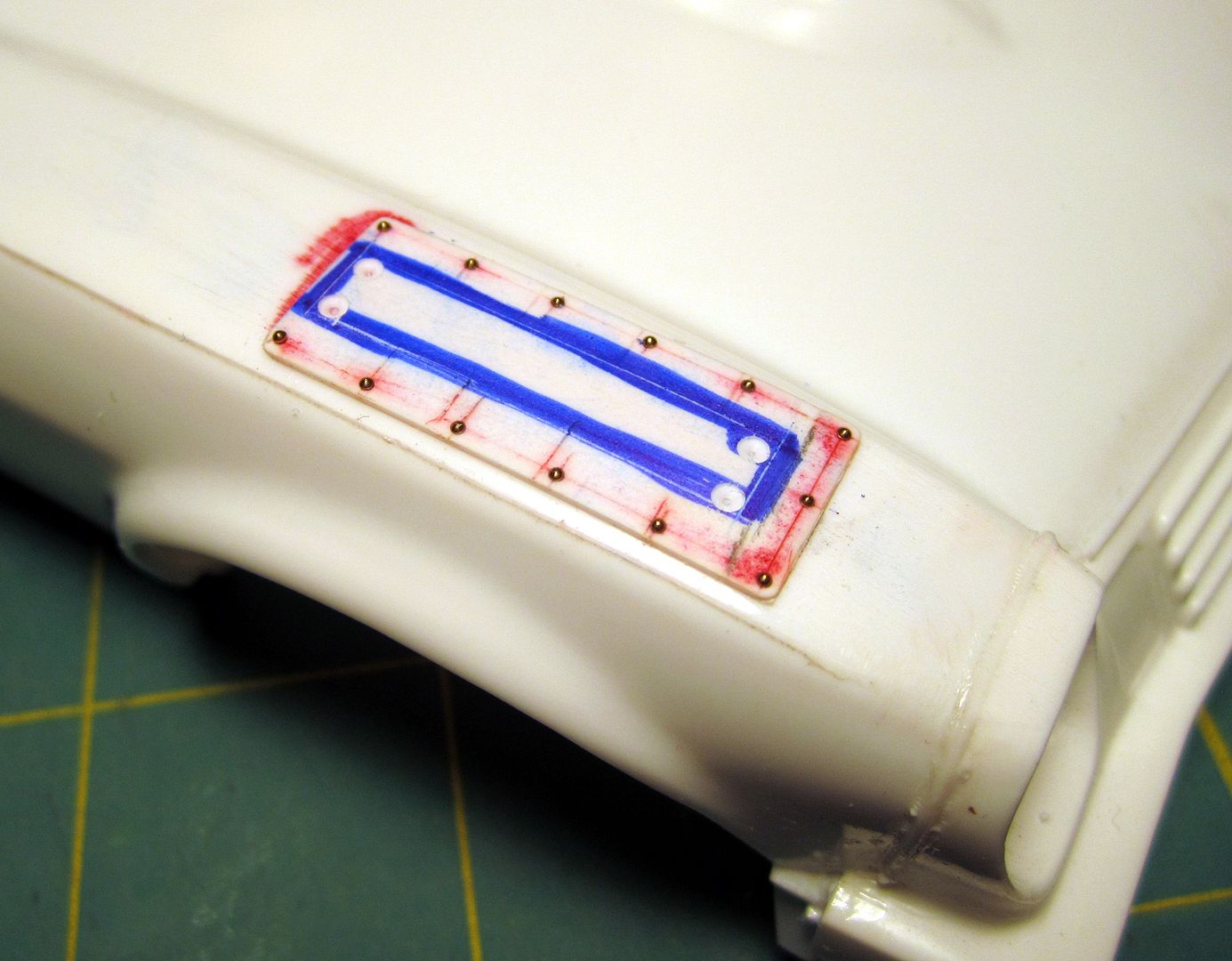

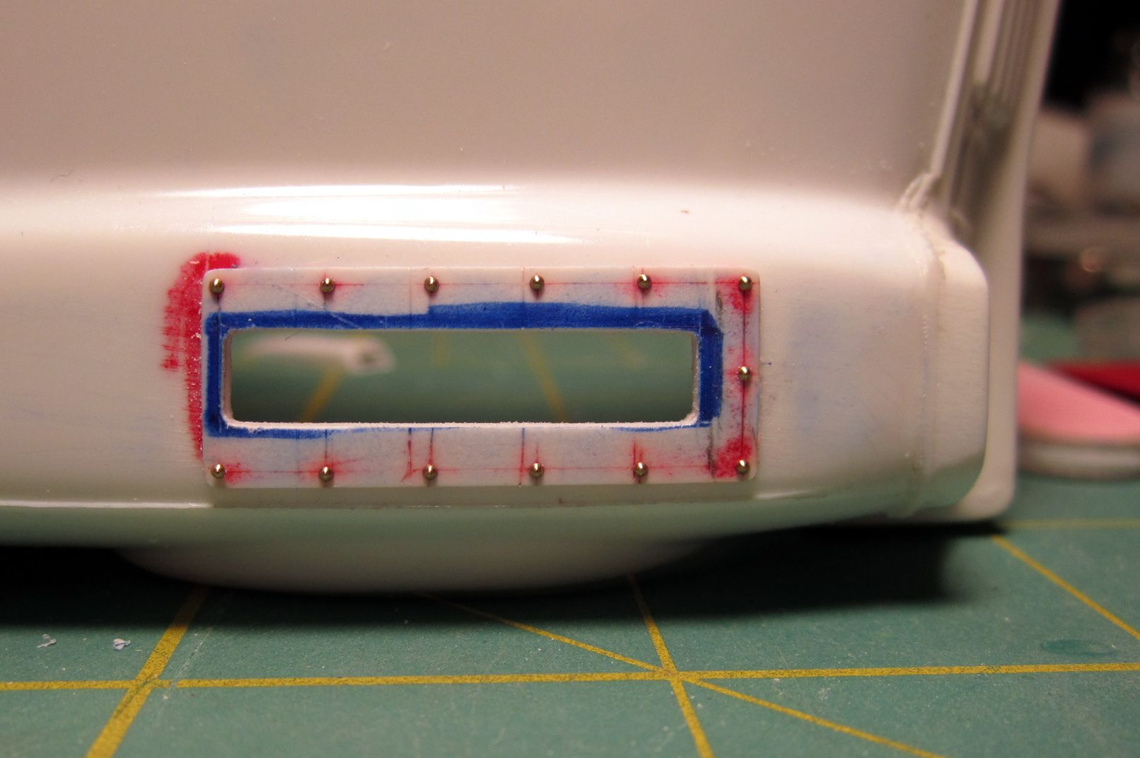

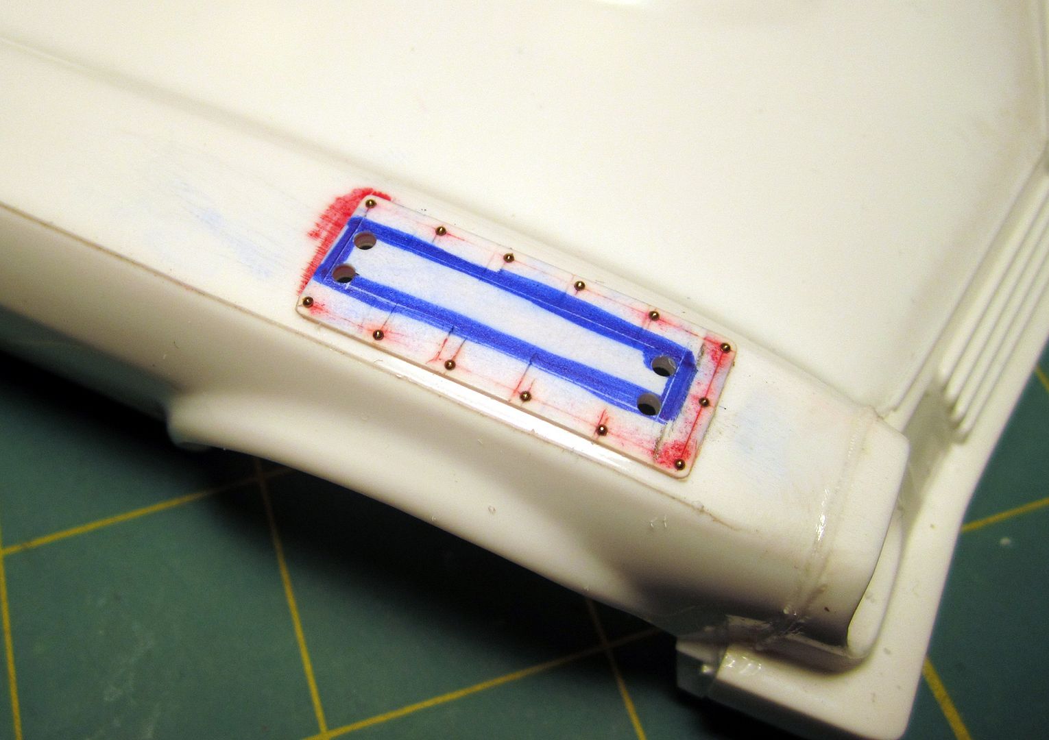

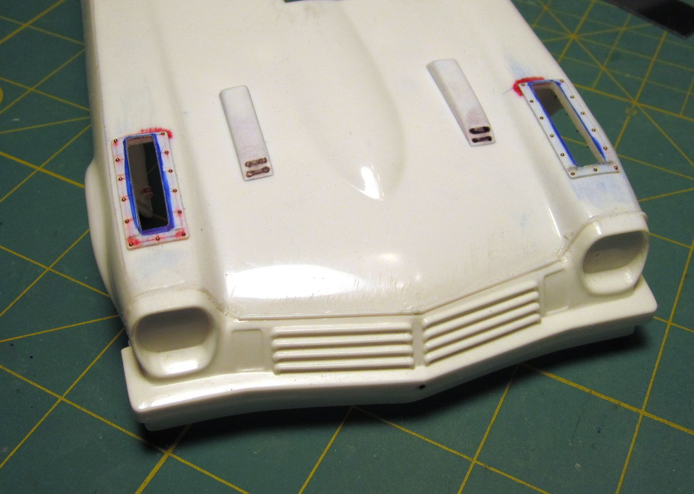

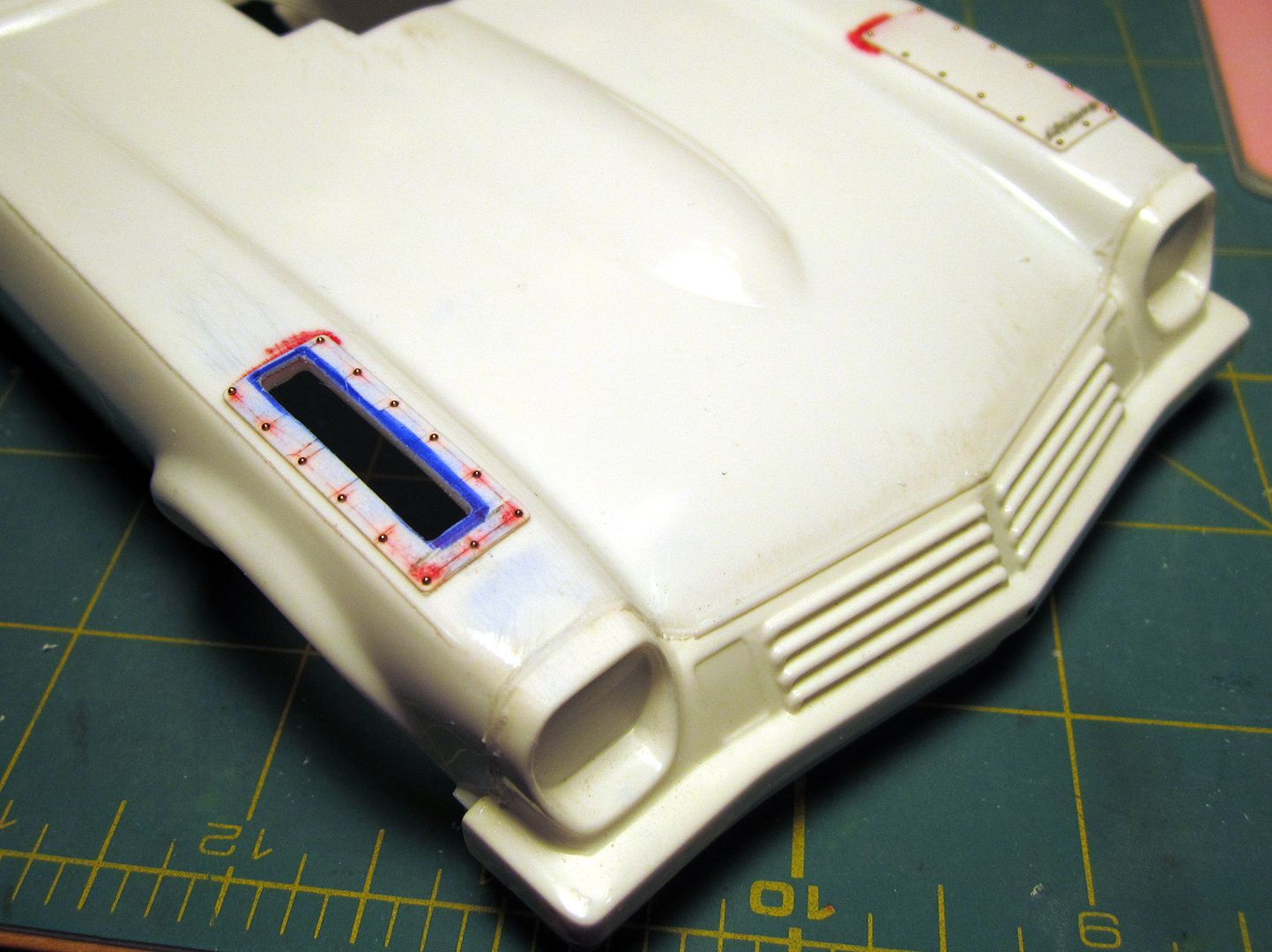

So I was able to sit down at the bench for about an hour or so and started on cutting the holes out of the body and flange for the air dams. Only got one side done but I am happy with how it was coming out. here are some pics....
I started by lightly scribing guide lines into the blue sharpie of where the cut out was going to go. Then I started to drill the corners so that I could make my cuts by scribing and cutting the piece out:
Next I drilled all of the corners out:
Then I scribed for a while taking my time not to gouge any of the plastic or having it slip out of the groove...lol:
Showing the cut out and now you can see thru it:

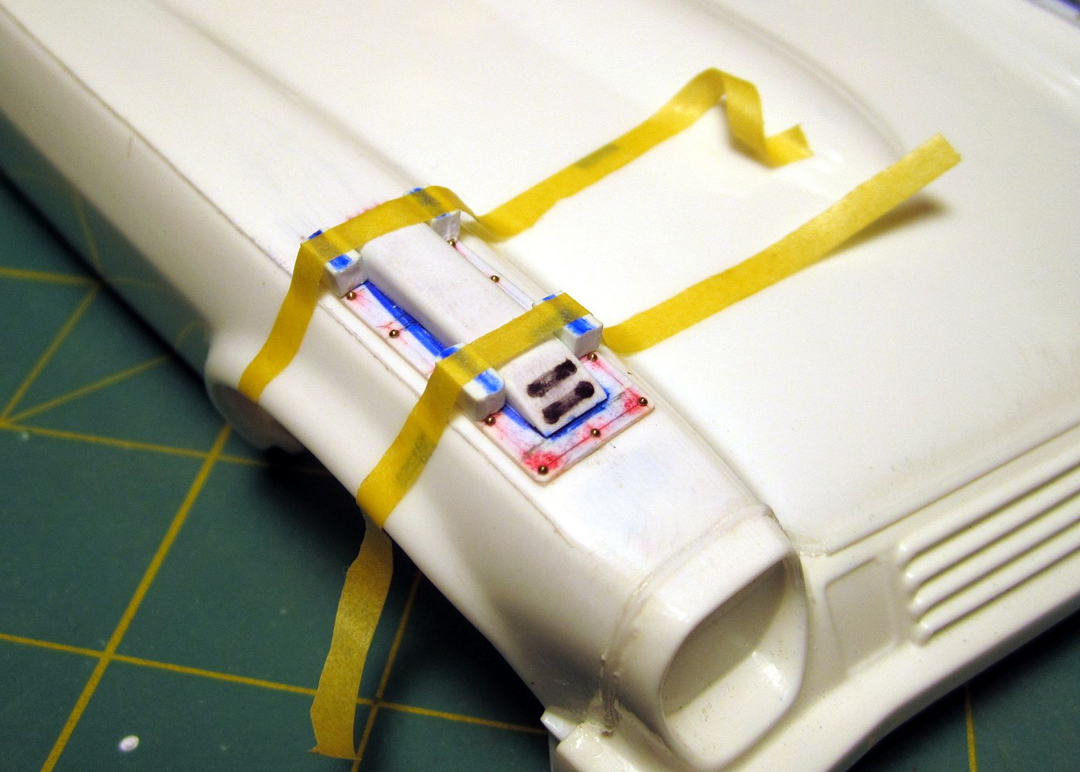

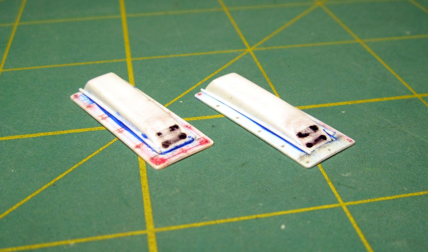

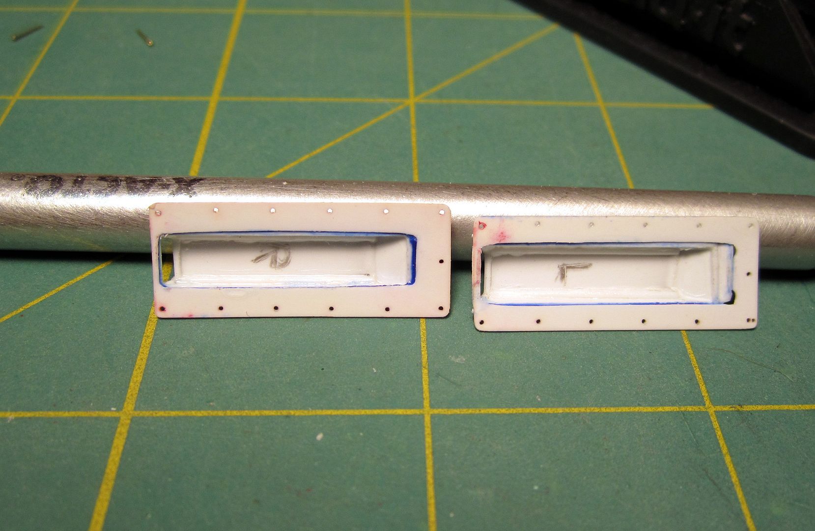

Well Fellas... I can say that I am getting closer to getting these air dams finished. I still have a little more fabrication to do on them but I am making headway. I worked on them for a short time yesterday and some time tonight. I have gotten the flange and main body glued together and added some support pieces on the sides that will get shaped into place and then I just need to drill the vent holes in the front as well as open up the rear vent holes a tad. And I may try to clean the inside of the air dams up with a little bondo and plastic to make them a little smoother. Here are the pics
Here I started just like I did the other one by drilling the corners out first and then scribing the part to cut it out:
Both opening have been cut out:
Mocking up a way to hold it in place when i was going to tack it with some glue:
Here they are off the car and glued. you can see I added some rod around the side and base that I will add a radius to which will make a transition from the flange to the body of the air dam:
And here is the underside of the air dams, I am going to try and sand the plastic in the inside and add a little bondo to make them look a little smoother on the inside:

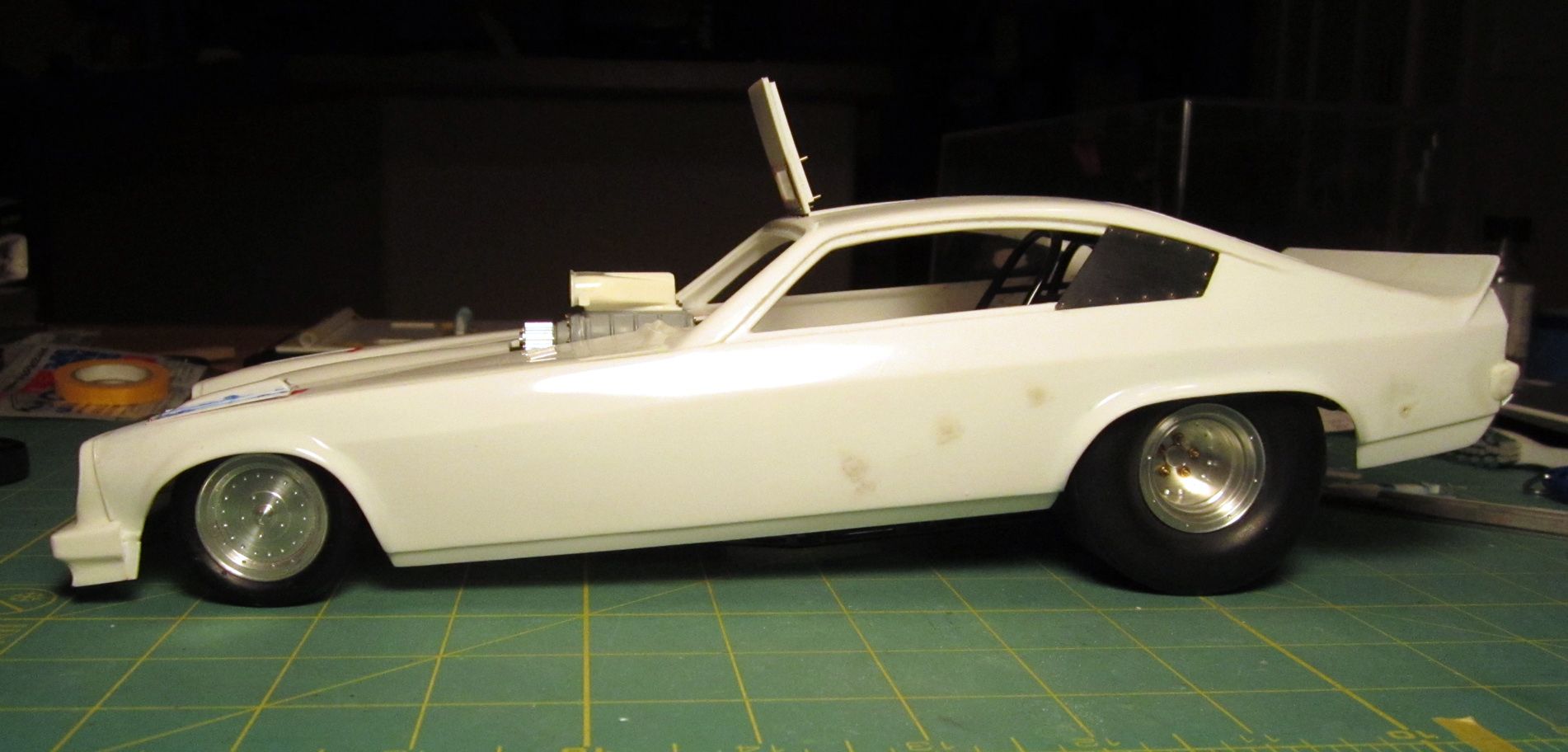

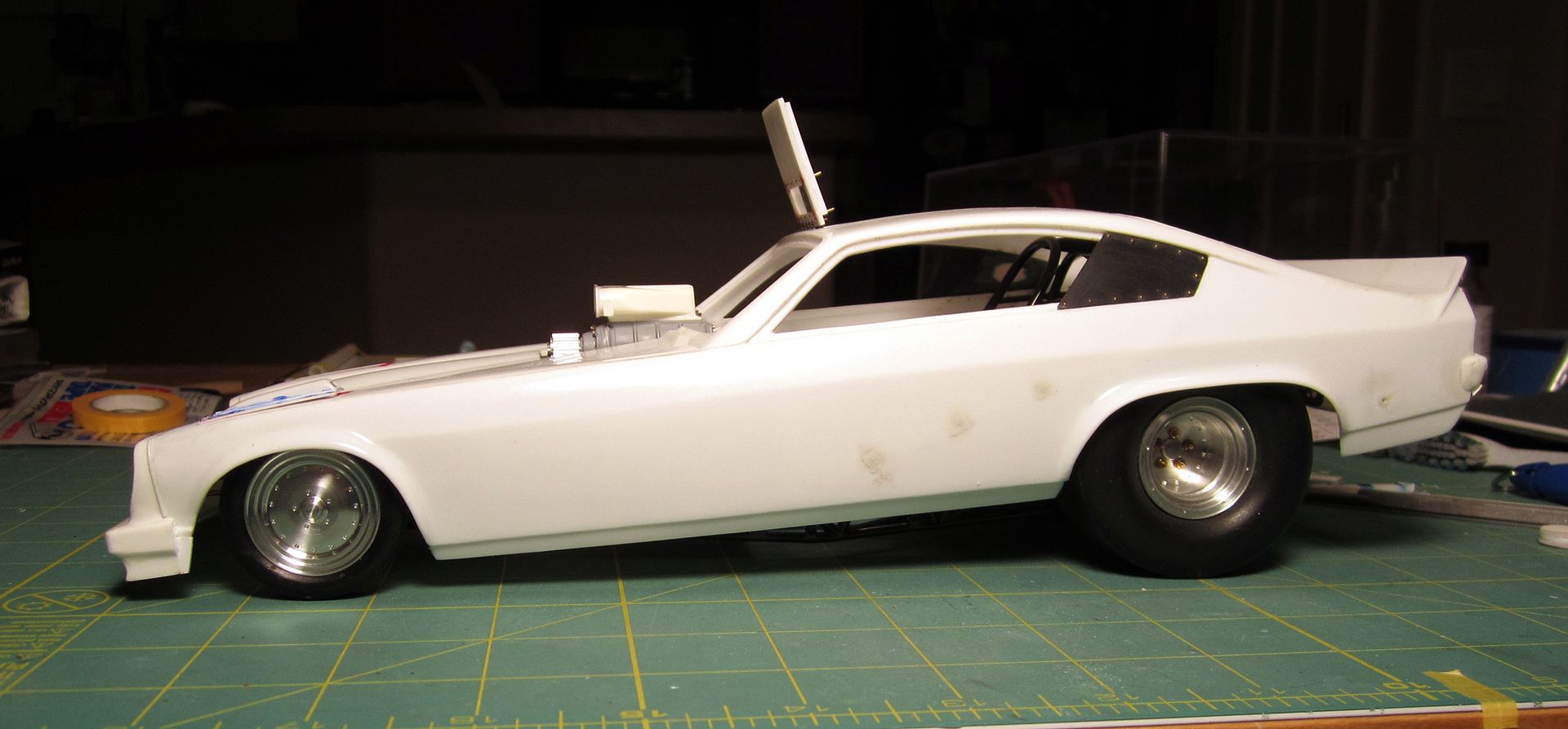

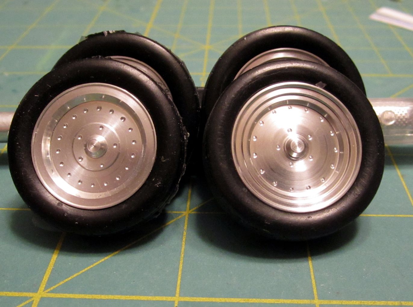

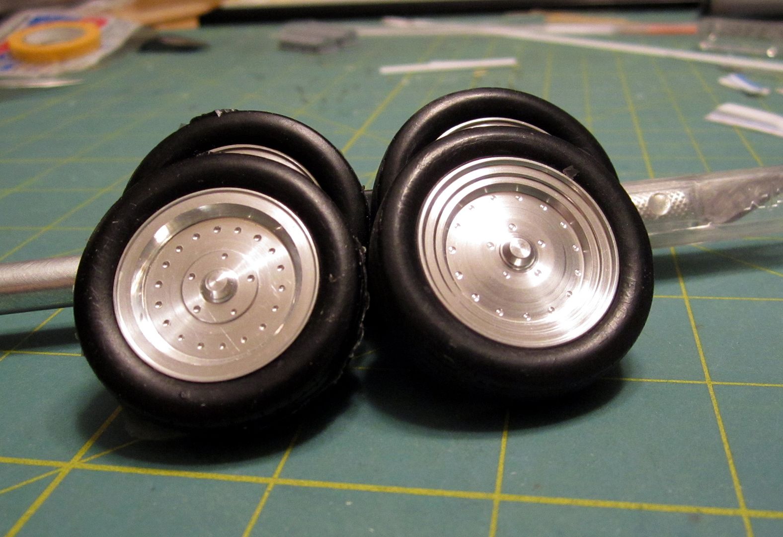

Well Fellas... I got some more work done on the air dams but still not complete. I hate to say it but i am starting to get burnt on them. I seriously just want them done, They are really close but still have a little to finish on them but before I show you them I have to show you some pics on some goodies I got from Jim at Micro Nitro. A while back I had realized when I originally ordered my front wheels for this project they weren't what was on the real car well I decided to purchase another set of rims that match the car and I just got them and I think it just adds to the look of the car. Jim did some very nice work for me on these. Here are a few shots of the new rims....
New rims from Jim at Micro Nitro. The old ones i had on the left (Centerlines) and the New ones on the right (Cragers):
Old ones on the car:
New Cragers on the car:
