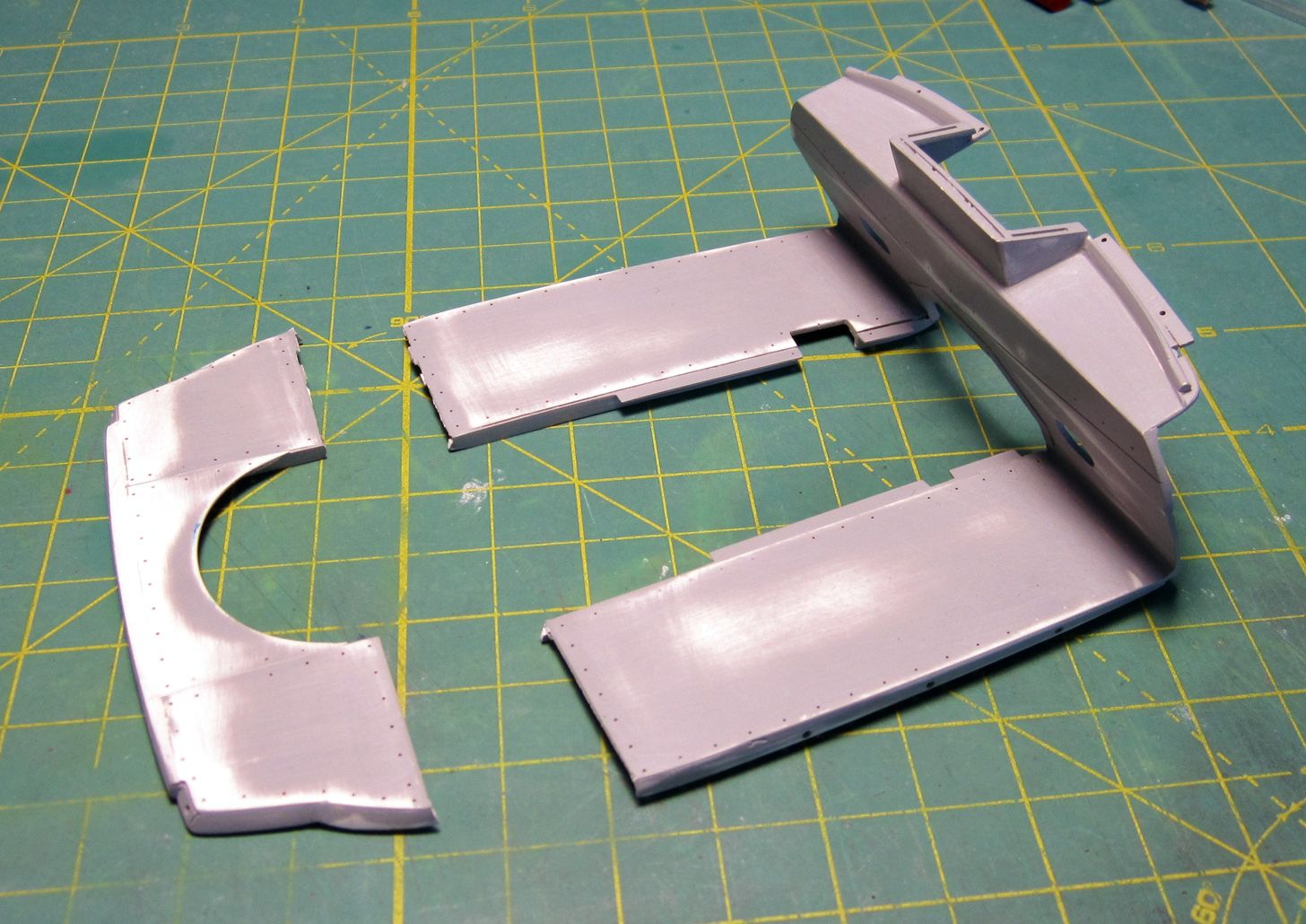

Well guys after a few days away from this build I figured it was time to get back to it and do some more work on the tins. I was starting to stand the primer and going to add some more bondo to make this tin work look better...... Well I had a major hiccup and at the moment I am pretty pissed-off at myself and feel like boxing this up or at least putting the tin work aside and working on something else. After sanding the tin work before I was going to add some bondo to it, I decided to rinse the tins off with water to clean all of the sanding dust off it and well some how and I haven't a clue how I did it but I snapped it in to two. No idea how I broke it but I did and very disappointed at myself at the moment. I know its not that bad but after all of the hours I have put into this part and am really mad at myself. Anyway here is the damage......

I'm sorry to hear about your setback, Chris. I feel your pain, after having dropped my Fairmont earlier this year. I know what it's like, too, to be upset with onesself because of what is seen as an unnecessary accident. All I can say is I'm sure you'll get over the frustration and will be back in the saddle again - probably in no time. On a positive note, everything is looking incredible...

Ouch, that's a Bummer! :( I'm sorry to hear that, but I know you'll be able to fix that one soon. As someone said, it was good it wasn't painted and riveted. I dropped a completed chassis by an accident, too a while ago so I know how it feels. Well it's just a little speed bump, I know you'll fix it so that it looks perfect! ;)

Hey Everyone.... I just wanted to say thank you all for your support. I was pretty upset with myself yesterday with what happened to the Tins and took a break from the build yesterday. I know it wasnt the end of the world but it can be fixed. Today is a new day and last night I looked at the broken parts and came up with a solution to fix it. I won't let this little hiccup get me and I will over come it. I let myself become discouraged because i have so many hours in this tin work and felt I was really close to being done with it and honestly i am so tired of working on it and ready to have it finished and painted.but I know I will have to put some extra time into it now. Hopefully I will get some time tonight but i have some house chores that I need to do once i get off work.

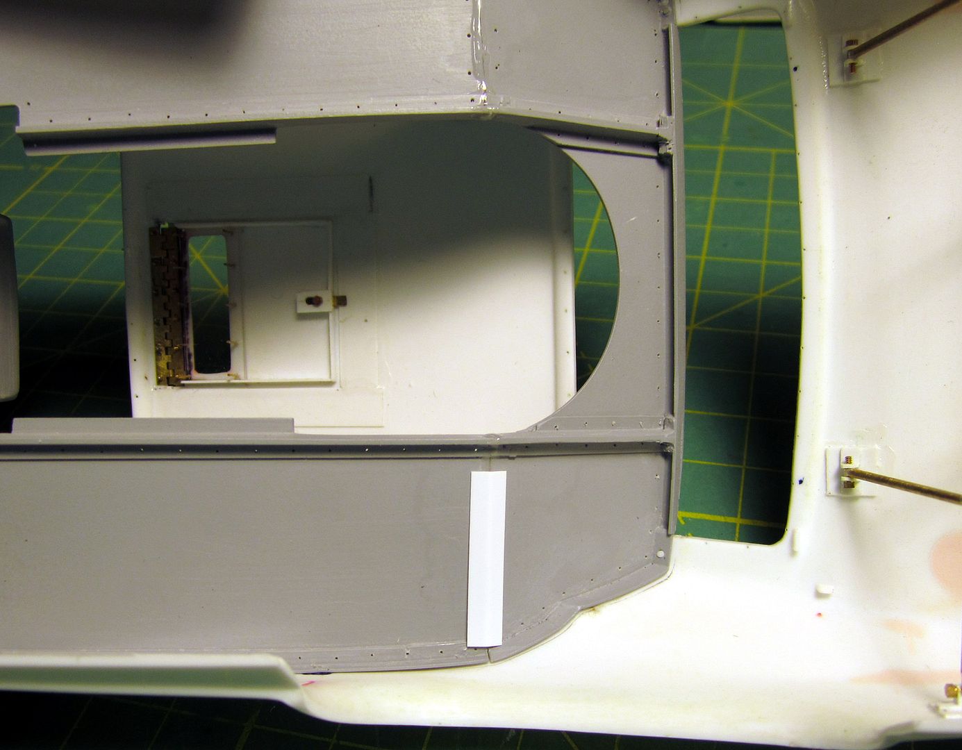

Well fellas.... I wanted to let you know that I got back to the bench on this build tonight for a little bit and went straight at it with fixing the tins. I just needed a day or two away and missed this build too much...lol I have started on the fix and although its not 100% fixed yet but its on its way. I did get the tins glued back together but I have decided to leave it in the body over night before trying to pull it out and put glue on the other side. Although it probably won't go anywhere since I decided to fix it with super glue...lol Here are a couple of pics to share....
Here I have placed the 2 pieces of the tins in the body to see how I will do things:
Next you can sorta see some of the super glue that I used on the top portion of the tins. I put some super glue on the edges that were butting up to one another and then I went back and went along the seam with super glue then hit it with a little kicker to make sure it had a good bond. Then I decided to put another little small layer of super glue on it again after I had both sides done...lol:
While gluing the pieces back together, I really wanted to add a stiffener in the mix just to make sure it doesn't break on me again. So what you see is an idea that I am going to take a piece of plastic that is .010" thick x .188 Wide I am going to use as a stiffener. I will bend the piece to fit the contour of the tins and I will superglue in place. Then I will go back and then drill the holes back in for the rivets. It should be much stronger when done:
