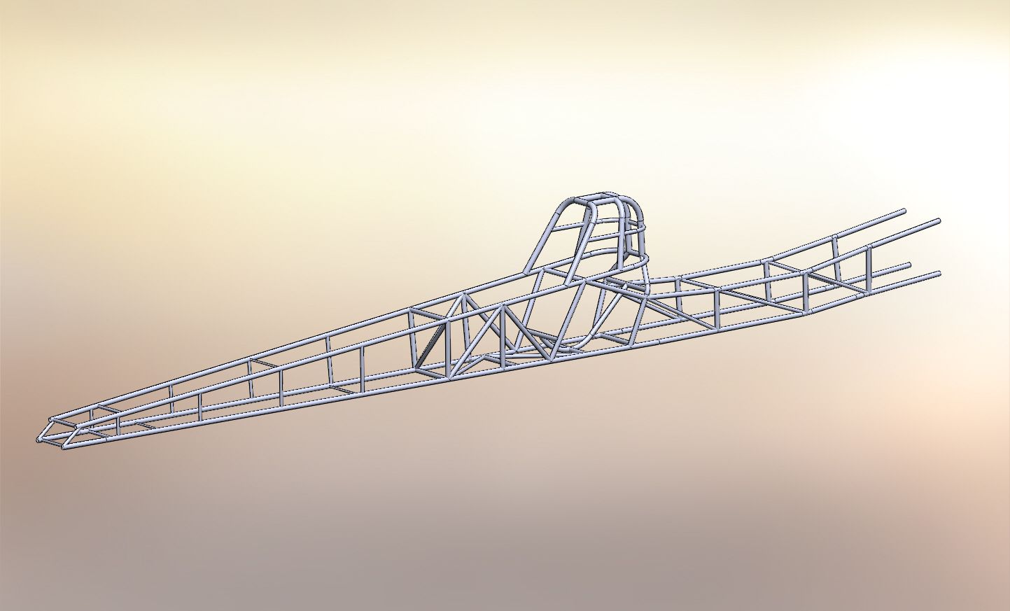

Mooneyzs Posted August 26, 2016 Author Share Posted August 26, 2016 Well for a change of pace I decided to do some work on my CAD program and practice drawing up a dragster frame. So here is what I have been working on and I think I have found a few different ways to get the results I wanted. Originally I was going to draw it all in a 3D sketch mode but decided to combine some 2D sketches on different drawing planes, I had to have some differnt planes at specific angles to achieve what I wante and I also combined with a 3D sketch mode.. Then I used what is called a Weldment to add all of the tubing. Here is what I have so far. I am pretty darn happy with the results. Been a nice break and has taken me longer than expected but it's worth the practice It still needs a few more items on this chassis though. Quote Link to comment Share on other sites More sharing options...
bobthehobbyguy Posted August 26, 2016 Share Posted August 26, 2016 Two shows I will be goung to next year. Nice job on the dragster frame.Chris hope you can get your motivation back. The nnl and gsl are definitely Quote Link to comment Share on other sites More sharing options...
Codi Posted August 26, 2016 Share Posted August 26, 2016 Great looking design Chris. You've got to start an all new thread for that one. cheers sir. Quote Link to comment Share on other sites More sharing options...

Davewilly Posted August 30, 2016 Share Posted August 30, 2016 cool looking dwg! Quote Link to comment Share on other sites More sharing options...
Mooneyzs Posted August 30, 2016 Author Share Posted August 30, 2016 Bob... Thanks... I am looking forward to both of those shows. I just hope I have new stuff done in time because if I don't I probably won't end up going. Thanks on the dragster.Tim... thank you so much my friend. That was just a practice chassis to figure out how I was going to model the chassis. Originally I was going to do a completed 3D sketch in my software but I ended up with 2D and 3D sketches along with adding multiple planes to achieve what I needed to. I created the 3D model from the welders feature. I will adventually have another thread for that dragster once I get the correct chassis designed up but probay won't be for a while.Jason... no I haven't made my parts available yet. I still have some bugs to work thru on them.Dave... thank you very much. Quote Link to comment Share on other sites More sharing options...

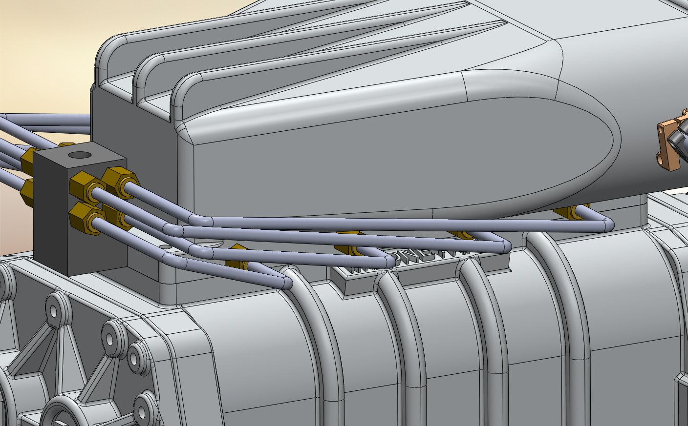

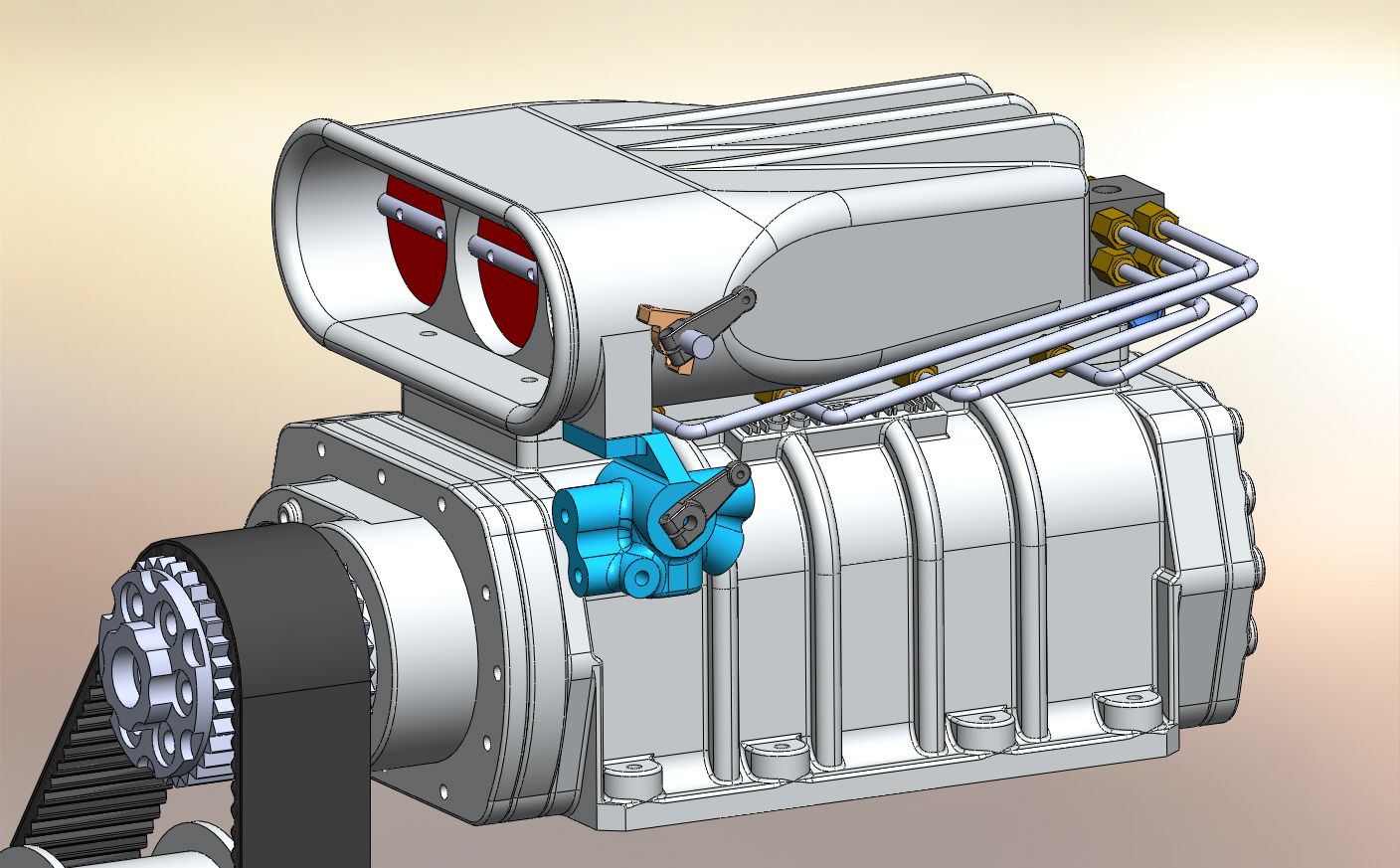

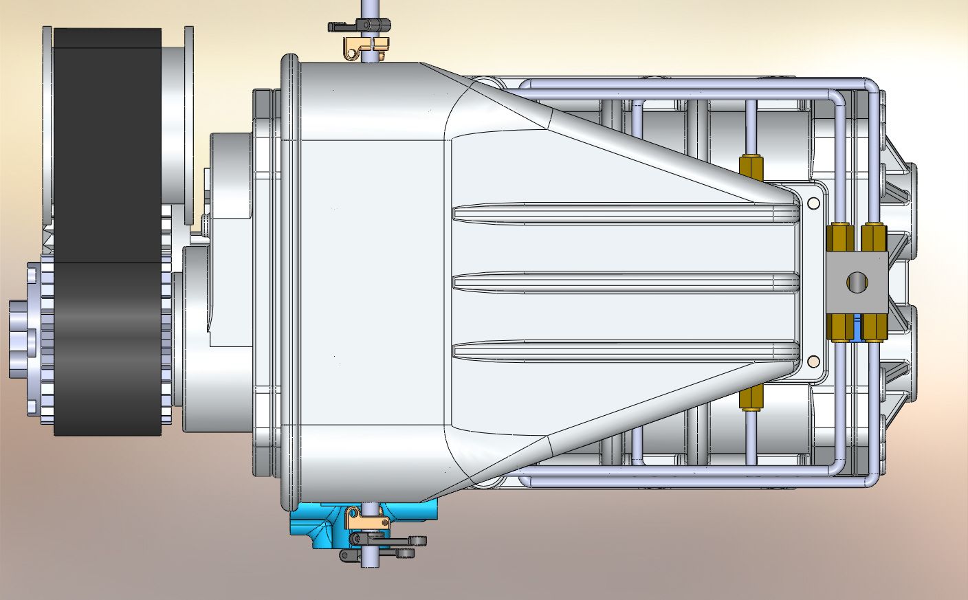

Mooneyzs Posted September 1, 2016 Author Share Posted September 1, 2016 Hello Everyone.. I wanted to show what I have been working on the past 2 nights. I have wanted to start getting some of the plumbing done on the engine and well I figured I would utilize the 3D models to create my Injector lines. From the Models I will create a 2D drawing that I will be used as templates to bend the lines from. I Figured it would better to do it this way than to bend multiple pieces trying to get the spacing correct considering I will be using steel piano wire or possibly guitar string. I am debating which would be better, my only concern with the piano wire is that it has the possibly to corrode over time where as if I used a nickle coated guitar string It shouldn't. Anyway here are a few shots of the 3D model..... Quote Link to comment Share on other sites More sharing options...
Nytrozilla Posted September 1, 2016 Share Posted September 1, 2016 I have a file that has nothing but pictures of blowers / fuel lines / linkage, etc.Today it has 4 more. The K valve is a thing of beauty. Quote Link to comment Share on other sites More sharing options...
Davewilly Posted September 1, 2016 Share Posted September 1, 2016 Nice! Quote Link to comment Share on other sites More sharing options...
blackbeard Posted September 1, 2016 Share Posted September 1, 2016 very nice you might want to try to detail masters break lines for this Quote Link to comment Share on other sites More sharing options...
Mooneyzs Posted September 1, 2016 Author Share Posted September 1, 2016 Joe... Thanks man. That is cool you have a file with pics like that. I sorta have the same with reference pics...lolDave... Thanks.Henry... Thank you but I have already got Robert over at RB Motion that made me a variation off his detail nuts because I needed them wider than what they were. My Personal preference is RB Motion fittings for my A/N Fittings source. Quote Link to comment Share on other sites More sharing options...

Codi Posted September 1, 2016 Share Posted September 1, 2016 Man that looks fantastic Chris......I might have to bug you for some "numbers". Your renderings are something to behold....and yes, your cars too. Cheers, Tim Quote Link to comment Share on other sites More sharing options...
bobthehobbyguy Posted September 1, 2016 Share Posted September 1, 2016 Nice work on the drawings. I am curious how you go from the 3d to 2d drawing. Quote Link to comment Share on other sites More sharing options...

10thumbs Posted September 2, 2016 Share Posted September 2, 2016 QUESTION: How exactly is the fuel block attached to the back of the injector / intake unit?How about this in 1:25? Quote Link to comment Share on other sites More sharing options...

Mooneyzs Posted September 2, 2016 Author Share Posted September 2, 2016 Henry... Thanks. Michael... To answer your question. on the back of the Injector hat there is threaded hole and Also in the Fuel Distribution block there is counter bore hole for a Socket Head Cap Screw that mounts the distribution block to the injector hat. Here are a few pics of different style injector hats to show you. You should be able to see the mount holes on the first couple of pics. Things could easily be scaled to 1/25. Bob... you are welcome. It's something that the program does which is pretty cool. Quote Link to comment Share on other sites More sharing options...
blackbeard Posted September 3, 2016 Share Posted September 3, 2016 those are all great pictures of what you are talking about especially the last picture is how I am thinking about doing on my builds Quote Link to comment Share on other sites More sharing options...
10thumbs Posted September 4, 2016 Share Posted September 4, 2016 Thanks Chris!Also, the pics are just excellent, a true reference for this area. Just so happens I'm doing a fuel block like you show, many thanks.By the way, the "7mm" printed on the plug wires should really end the discussion of model car engine plug wires. Great pics. Quote Link to comment Share on other sites More sharing options...

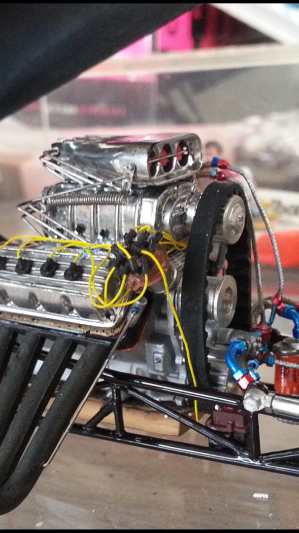

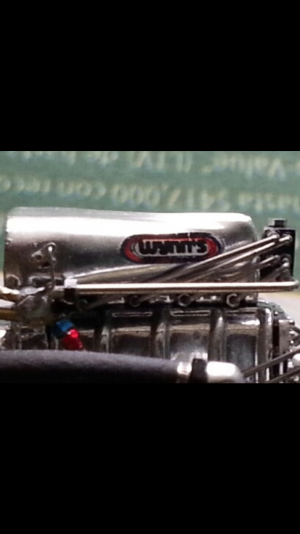

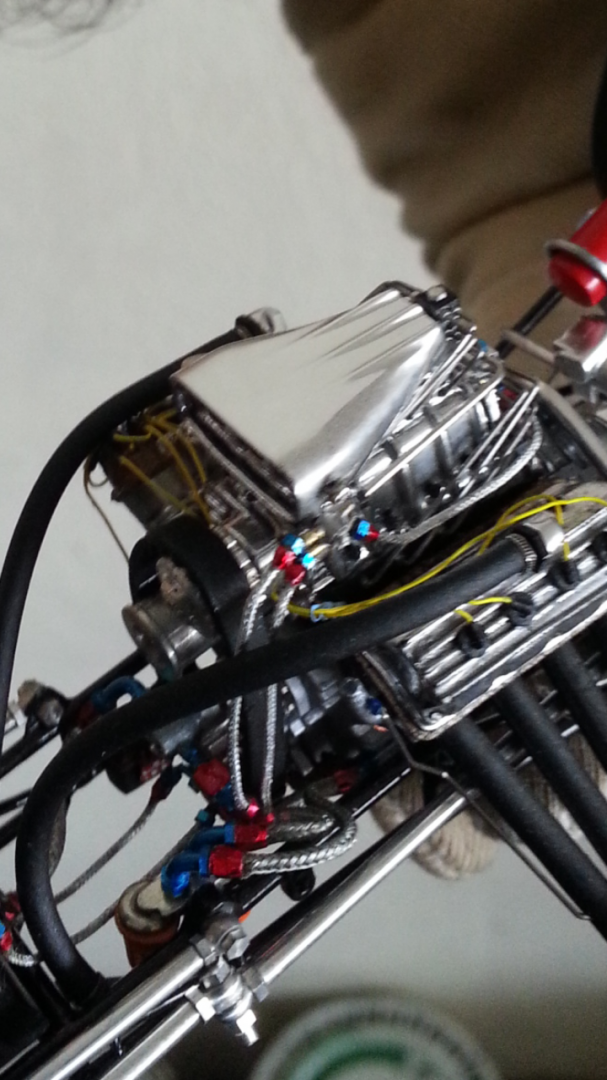

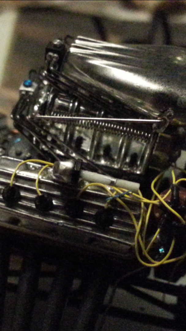

simonr Posted September 5, 2016 Share Posted September 5, 2016 Hey Chris impressive works so far, as always..definitely will be a masterpiece when you finish it.. This how I worked mine in 1/25 for the fellas that asked you and want to see how it looks.. Quote Link to comment Share on other sites More sharing options...
