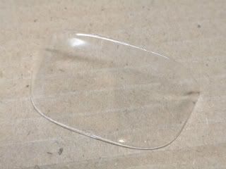

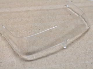

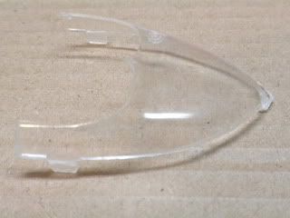

dannyi Posted January 13, 2012 Author Posted January 13, 2012 ...well guys I finally got some good results. These were cast with Alumilite Water Clear. Getting an accurate scale made all the difference. These were done in tin cure silicone molds preheated @ 200 degrees for 30 minutes. That temp and time might be a bit overkill but I wanted to make sure they were plenty warm enough. They were then put in the pressure pot @ 50psi for 48 hours. I might be able to de-mold them sooner now that I have an accurate mix but I didn't want to take a chance on that either. Still have a lot to learn about casting clear resin windshields but feel better now that I've had some success.....thanks for all your help fellas
Len Woodruff Posted January 13, 2012 Posted January 13, 2012 Hey Danny what are the windshields being cast for? One looks like a speed boat?
Greg Wann Posted January 13, 2012 Posted January 13, 2012 (edited) WOW! Those do look really good. Congrats on your efforts. Edited January 13, 2012 by Greg Wann
paul alflen Posted January 13, 2012 Posted January 13, 2012 CONGRATS DANNI, I KNEW YOU COULD DO IT!! JUST LIKE THOMAS EDISON, TRY IT TILL YOU SUCEED ! GOOD LUCK PAUL
paul alflen Posted January 13, 2012 Posted January 13, 2012 DANNI , NOW YOU CAN MAKE ANY RARE WINDSHEILDS! YOU JUST NEED A GOOD MASTER COPY TO CAST OFF OF ! OPENS UP A WHOLE NEW MARKET FOR YOU!!!
dannyi Posted January 13, 2012 Author Posted January 13, 2012 Thanks Greg, Len, these windshields are from Cox and MPC 1/24-1/25 slot cars. I believe the first one is a Cox Chapperal 2D Coupe, 2nd is a MPC Scarab and the third one is a Cox Chapperal 2E Roadster. A couple members from our club asked if I could cast very hard to find windshields for vintage slot cars. Thanks Paul, and your right , this could open up a new aspect to my resin casting, I just have to get proficient at it!
