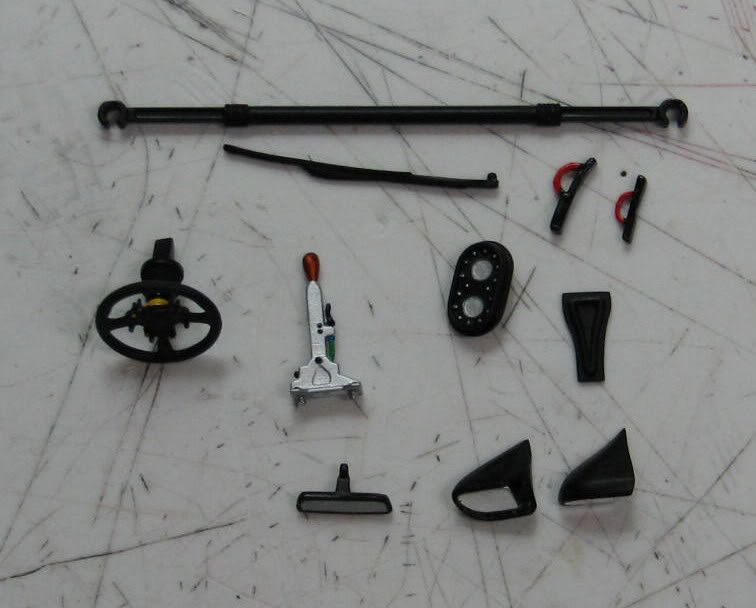

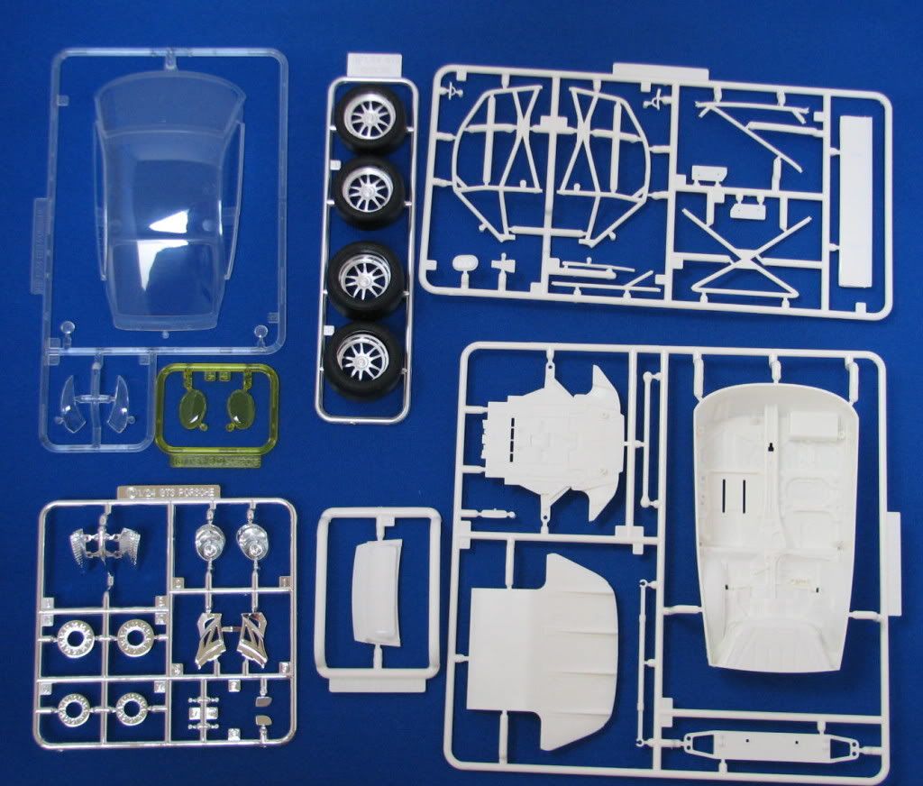

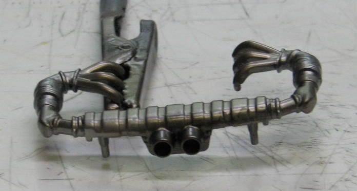

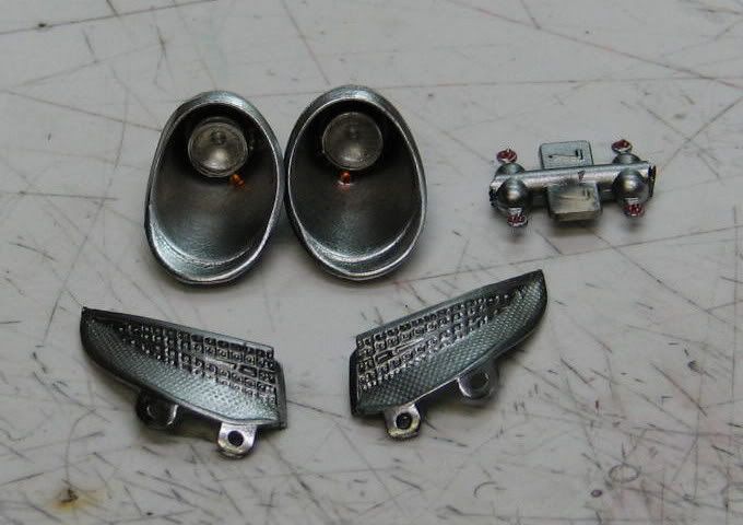

Brendan Posted April 23, 2011 Posted April 23, 2011 (edited) Just started working on the Fujimi 911 GT3. I'm not going to be doing the decaled car that is on the box. I'm going to be doing a car that comes from the factory. Which is overall white with some black highlights. Looks like it's going to be a fairly straight forward kit. Not a lot of clean up needing to be done so it should go fast. Here's a picture of several small parts that I've finished. Chrome parts were stripped and painted with Alclad. Edited June 26, 2011 by Brendan

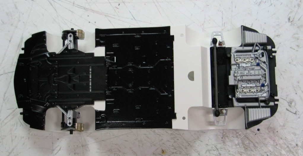

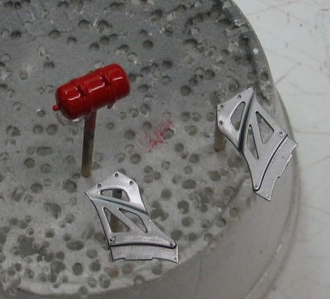

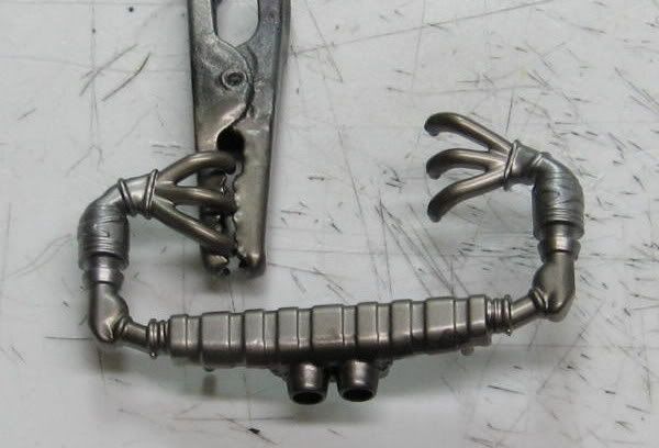

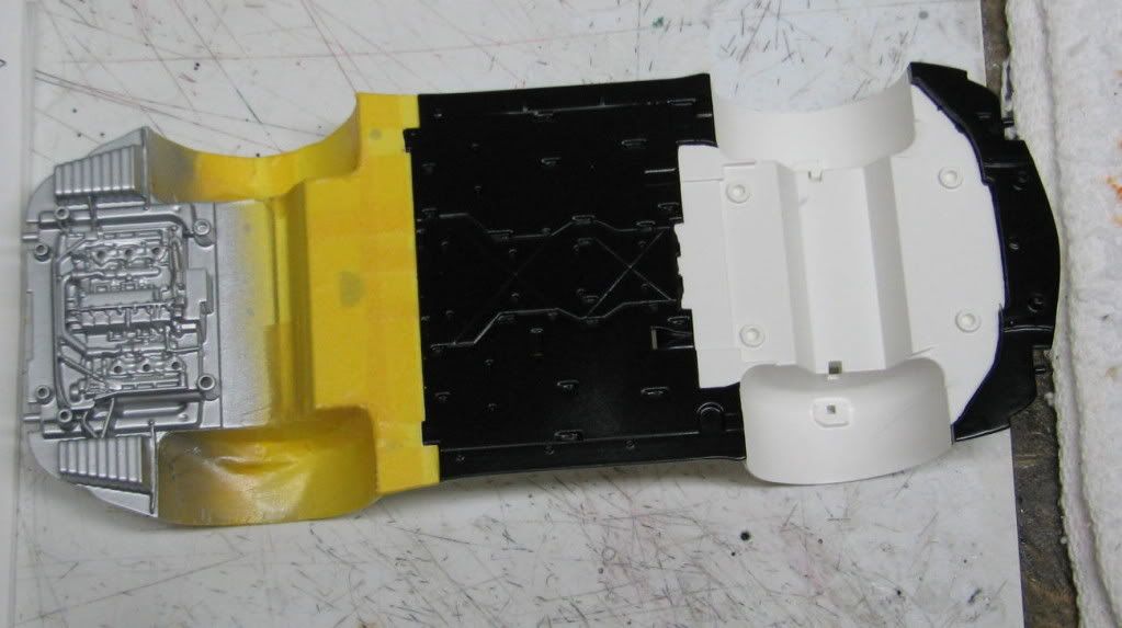

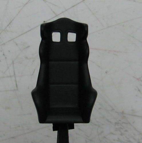

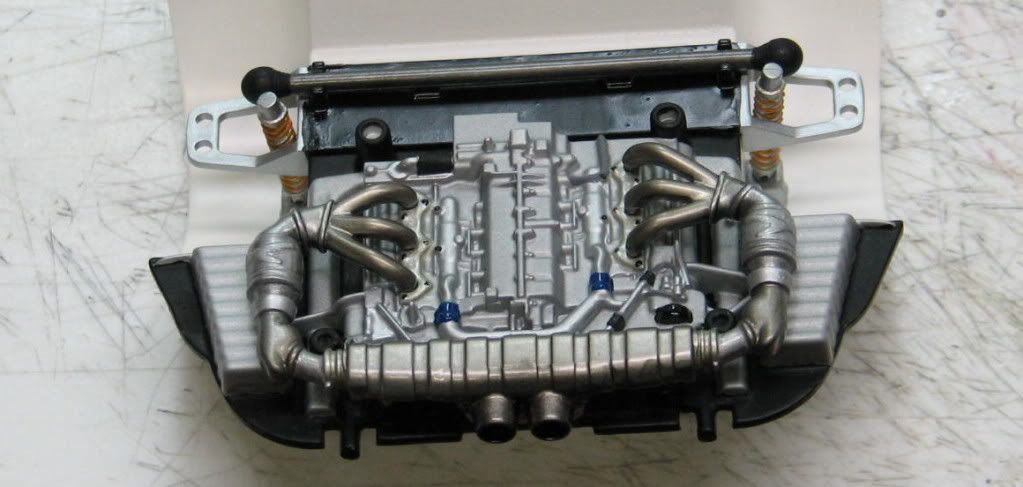

Brendan Posted April 24, 2011 Author Posted April 24, 2011 The kit manufacturer is Fujimi. These kits are sold out as far as I know. But someone mentioned on another thread that they were producing just the plain white version of the kit. Hopefully someone will make some aftermarket decals. Got a little more work done. Had some issues with trying to paint the body. Been having a lot of fisheyes happening. Partly because of the weather which is really bad right now. So the body is being stripped now and waiting for primer and paint. Exhaust was painted with different shades of Alclad. The chassis was painted with Duplicolor White and Tamiya's Semi-gloss white. Engine was painted with Tamiya's TS-17 with a dull coat. Wingmounts were stripped of the chrome and painted with Alclad Aluminum. Fire bottle was painted with TS-8. Seat was painted with XF-69 and then dull coated. The back of it was painted with TS-29.

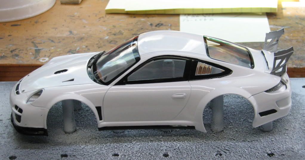

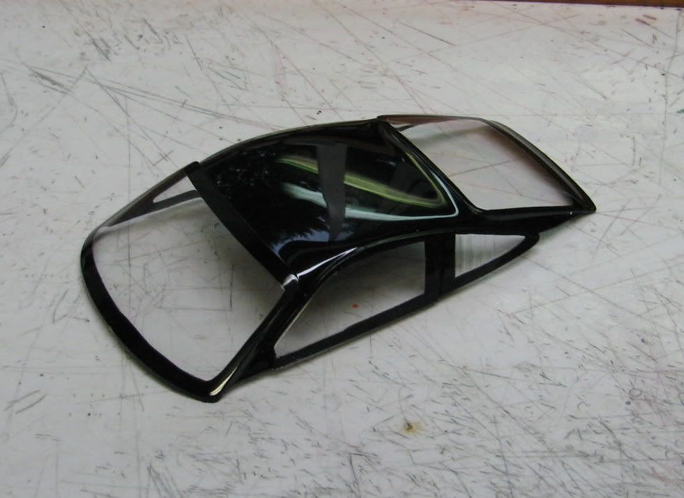

Brendan Posted April 27, 2011 Author Posted April 27, 2011 Hi Brendan, I hope you are doing well. Glad to see you working on this car. I started working on mine last week, but I am putting the decals on! I know it is going to be a lot of work. I was wondering if you know of any after market companies that are doing the window masks for this one. I found a company that does the window masks for the Tamiya GT3. In fact M&S has it. Do you know if it'll fit the Fujimi glass? Seeing yours in the works gives me a lot of inspiration. Hossain Hi Hossain, I don't know of any companies that are making window mask for it. But it was pretty easy to mask the windows out. There's a pretty big step between where the window is supposed to be painted black and where it is supposed to be clear. It's fairly easy to cut the tape to make it work. Also if you need the extra set of decals, I'm not using the set for the B car. Just let me know and I can get it out to you. I'm hoping at some point somebody does some after market decals. Maybe markings of the Racers' Group Cars (Kevin Buckler's team). Here's a picture of my already painted windows. Extremely tight window fit to the body! Watch out for paint buildup.

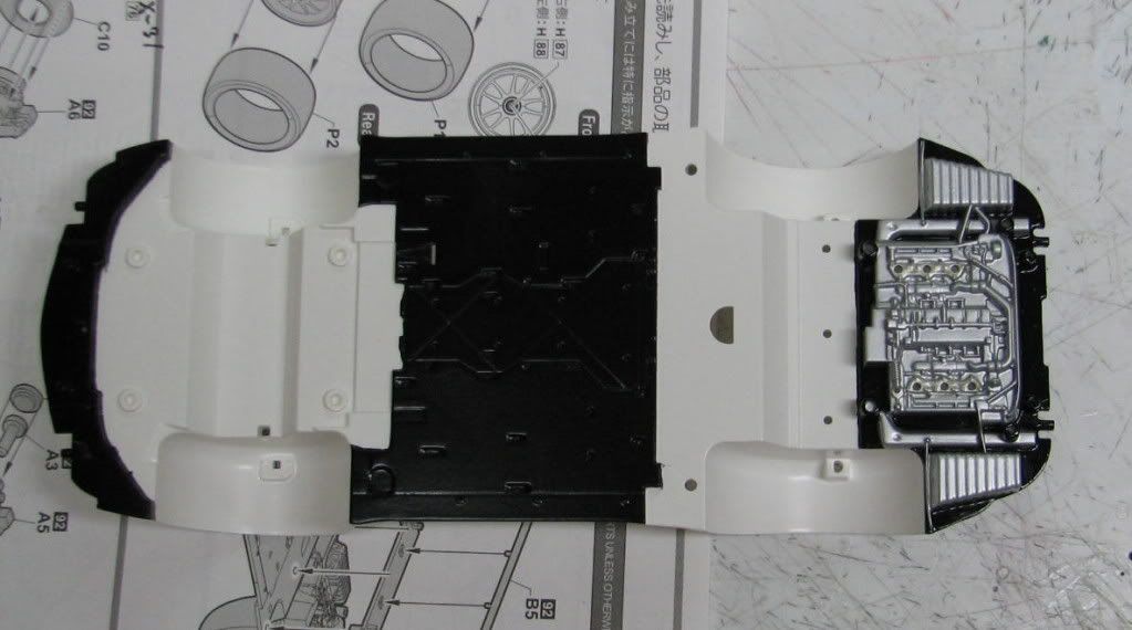

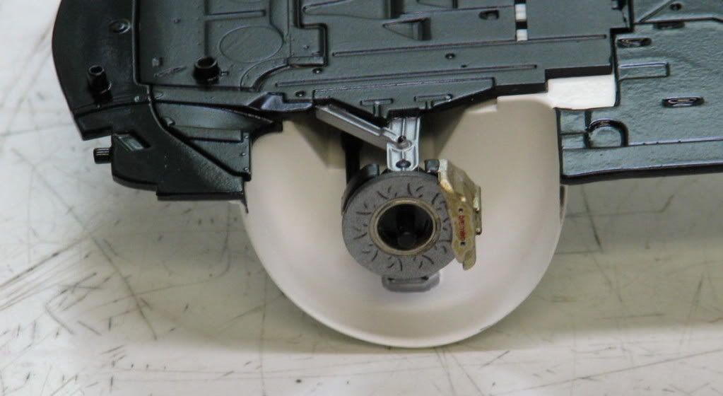

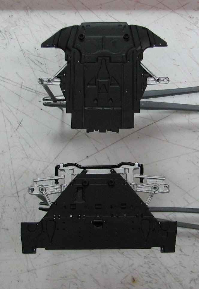

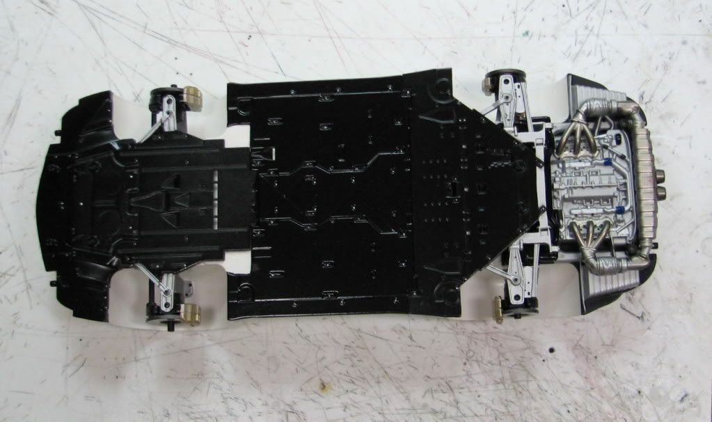

Brendan Posted April 27, 2011 Author Posted April 27, 2011 Got the chassis completed. Fairly easy to put together. Although some issues trying to get the wheels on to the brake assembly. Fujimi did a really tight tolerancing on the kit so paint buildup is a problem. Had to redrill out several of the mounting holes to get get stuff to fit better. Also the front wheel assembly is very fragile. Found out the hard way. Broke the spindle while mounting the rims to the chassis. Chassis painted and all components on the chassis. Area to watch out for...when mounting the tires. Do not use too much pressure as you can break the mounting points off. This is after I fixed the problem. The break happened at the top of the spindle.

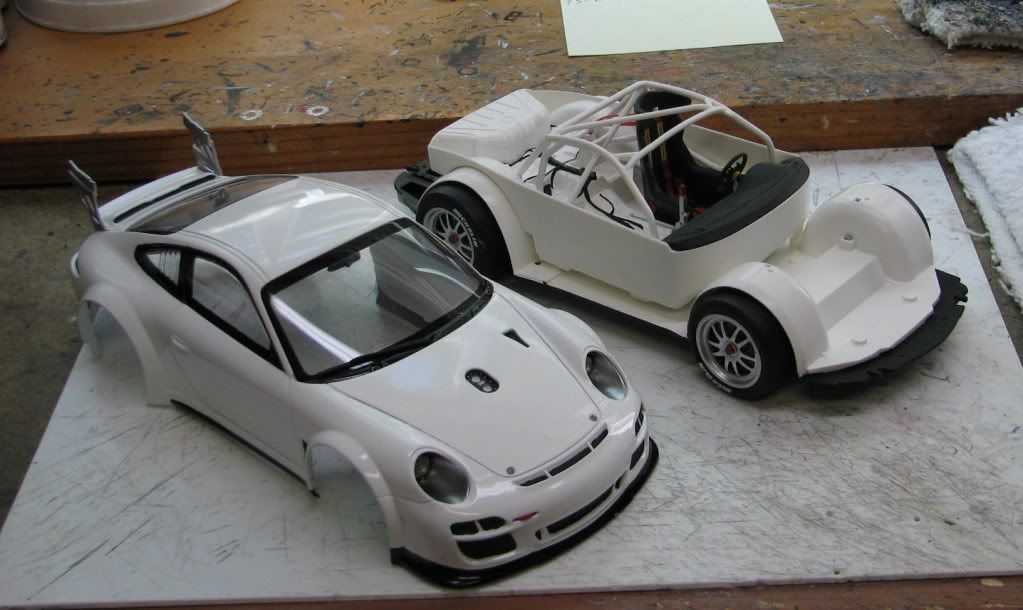

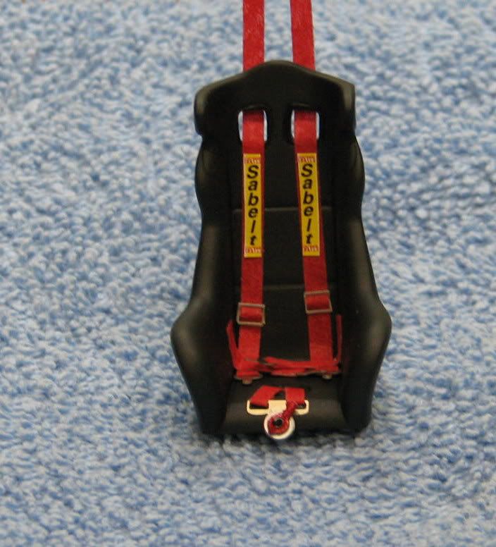

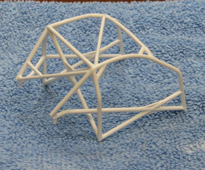

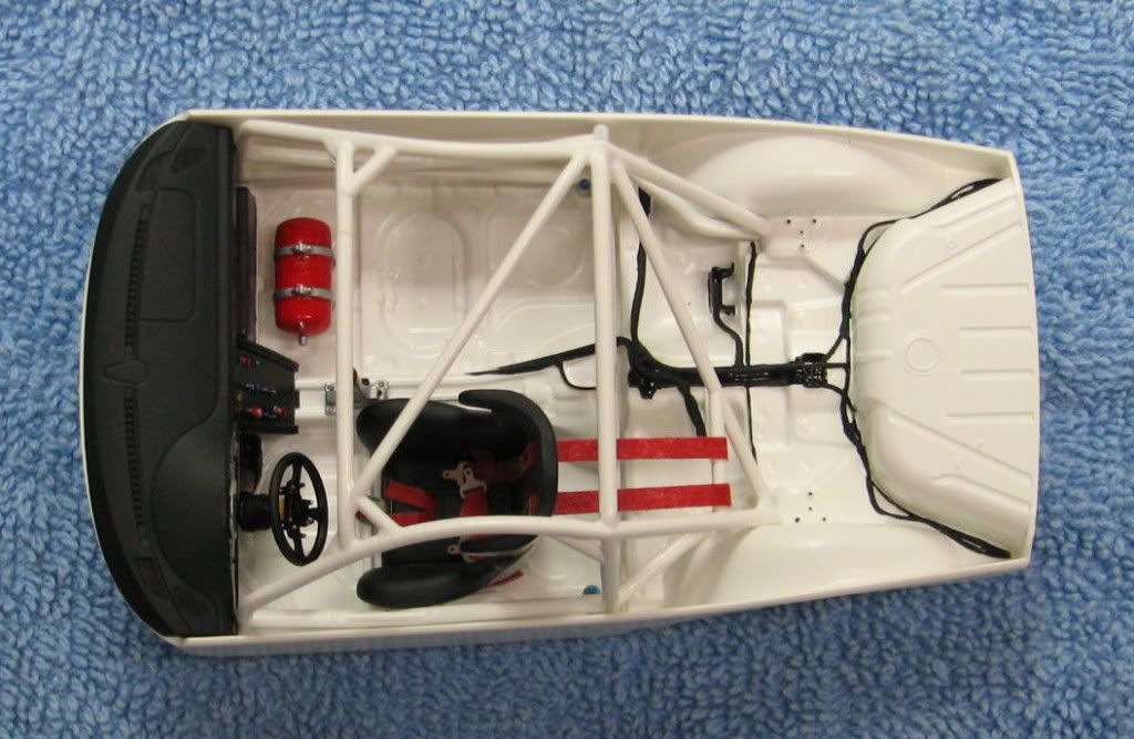

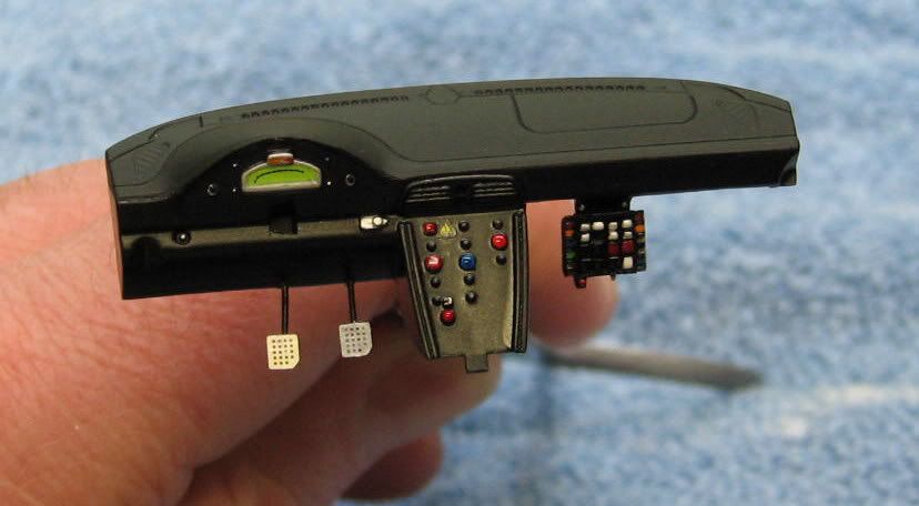

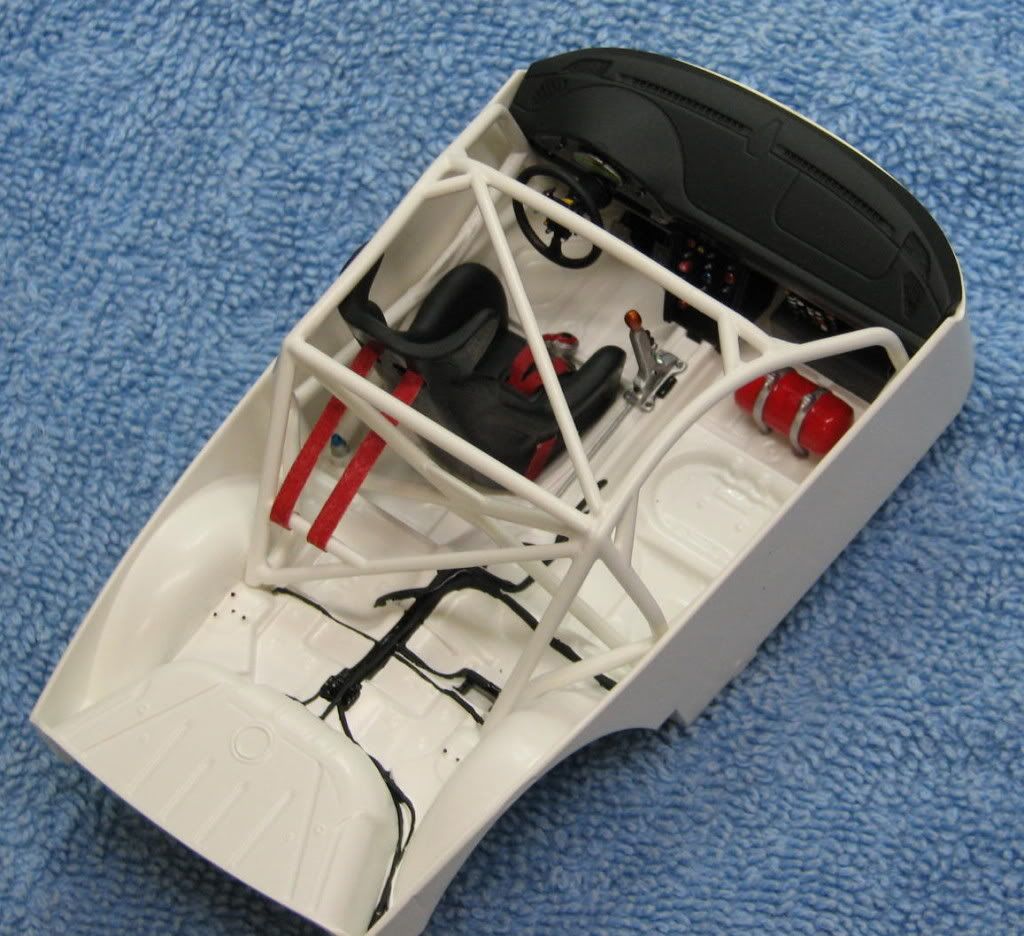

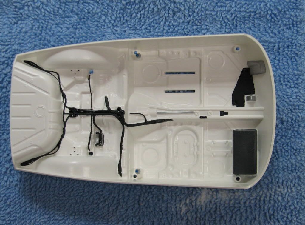

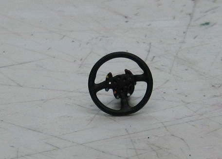

Brendan Posted April 29, 2011 Author Posted April 29, 2011 Got some more work done. Still having issues with painting the body. There's something on the plastic that is not liking the paint. Hopefully I'll have better luck this weekend when I shoot. Finished the roll cage. Had to drill the mounting holes in the chassis a little bigger to accommodate the roll cage. Extremely tight fit. Seatbelts placed on the seat. Dashboard completed. Ended up breaking the pedals off the dashboard so I made my own. Interior painted. Detailed with black and NATO black. Watch out for a slight fit issue between the roll cage and the dashboard. Had to remove the dashboard and install the roll cage first and then the dashboard...contrary to what the instructions say.

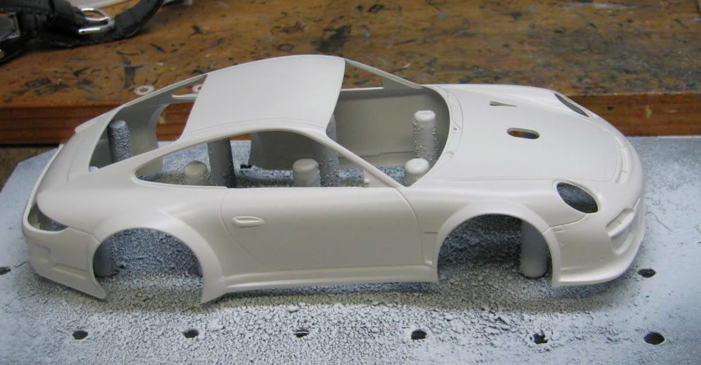

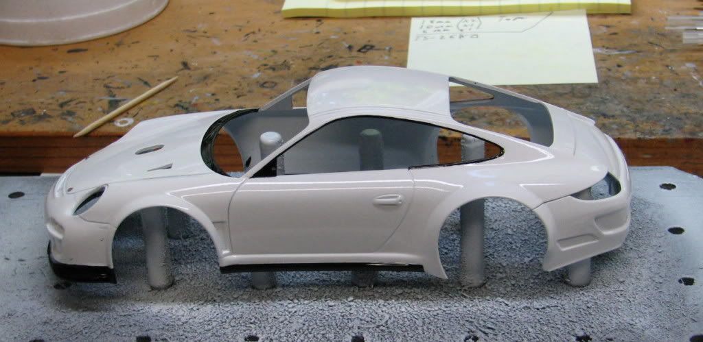

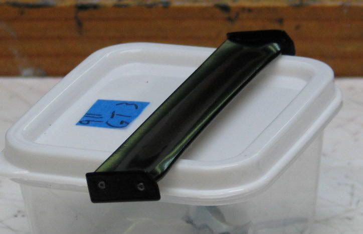

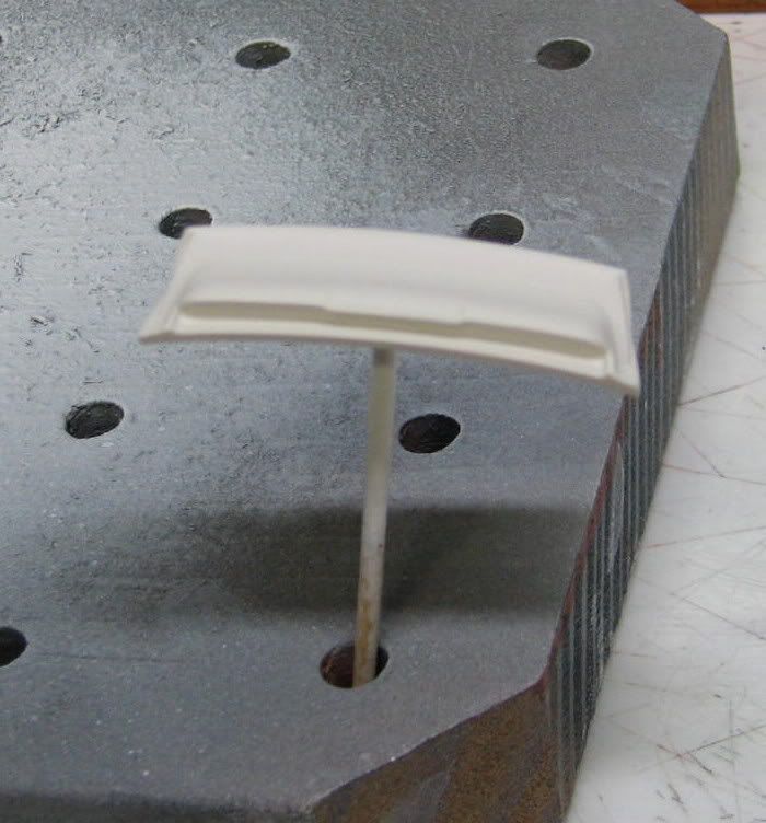

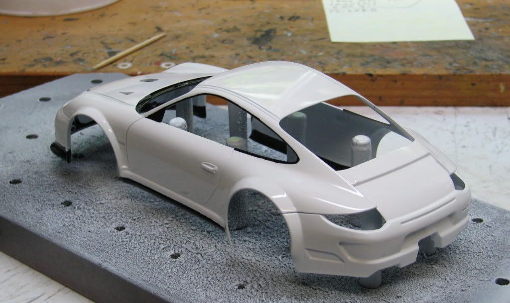

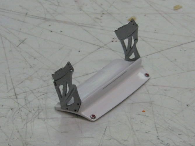

Brendan Posted May 4, 2011 Author Posted May 4, 2011 Finally got the body painted after 6 "screw-ups"...found out what was happening. About 3 and a half years ago, Tamiya had a bad batch of paint and I was lucky enough to have a can of it. Paint had a little too much solvent and was actually eating through the primer. Luckily I had a can of Model Masters Classic White Lacquer. I decanted and airbrushed it on. Still need to paint the black trim on the body. But I'm happy I just got the body painted. Wing painted Tamiya's TS-29. I added photo etch rivets to the end plates.
curt raitz Posted May 5, 2011 Posted May 5, 2011 Looking great Brendan are those aftermarket seatbelts or are they included in kit...real nice? now that explains the "fish-eye" problem i've had with a few cans of Tamiya spray paints, MM Classic White is my choice for a white paint, dang near bulletproof and covers extremely well thanx may have to get one of these kits
Brendan Posted May 5, 2011 Author Posted May 5, 2011 Hey Curt, No, the seatbelts did not come with the kit. The belt itself is actually cloth tape painted with Tamiya's Acrylics. The hardware was from leftover parts. This is a kit that you would definitely like.

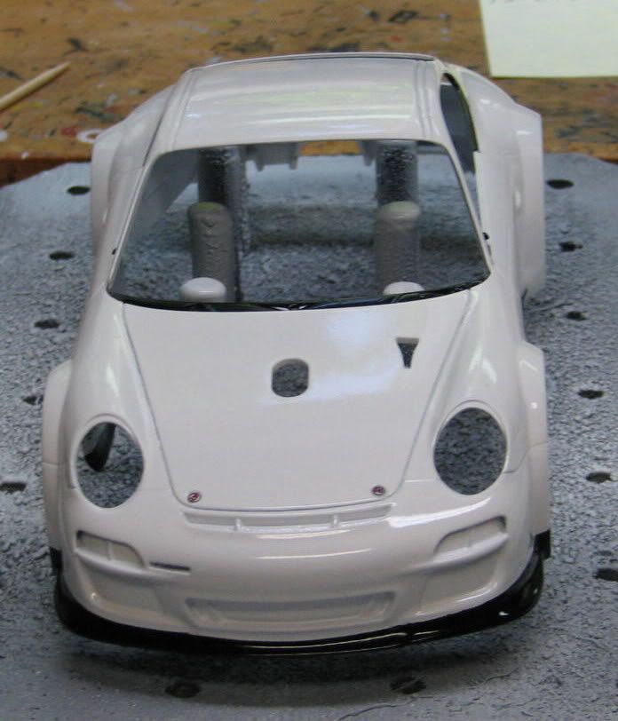

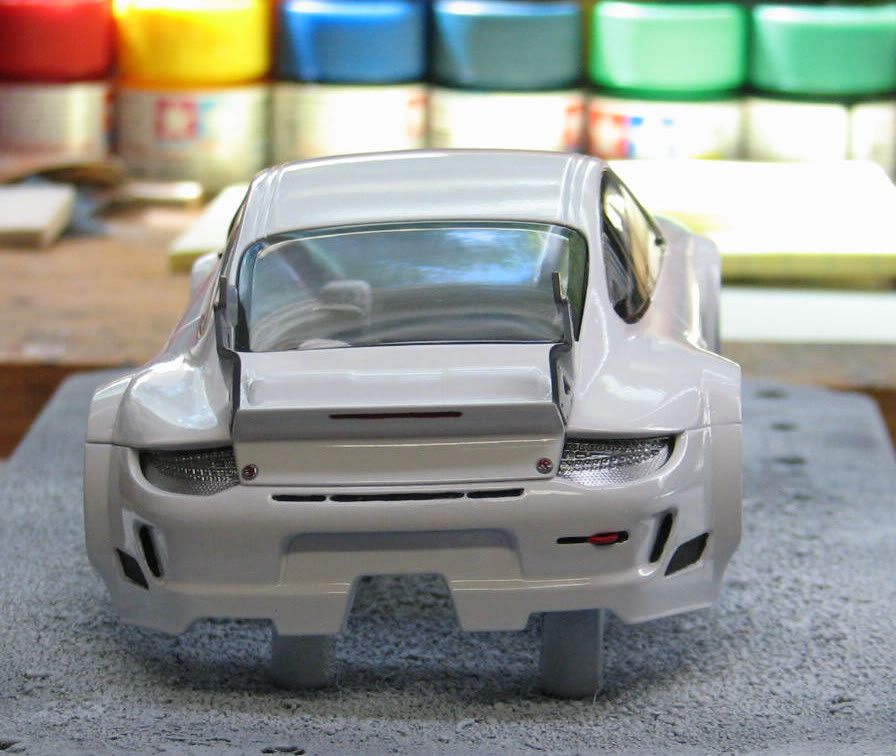

Brendan Posted June 9, 2011 Author Posted June 9, 2011 Sorry I haven't been posting much. Been a very busy past couple of weeks. Race team I belong to did their first 24 hour event in Nevada. Took 17th out of 87. Then had some family issues which kept me gone for a little longer than I had expected. I apologize for not responding to those who emailed me. I will get to it as soon as I can. Here's what I had done before I left. Got the black onto the body. Was a little difficult for the front since there was no line to follow. Had to eyeball it. Wing uprights are attached to the engine cover. Hoping to get this finished in the next couple of days. Still need to do some small detail parts on the body; mainly the grills. Hopefully will be in the under glass section soon if I don't have anything else unexpected happen.
