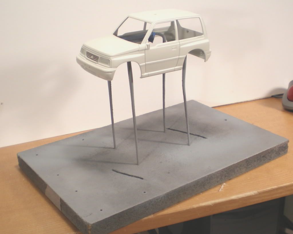

Kaleb Posted May 10, 2011 Posted May 10, 2011 There are a few ways, I dont have pics but some of these guys will, First a jig made of a 2x4 and straight stiff wire in four corners bent at the top to hold the car in place, Second an old wire hanger will also give you a handle Third is the one I use a cylinder( I have an tube from a old firework and I put tape on the top to hold the car or parts in place this next one is for the parts I paint I use a piece of cardboard with tape to hold them in place. Some of these guys also use a 2x4 with gator clips, which I will get to eventually.
highway Posted May 10, 2011 Posted May 10, 2011 I don't have any pictures of them, but what I usually do is bend a metal coat hanger in half using the hook as the bending point so that the ends will act as a spring to hold the body in place. Use some masking tape to secure the body to the hanger, and since it still has the hook on it, hang it up so it won't fall until the paint is dry. Easy, simple, and you have the paint stand done in just a second or two. If you want a little more permanent stand, you can use a 2x4 or something similar, you can take some old hangers and bend them to an "L" shape, and drill the block of wood to accept the top of the "L" of the coathanger. You could also make them with a bracket " [ " shape between the two "L" shaped legs per side, and that will hold almost any body at the doors, and use some masking tape again to secure to the stand, or rubber tubing on the long part of the bracket to keep the body from slipping. It would look like this from the top, [ ] with the legs going down into the block of wood. By the way, since you didn't say if it was the reissued 1/16 scale General Lee or not, both methods would work in any scale, but the more permanent stand would have to be built for the larger scale so it would be large enough for the larger body. One for a 1/25 scale just wouldn't be wide enough for a big body.

RodneyBad Posted May 10, 2011 Posted May 10, 2011 and the coat hanger thru the wooden base is a nice one.

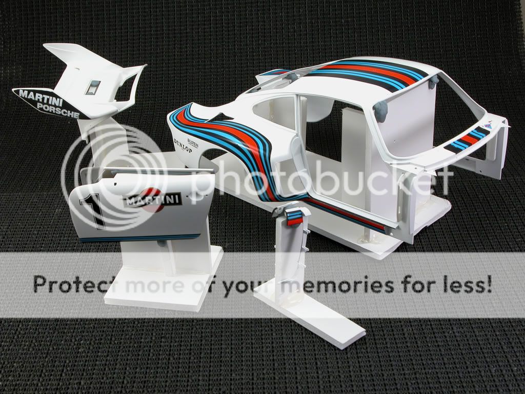

Pete J. Posted May 10, 2011 Posted May 10, 2011 I use a little different method. I make individual stands from foam core and glue them up with hot glue. The parts are stuck to the stand with blue tack. The part generally stays on the stand throughout the build. That protects it from my own clumsiness and bench scratches.
ra7c7er Posted May 10, 2011 Posted May 10, 2011 I use a little different method. I make individual stands from foam core and glue them up with hot glue. The parts are stuck to the stand with blue tack. The part generally stays on the stand throughout the build. That protects it from my own clumsiness and bench scratches. With a bit of finish work on the stands and a different way to attach the parts your stands would make really cool stands for an "exploded view" model.

Pete J. Posted May 10, 2011 Posted May 10, 2011 With a bit of finish work on the stands and a different way to attach the parts your stands would make really cool stands for an "exploded view" model. Hmmmmm, never thought of that but you got the wheels turning! Thanks.
ffreak Posted May 10, 2011 Posted May 10, 2011 I used to use the paint cans and folded over tape method, until I kept having trouble with the bodies falling off and ruining the paint job. Then I made the 2x4 stand with coat hangers. That worked forever and you could always bend the wire to adjust the tension. Then I bought the tamiya stands and the other tool that Bob was showing you. Those are my favorite by far but I occasionally go back to the 2x4 deal. There's always room for ingenuity in this hobby and I love the different methods we all use for a better mousetrap !!
shatteredsoul76 Posted May 10, 2011 Posted May 10, 2011 I also use the Tamiya paint stand set and while they work great and hold the parts nice and tight I find that they sit a bit too low on the craft table I use and it makes it hard to airbrush the bottom edges of the body. I do like the taller stand that Rodney has pictured and I will probably make me a couple of those, if for anything else, just to get some room to spray the bottom easier.
