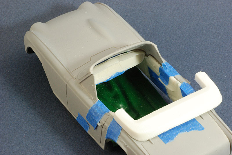

Foxer Posted July 5, 2011 Author Posted July 5, 2011 (edited) More interior fitting with the wheel wells in place today. Lots of grinding again, but it's very close and I'm happy with how it should end up. The dash needed a lot of grinding but this resin disappears fast with a sanding drum on the Dremel and set at 6000 rpm! Resin is nice to not melt under heat. The windshield was scored on the dash as seen in the photo in pencil. I ground it away to about a sixteenth of an inch and it's about right. I'll probably be adding small plastic pieces to close the fit of pieces and construct the floor right on the frame. The convertible top boot from a '51 Chevy will need to be cut down in width and also sanded to reduce the thickness and shaped but I think this is going to work. After all that I will need to find a way to get the vinyl texture back. Maybe a vinyl top material. Edited November 18, 2017 by Foxer
crazyjim Posted July 5, 2011 Posted July 5, 2011 You may want to try spray adhesive for the top boot. Hold the can relatively far form the boot (18-24"). Spray it on, let dry, spray semi-gloss black, done. Looks pretty good and is relatively inexpensive.
Foxer Posted July 5, 2011 Author Posted July 5, 2011 You may want to try spray adhesive for the top boot. Hold the can relatively far form the boot (18-24"). Spray it on, let dry, spray semi-gloss black, done. Looks pretty good and is relatively inexpensive. That sounds interesting. I have some textured paints I was considering, but spray adhesive ... now where's that 3M can to try out.

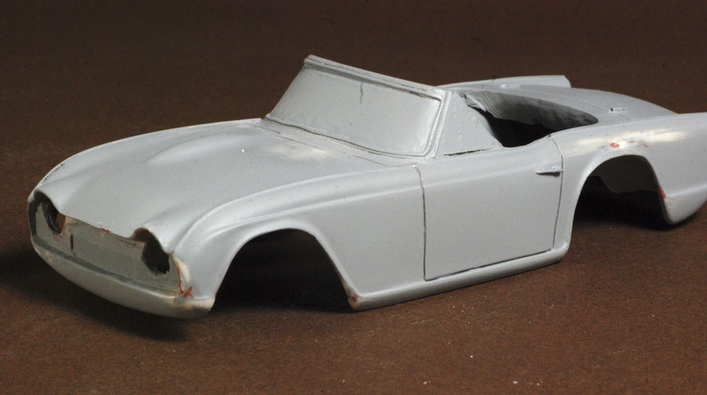

Foxer Posted October 19, 2014 Author Posted October 19, 2014 (edited) Thanks for the comments resurrecting this . ehhe . I DO look at this every once in awhile as it sits waiting for my attention. The thing that stopped me is figuring how I can do the front fender light turn signal light shroud that is at the front of the side chrome. Here's some photos I've gathered .. nice ones of a piece on sale on ebay ... I thought I could just make a couple out of plastic sheet and rod but I'd love to hear any suggestions. It's probably a good idea to post this question in the qestion forum .. maybe later today. . Edited November 18, 2017 by Foxer
chunkypeanutbutter Posted October 19, 2014 Posted October 19, 2014 Might have to make a squared up basic shape of it and then round it where appropriate.

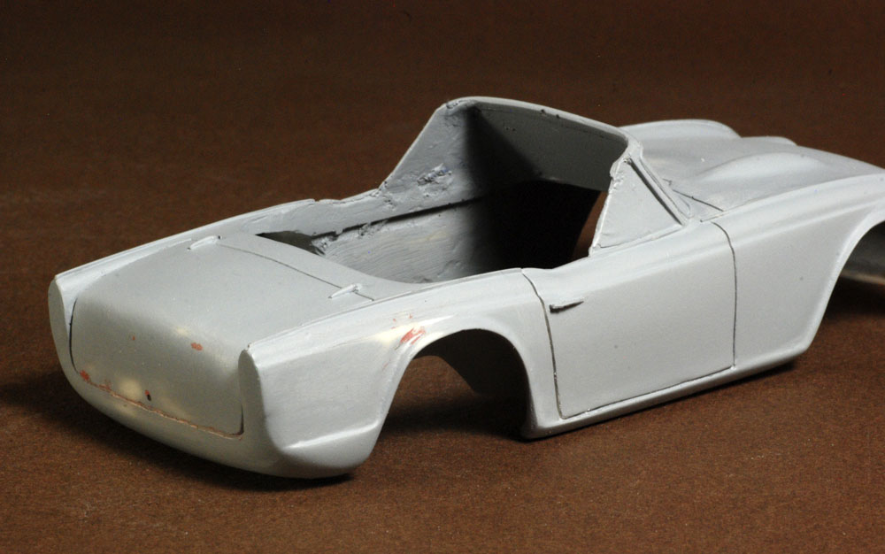

Foxer Posted August 9, 2015 Author Posted August 9, 2015 (edited) Coming up from the grave ... I did more to progress the turn signal pods as far as how I'll do it. Going to just carve it out as chunkypeanutbutter suggested. I had to epoxy with fiberglass cloth to patch an area that got too thin with my grinding out the body. While putting 2 part bondo over the thin area I added some around the very crude trunk lower panel line. It looks like it did some to smooth it out but will need more I see. Needs some primer to really see whats left, thou. The chassis got primered and will be needing some side pieces to close into the TR4 body. I also started making a convertible top boot as the one I cut down from a '51 Chevy is too narrow and shaped wrong. Edited November 18, 2017 by Foxer

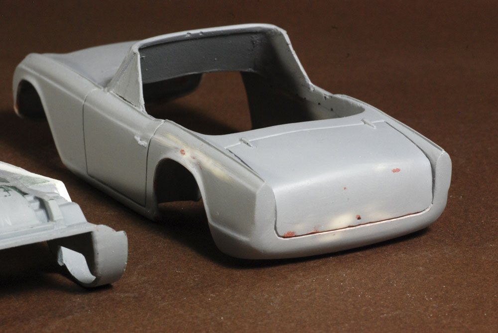

Foxer Posted August 12, 2015 Author Posted August 12, 2015 (edited) Continuing to patch small areas on the body as they show up under primer. The bottom of the trunk lid is getting there .. I think it is very close now and will see with some more primer. There are some panel lines still needing the scribers to define better for applying BMF first. I want to document well what it takes to get this very early Air-Trax TR4 resin kit up to snuff. So excuse all the photos with little change. Be assured their newer bodies are VERY good! The TR3 chassis had some .06" widening pieces epoxied on with glass cloth reinforcement. It fits really well now. Next step is to get the stance right now that the chassis is a drop in fit. Edited November 18, 2017 by Foxer
