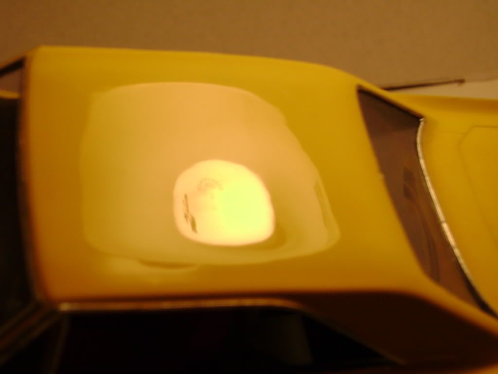

RickRollerLT1 Posted June 18, 2011 Posted June 18, 2011 Krylon paints can be good if you use the right paint and primer underneath...but do not use their primers on bare styrene as they craze the plastic and is near impossible to strip off. I use sears gray primer, folowed by the color desired coat of wal-mart/colorplace paint, then the krylon color of my choice. Then I polish the painted body with white toothpaste, and I tackle it with 1 or 2 coats of pledge future floor wax with a foam brush. Doing this get very nice results with out having to deal with nasty clear coats, bad testors enamal sprays, or crazing for that matter. Though sometimes, I find that if you put a coat of sears primer as a sealer coat first, then applying krylon or any other brand primer ontop, you'll get even better coverage and a smoother serface for the next color coat to bite onto with out having any crazing issues whatsover. Here's some of my cars I painted using the krylon paints using these methiods, which were polished and futured. The '41 Ford Woody was painted in Banner Red & the '61 Impala in Leather brown w/ Boot Tan on the interior. The '64 Thunderbolt is painted in True Blue & the '68 Dart HEMI (which you've all previously seen) is in Sun Yellow

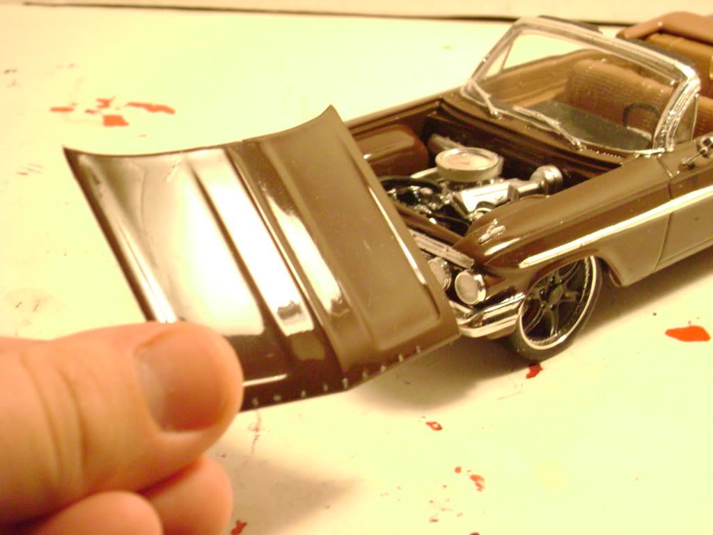

Drake69 Posted June 26, 2011 Posted June 26, 2011 Krylon primer will never touch another model kit of mine, and if I decide to venture into Krylon paint colors I will make doubly sure Duplicolor sandable primer will be protecting the plastic first. I almost lost a good build due to Krylon primer, even after cleaning and prepping the body beforehand. NEVER AGAIN.

RickRollerLT1 Posted June 27, 2011 Posted June 27, 2011 (edited) As i've previously mentioned, the krylon paints are good as long as you use a different primer and base colorcoat undeneath...and avoid their primers and clears! I seemed to have really bad luck with the primer as it crazes all bare styrene it touches. Along with their clears (any tipe; even the crystal clears) as it melts through the paint & primer, and attacks the plastic so bad it's impossible to strip off!! Even their clear on the krylon color topping with the wal-mart paint and the sears primer coat underneath still did it! Also, I've heard most krylon paints WILL melt through Tamyia and Testors primer coats and eat up the plastic. So like everyone else said, use a good primer (sears, duplicolor, plastikote and etc), do good prep work and you'll be OK. One time when I desprately needed a flat black 'kauz the wallymart waz out of it'!!, so I had to resort to krylons flat black. I tired it on a test part, ans BOY let me tell you something! on bare plastic it WILL melt some parts of the plastic!! and gives you that effect of when you applied too much glue to the underside of a part and it makes a pit/dent in it! Talk about ultimate he-double-hockey-sticks!! But luckly it was on a spare hood that I had OVER 9000 spares of (sorry, just had to get that famous DBZ line out). Edited June 27, 2011 by V-spec
