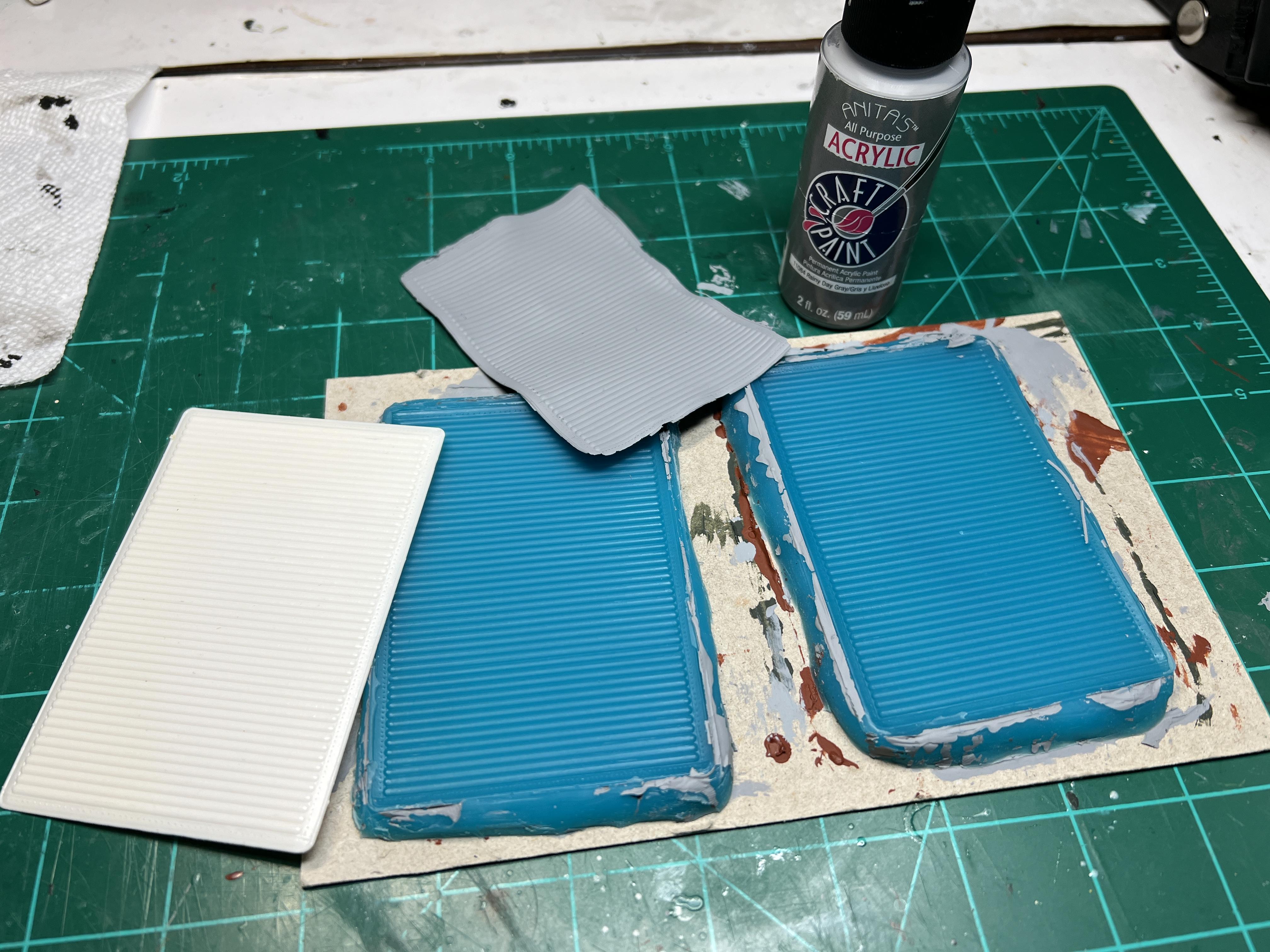

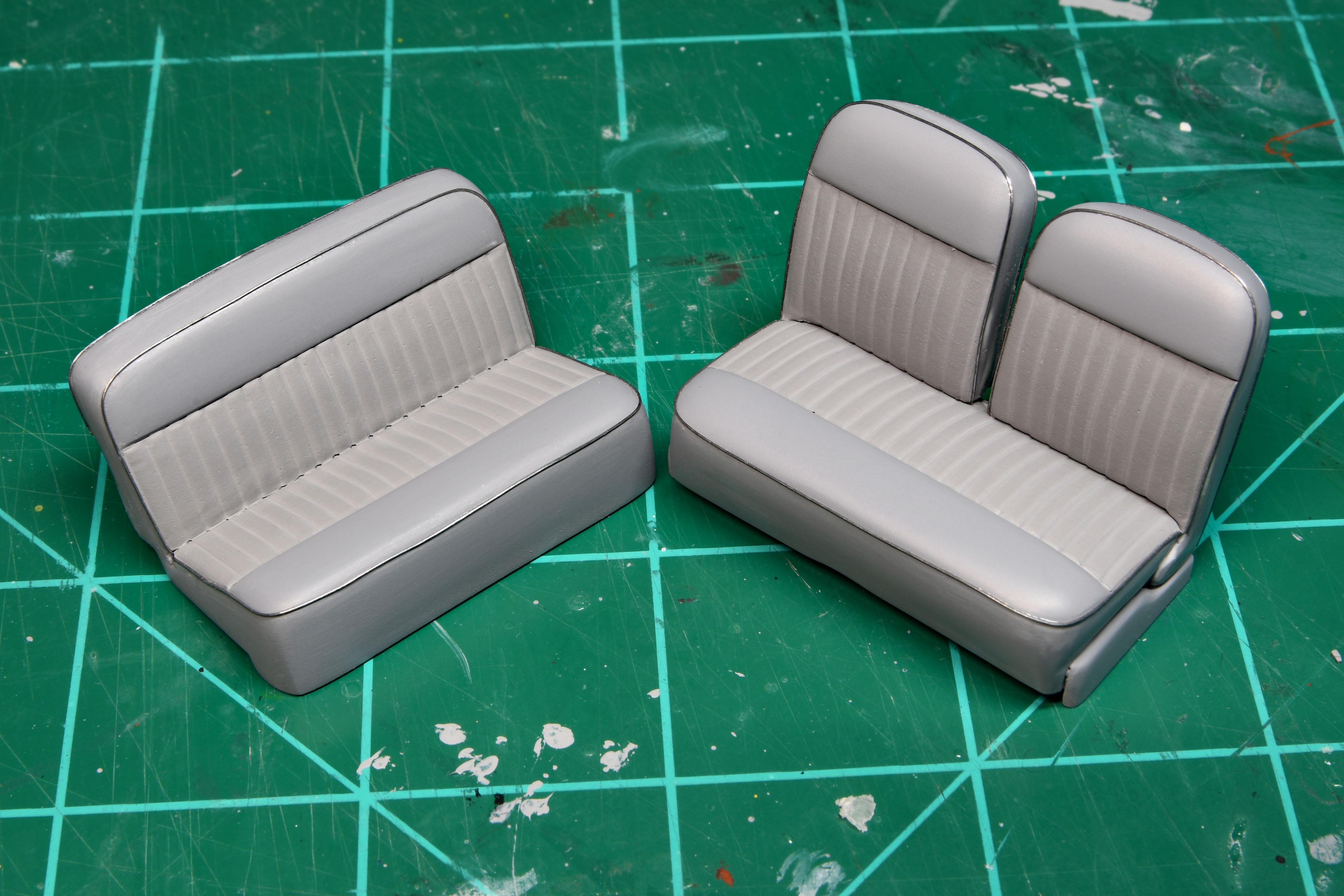

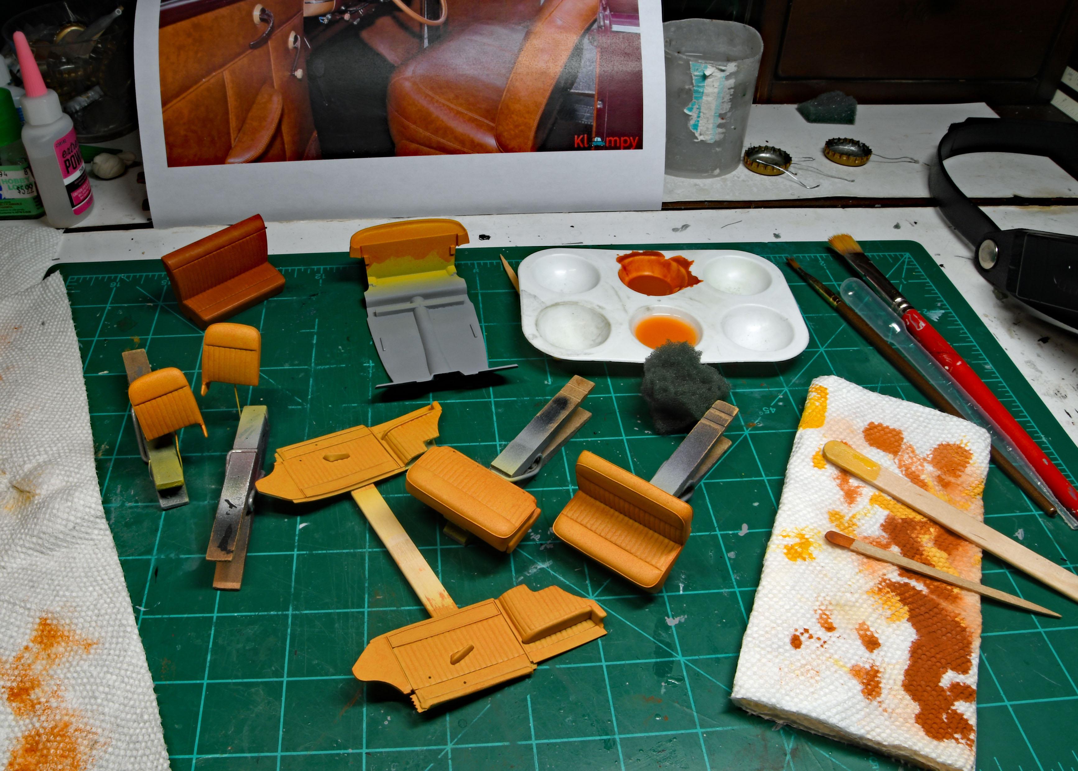

sbk Posted April 28, 2022 Posted April 28, 2022 (edited) Later on I get into some of the stuff Bernard mentioned up above. At this stage, I poured craft paint into a toneau cover mold to make the tuck & roll material. Then, the various pieces were cut into shape & glued in place with watered down Elmer's glue. . 32 ga. bead wire was superglued in place to represent the piping. The leather base coat was Acryl Gelb RLM, but any sort or yellow ochre color should work. After that, I started sponging & stippling thinned layers of Americana acrylic craft paint. The colors I used were Traditional Burnt Sienna & Cinnamon Stick. Between coats I sprayed Acryl semi-gloss clear to seal the previous coats. The photo in the background shows the look I was aiming for. There's also a test seat in the background to work out my colors. That one came out a bit dark. When I was satisfied with the overall look, I sprayed quite a few more coats of semi-gloss clear. The paint on the body still needs to be polished out. Edited April 28, 2022 by sbk 6
NOBLNG Posted April 28, 2022 Posted April 28, 2022 Wow! That is a truly fantastic looking job Steve. 2

iBorg Posted April 28, 2022 Posted April 28, 2022 Amazing work in this thread.....wow. Steve's work is the best seats I've ever seen in a model. I'm curious as to how you made the tonneau cover upholstery. What paint did you use? 1
restoman Posted April 28, 2022 Posted April 28, 2022 7 hours ago, iBorg said: Amazing work in this thread.....wow. Steve's work is the best seats I've ever seen in a model. I'm curious as to how you made the tonneau cover upholstery. What paint did you use? I'd be interested in hearing more about it, too. 1
Bainford Posted April 28, 2022 Posted April 28, 2022 Cheers, Steve. That is about the nicest 'leather' I've seen. Very impressive, thanks for sharing. 1
sbk Posted April 28, 2022 Posted April 28, 2022 16 hours ago, iBorg said: Amazing work in this thread.....wow. Steve's work is the best seats I've ever seen in a model. I'm curious as to how you made the tonneau cover upholstery. What paint did you use? Thanks! The cover is from an old AMT Ford truck kit, ('61?) but the cover from the AMT '59 El Camino may be easier to find. The mold is made like a typical silicone mold for resin casting. I've had the best results with Anita's craft paint. Tons of colors available & pretty cheap. I pour the paint into the mold, spread it around, & try to get most of the air bubbles out. After a day or two, I remove the piece & set it aside. I pour more to have extras in case of surface air bubbles or a miss-cut piece later on. Since I was going to paint the entire seat, I used a color that was similar to the gray primer so that the paint coverage would look even. The great thing about using craft paint inserts is that it's easy to do two tone upholstery by using contrasting colored inserts. Paint the seats one color & use a different color craft paint for the inserts. If you go to FB, I have a step by step. If you start on the photo in the link, I have 9 photos with captions explaining the process. https://www.facebook.com/photo/?fbid=192070664231320&set=a.148890918549295 3
