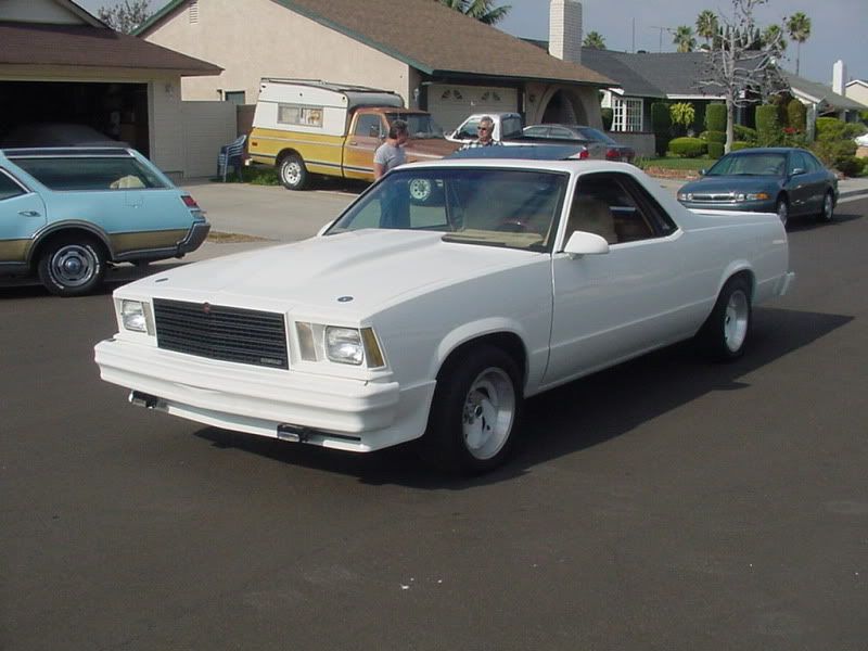

Steve Keck Posted July 14, 2011 Posted July 14, 2011 My '79 ... ...has electric solenoids to activate the latch and a spring to pop the door open about two inches. I have a hidden external switch to activate the driver's door as well. I use external locks for the fiberglass hood so no cable is necessary. The electrical solenoids have been working without problems for 12 years. Now I'm having mechanical issues with the original equipment latch not holding the door closed.

samdiego Posted July 14, 2011 Posted July 14, 2011 (edited) My '79 ... ...has electric solenoids to activate the latch and a spring to pop the door open about two inches. I have a hidden external switch to activate the driver's door as well. I use external locks for the fiberglass hood so no cable is necessary. The electrical solenoids have been working without problems for 12 years. Now I'm having mechanical issues with the original equipment latch not holding the door closed. That Vista Cruiser is bitchin' on those rally Rims! Edited July 14, 2011 by samdiego
Scale-Master Posted July 14, 2011 Posted July 14, 2011 are you at Mark Jones house? How did you deduce that is my house Dave? I just noticed you can see my late Golden Lab Rocky through the back side windows of the Vista Cruiser... I sure miss that dog. And thanks Sam, I "loaned them to it" from my Camaro for a while. It drove way better on the 15 inch Rally rims than the stock 14s with skinnys.
