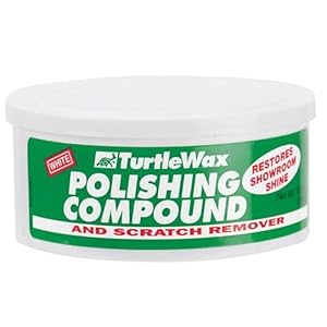

Tonioseven Posted September 24, 2011 Posted September 24, 2011 Could you post a picture of the item (s) in question?
crazyjim Posted September 24, 2011 Author Posted September 24, 2011 Turtle Wax polishing compound. It comes in a round, white plastic container. The actual compound is white.
Longbox55 Posted September 24, 2011 Posted September 24, 2011 If you have the white compound, it's the finer of the 2. There is also a rubbng compound paste in a similar can that's more agressive. It is a reddish color, about the same color as red oxide primer, and the can has a red label on it. It is also a dryer compund that the white version.

LoneWolf15 Posted September 25, 2011 Posted September 25, 2011 Jim , I would say that the Turtle Wax would be more abrasive than the Novus 2 from past experience . I know for a fact that it will chew an enamel paint job up in half a heartbeat . The Novus 2 , on the otherhand , is great with the enamels. Donn Yost

crazyjim Posted September 26, 2011 Author Posted September 26, 2011 Well Turtle Wax bummed me out. I talked with 3 different people and none of them could find the grit of their polishing compound. Novus on the other hand was terrific. Novus #2 is 1200 grit and Novus #3 is 600 grit.
