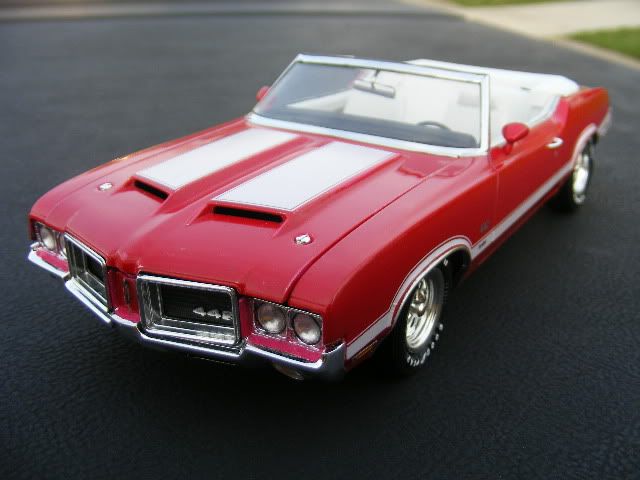

71drolds Posted September 25, 2011 Posted September 25, 2011 since i own a 1:1 car like this, i get particular about the details. one thing that i havent seen anybody do right yet, is the paint around the headlight bezels. while the kit has the whole grill/headlight/bumper piece in chrome, the area between the headlights and the bumper and the headlights and the grills should be body color like this. doing it this way really adds some depth to the front end and keeps it from looking like one molded piece. also, if your doing a '71, the headlight bezels should be all chrome. if its a '72, they should have flat or matte black insets. this is true wiether its a cutlass or a 442. i just thought with the popularity of this kit, some of you might want to know this.
71drolds Posted September 25, 2011 Author Posted September 25, 2011 another tip, for 1971 442's, the grill is black with a silver shell. for 1972 442's, the grill is silver with a black shell. if anybody has any questions about these cars feel free to ask as they are kind of my passion.
