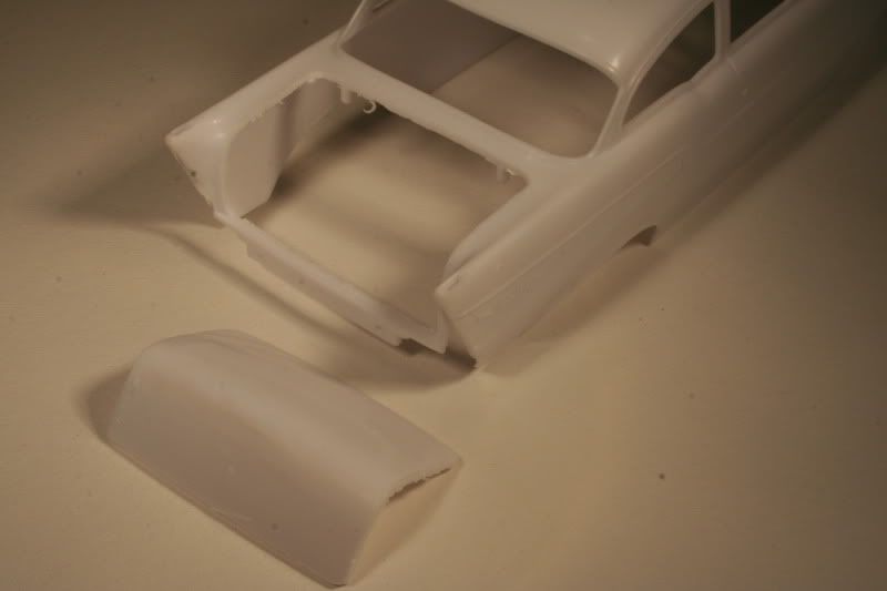

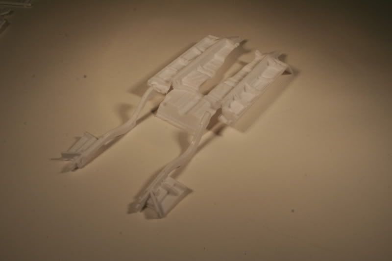

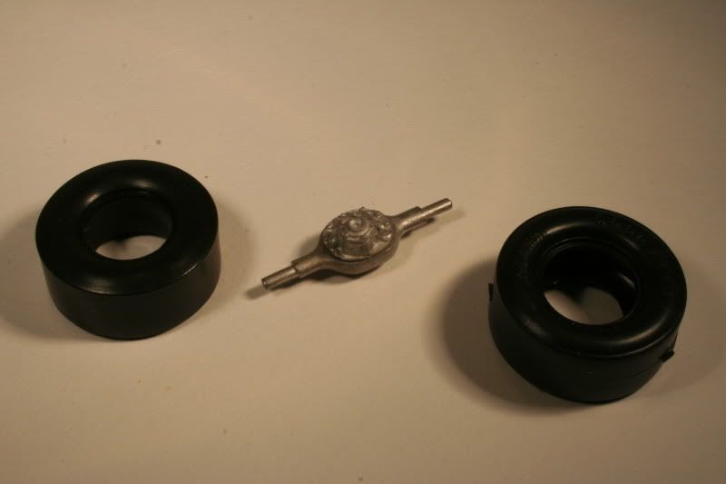

Andrew Posted November 3, 2011 Share Posted November 3, 2011 After starting the thread in the drag racing about British Gassers, thought I had better actually start the build of this one! The real one is on the left! (i hope to do honky Tonkin later). I started with the Revell kit and gathered a few bits, MCG etch set, steering wheel, R and D Unique 9" Ford and a couple of types of slicks. I have a good shot of the inside of the trunk (boot for us Brits!) so I have cut the lid out using the back of an xacto - just needs cleaning up The chassis rails are narrowed at the rear so I had a lot of cutting to get the rails seperate! Sorry about the pics of a white car on a white background, just what I had to hand, I'll change to blue next time! Quote Link to comment Share on other sites More sharing options...

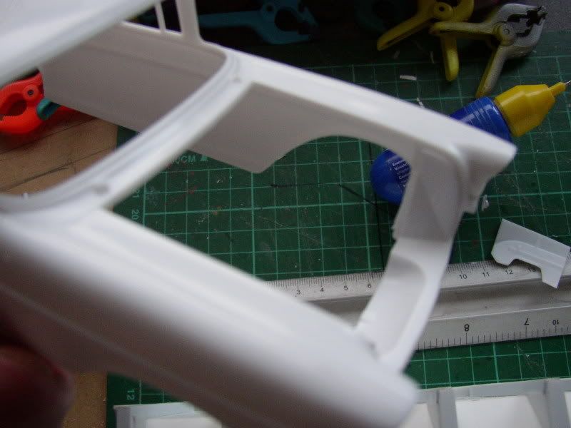

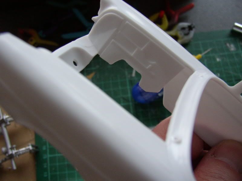

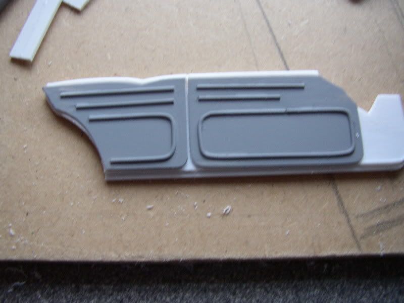

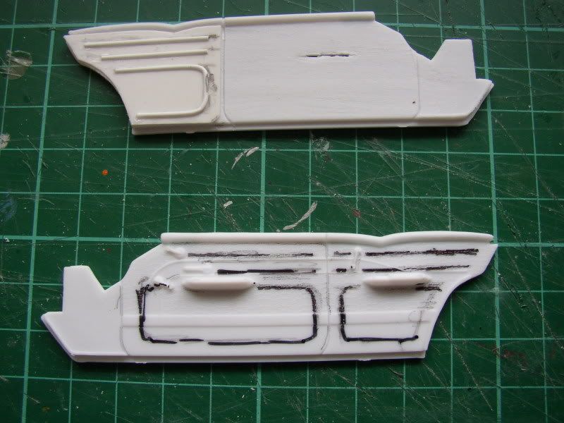

Andrew Posted November 12, 2011 Author Share Posted November 12, 2011 Just a small update I'm afraid, trying to get a truck done too! Got the inner wings cut out Before After and also sanded and cut all the interior door detail away as the Rat has ally panels with bead rolling, so I used 20 thou plastic sheet and half round rod to replicate this. Quote Link to comment Share on other sites More sharing options...
