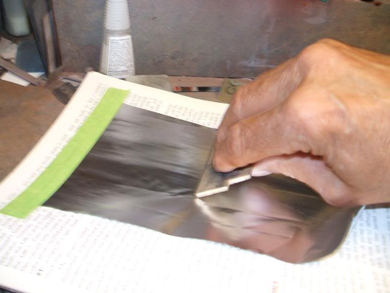

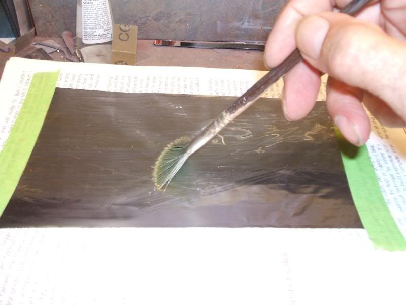

Guest Gramps-xrds Posted November 11, 2011 Posted November 11, 2011 I've been using gold lief sizing for several yrs with cheap aluminum foil and I think it works great and it's a lot cheaper than BMF. I can't tell the difference between the cars I used BMF on and the ones I used foil on. The only down side ta using sizing ( well it's not really a down side) is ya have to wait about an hr or so for it to set up. I can make however much of it I want at the time. I tape some foil to a clean shiny page of a magazine and brush on the sizing. It will level itself out to a smooth layer. Once it tacks up you just cut a strip and apply it like BMF. Any adhesive that sticks to the model will clean off with some lamp oil and a cloth. Lamp oil will not hurt any paint finish. Lamp oil will also make it easier ta cut the foil if you brush some over the foil before you start cutting.
Jeff Johnston Posted November 12, 2011 Posted November 12, 2011 (edited) Wow Gramps...you are right you can't tell its not BMF. Also I imagine the foil is stiffer which would be great on straight lines like the trim on the side of that car. I love it...ya learn something new every day here. JJ Edited November 12, 2011 by Jeff Johnston

Guest Gramps-xrds Posted November 13, 2011 Posted November 13, 2011 You make it look easy and the results are excellent. I've been wanting to do something with the varigated gold leaf with a paint job . . . Virge if you use the variegated gold, you'll have to apply the adhesive to the model and stick the foil to it. The foil is far to thin to put the adhesive on it.
