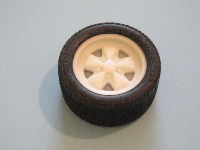

Casey Posted November 12, 2011 Posted November 12, 2011 Which wheel are you trying to copy? Post a pic if possible, please. That will help determine how you should be casting copies.
whale392 Posted November 12, 2011 Posted November 12, 2011 ^^^ VERY NICE cast wheels, so he would be the guy to listen to on advice^^^
GeeBee Posted November 12, 2011 Posted November 12, 2011 If the original wheel has a recessed back, you would be better off making a 2 piece mould, takes a little longer, but you'll get better results.
Keef Posted November 12, 2011 Posted November 12, 2011 ^^^ VERY NICE cast wheels, so he would be the guy to listen to on advice^^^ i agree Casey does make some VERY nice wheels

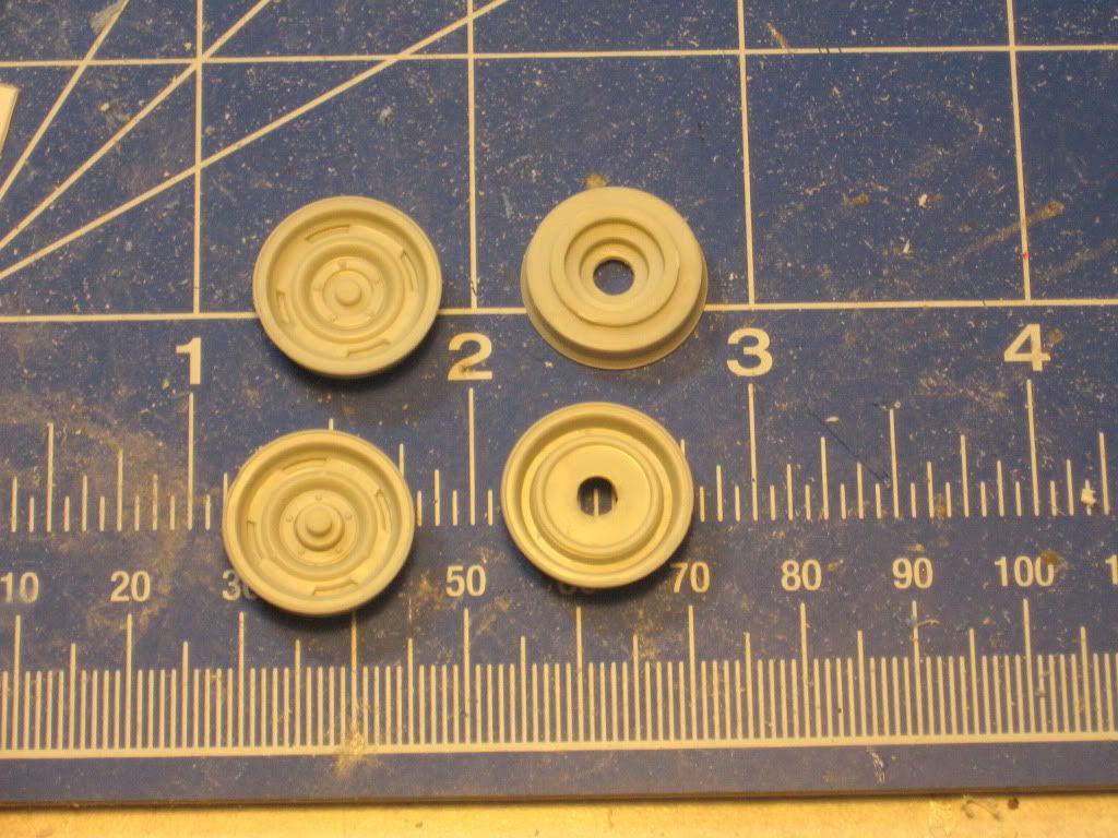

steve7119 Posted November 12, 2011 Author Posted November 12, 2011 Thanks everyone! Wheels are from the Hogan's Heros Jeep. I will post pics tomorrow. Steve

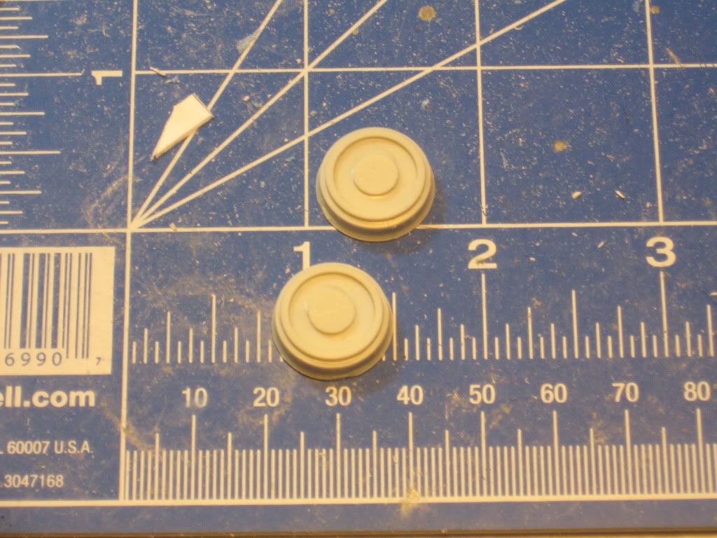

steve7119 Posted November 12, 2011 Author Posted November 12, 2011 Here are the photos! Thanks Again for all your help

Greg Wann Posted November 13, 2011 Posted November 13, 2011 I only make two part molds. Small parts like wheels and dash parts, etc, I mix up a small amount of silicone and pour it in the detail and run it through my vacuum chamber a few times. If I just put in a little and let it set it just about always gets a tiny air bubble in it and in this scale it looks bad. You could put just a drop of silicone in to start out with. Take a tooth pick and baby set it until you are certain no air bubbles still exist. Let the silicone cure completely and then build up another layer until you get what you want from it. If you don't do this or have the equipment to vacuum it a tiny bubble will form next to some detail. When you make the resin part a tiny bump of resin will appear on your part. Most of the time they will remove very easily because it is round it should knock right off I have also experimented in the beginning to correct molds that have had air bubbles in them. It is a tedious task. I have used super glue, silicone grease and of course the silicone I use to make the mold. Resin casting is a huge learning experience. It takes a good bit of equipment and space to do it in. I have built a good bit of shelving to store molds on too. I would like to see how Modelhaus stores and keeps track of his molds. That in itself is a big task.
shucky Posted November 13, 2011 Posted November 13, 2011 (edited) Wheels are easy. Steve, the simplest way would be to file the back of the wheel flat (so remove the lip on the back of the wheel). You'll also want to do this to the wheel back (inner wheel) which you also posted pics of. Then, simply make a one piece mold of these. If you want to avoid bubbles or any imperfections on your cast piece simply take a small paint brush and brush on a layer of silicone mold making rubber on to your master to ensure there are no trapped air bubbles. Afterwards simply drizzle in your silicone rubber into your mold and let it cure. I've done this countless times with flawless results. If you want the back of your wheel (and wheel backs) to be flat and clean when cast simply pour in your casting resin into the mold and place a piece of 1/4 inch glass on top of the mold (carefully). You can watch the resin cure through the glass and when fully cured carefully pull the MOLD from the glass. Your cast wheels (or whatever) will now be stuck to the glass. Simply use a flat razor blade and work the finished resin edges free from the glass. You now have perfectly clean cast wheels with perfectly flat and clean backsides. This technique works best if you mist your piece of glass with mold release prior to setting on top of your mold. Every couple pours its best to spray a lil more mold release on the glass to make it easy to remove your resin pieces. Thats how I would do it. It would give you the best results and its the easiest. A two piece mold would be extra work and the only point of that is to have the detail present that is on the BACKSIDE of the wheel. However, there is normally no point to this because you cant see the back side of a wheel once its placed in a tire. Of course there are lots of other tips and tricks but if your already experimenting with resin casting than I take it you know the basics. You do not need a vacuum chamber whatsoever for simple things like this. These wheels were done exactly as I described above- Edited November 13, 2011 by shucky

steve7119 Posted November 16, 2011 Author Posted November 16, 2011 Thanks for the input everyone! Seems that I am on the right track with what I have done, just need to keep working with it. Steve
