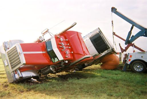

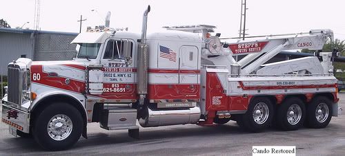

highway Posted November 13, 2011 Posted November 13, 2011 I don't know whether this will really help or not, but here is a pic of the top of a regular 379 hood. You are correct though that the correct Can Do is a 379 powered by a (I think) 3406 Cat engine. I also found a few pics of Can Do I hadn't seen before, and according to the caption on the second pic, it appears as if the real one has been restored as well. Also, if you have a way to either get them printed or print them yourself, let me know and I can scan my decals for you to help in your restoration. I plan on making a 100% correct Can Do and have been gathering the correct parts here and there for years, so my decal sheet is still intact. I guess working the real things made me have to have the little ones be right too!
