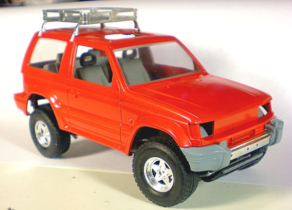

maltsr Posted December 3, 2011 Posted December 3, 2011 I use Tamiya a lot and agree that warming the can helps. I pop the can into a jug of hot water while setting up the parts for spraying, then shake the can well for 30 seconds or so. I usually spray a few light mist coats from about 10 inches away, these dry very quickly, and then a wet coat. Move in closer for the wet coat, I get as close as about 6 inches and move the can quickly to avoid runs. Watch the paint build up and become smooth. Leave for 10 minutes then another wet coat. Same routine for the Tamiya clear, but I usually wait a couple of days after applying the colour before light sanding and clearcoating. Be aware that the wet coats may tend to pull the paint away from door edges and panel lines Some colours seem to lay down really nice as jbwelda says, the solid reds, dark metallic blue are easy to use. As always, practice and don't get disheartened. Once you find the Goldilocks zone for the wet coats, all is sweet - not too wet (runs) and not too dry (orange peel) My recent build of the Speedwagon required virtually no sanding or polishing but this took years of practice and self denial .

Rob McKee Posted December 4, 2011 Posted December 4, 2011 I use Tamiya a lot and agree that warming the can helps. I pop the can into a jug of hot water while setting up the parts for spraying, then shake the can well for 30 seconds or so. I usually spray a few light mist coats from about 10 inches away, these dry very quickly, and then a wet coat. Move in closer for the wet coat, I get as close as about 6 inches and move the can quickly to avoid runs. Watch the paint build up and become smooth. Leave for 10 minutes then another wet coat. Same routine for the Tamiya clear, but I usually wait a couple of days after applying the colour before light sanding and clearcoating. Be aware that the wet coats may tend to pull the paint away from door edges and panel lines Some colours seem to lay down really nice as jbwelda says, the solid reds, dark metallic blue are easy to use. As always, practice and don't get disheartened. Once you find the Goldilocks zone for the wet coats, all is sweet - not too wet (runs) and not too dry (orange peel) My recent build of the Speedwagon required virtually no sanding or polishing but this took years of practice and self denial . Awesome paint job!
