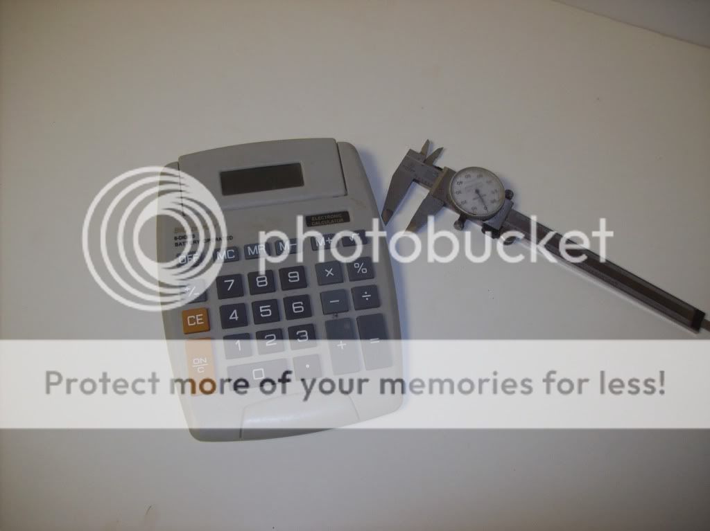

von Zipper Posted December 14, 2011 Posted December 14, 2011 (edited) I would like to help out with this, and hope I don't make it more difficult to understand. First we have to understand the difference between a fraction such as 1/4,1/2 or 3/4 as opposed to a scale value such as 1/24 or 1/32 ect. And then some thing different altogether-decimal value. A fraction is a different subject than scale value when we are going to reduce 1;1 subjects into scale sizes. The way I do it is in a decimal form. An inch will look like this 1.000 If you look at any thing in 1:1 and want to convert it into any scale for modeling we take the value of a foot is 12 inches in 1:1, divide 12 by what ever scale you would like to work in and it will give you the decimal value. A foot is 12 inches divided by 48 (1/48) will equal 0.250 12 inches divided by 24 (1/24) equals 0.500 12 divided by 25 (1/25) equals 0.480 12 divided by 32 (1/32) = 0.375 12 divided by 78 (1/78) = 0.153 If you were 5 ft. 8 in. tall and wanted to make a figure of your self in any scale, you could do it like this= 5ft.8in. would be 68 inches so we will use 68 as the first value divided by what ever scale we use. 68 divided by 48 (1/48)you would be 1.416 tall 68 divided by 25 (1/25) you would be 2.720 tall I bought this dial caliper at a pawn shop for $20.00 and use it all the time on my model bench. If any body would like to start a thread in the "How To" section, I'd be happy to help any one learn the basics of using dial calipers in our hobby.-Chris Edited December 14, 2011 by Zipper
