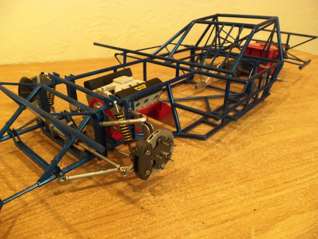

Mooneyzs Posted January 23, 2012 Posted January 23, 2012 Wow... this build is looking great. You are doing a killer job. the frame looks great as well as the front end. You have made some great progress since I last saw this build. Keep up the great work.
BigDaddy Posted January 23, 2012 Posted January 23, 2012 Glad I could help Ken !! Your build is shaping up nicely !! That larger scale is definitely good to get all the details in there. On your 5th Coil/Torque Arm set up...........looks dead on ! However, the torque arm and the 5th coil really only control "axle wrap". They can also help to apply dynamic weight transfer back to the rear axle to aid in planting the rear end. Under acceleration, the rear end will start to wrap or twist along the axle line, and could pull the drive shaft right out of the back of the transmission. A torque arm is there to help with that. Along with that shock or spring rod, which is why it's called a "5th coil", there is sometimes a length of chain between the frame bar directly above the torque arm, and the arm itself. That change keeps the arm from over extending that 5th coil. Alot of the cars will use lengths of chain or stout cables attached to the rear axle, and the frame directly above the axle to keep the axle from over extending the shocks. That would also do what's called "over index the birdcages". Meaning the birdcage would twist so far around the axle, that it would bind up to the point of no longer moving thru it's arc. On an "underslung chassis" which is a chassis with framework under the axle, there is no need for chains or lengths of cable. However, on a chassis with no underslung framework, such as MasterSbilt, you will need to have lengths of chain or cable. Rear steer is controlled by the 4 link set up. Depending on how the car is set up, the links on the left rear will literally pull the left rear tire forward by a few inches to lessen the wheel base on the left side of the car. Creating stagger, so to speak. With a shorter wheel base on the left side, the car will naturally want to track to the left. Or steer to the left. Each chassis manufacturer has it's own baseline set ups for their cars, and then they will fine tune from there. The 4 links are rarely, if ever parallel. Under hard acceleration, such as coming off the corner, the car can be seen all "hiked up", and that left rear is jacked way up in the air. You can see the left rear tire practically rubbing on the back of the cockpit. This is the rear steer at work. When the car is all hiked up, it's called "up on the bars". When entering the corner, the driver will set the car by hitting the brake quickly, or letting off the gas. You can see the car drop down to normal ride height, and the driver will begin driving thru the corner. Once he gets back on the gas, the car will start to raise up on that left rear as the weight is transferred over to the right side of the car. It's called "side bite". Then the driver mashes the gas hard off the corner and the car is all the way up on the bars. This is where the lengths of cable or chain keep the rear end from going too far. At this point, the bars will be nearly vertical as the chassis lifts from the power being transferred. Again, the 5th Coil helps with this. All of these things work together, in unison to get the most traction as possible, thus making the car as fast as possible. The birdcages, are the aluminum blocks that the shocks, and the 4 links are attached to. They rotate around the axle so the axle can move thru it's suspension arc. The literally "float" on the axle. They dont move side to side, but will rotate around the axle. They are just mounts for the shocks and 4 links. Another item to add to your build is the "J-bar". This acts like a panhard rod on the rear end. It's called a "J-bar" because it's shaped like a "J". The curve, wraps around the pinion of the rear end, where the drive shaft mounts its u-joint. The other end, the straight end, will mount at a point on the chassis on the left side of the car. This "J-bar" will be parallel with the rear axle. However, the "J-bar" itself is never parallel with the ground. Just like a panhard rod...or in Nascar circles, a "track bar".........it controls the roll center of the rear end. It's mounted to a plate that mounts to the pinion on the rear end center section. It will have a few holes for adjustment in it. Whereas the frame mount of the J-bar will have several vertical holes for adjustment. Wow........I rambled on and on !!! Sorry for the "suspension lessons", but these cars have become very technilogically advanced, and it kind of facinates me on how it all works together. At any rate, I will be following along with your build as it has captured my interest !!!! Great work so far, keep it up !!!!

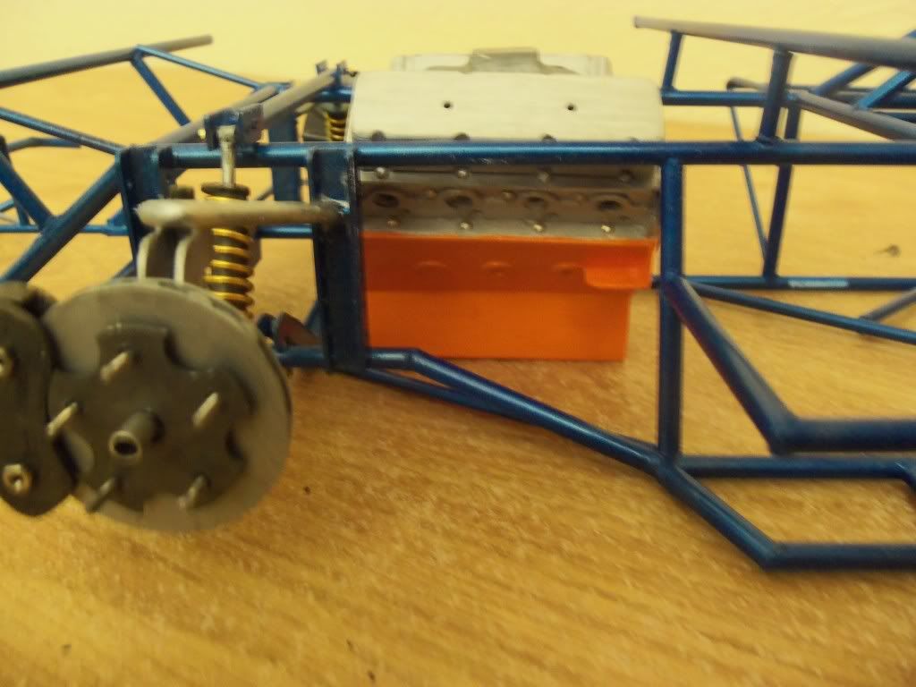

Old Sprinter Posted January 25, 2012 Author Posted January 25, 2012 Okay back to model building, if I had the money it would be real. So I have got the motor far enough along to set it in the chassis. Big block Chevy with a million or so cubic inches.LOL
BigDaddy Posted January 26, 2012 Posted January 26, 2012 Looks great Ken !!! However, big blocks arent used in Late Models. Too heavy. Small Blocks, bored out to upwards of 430 ci are common for Open Late Models. Weekly-rules style Late Models will max out at around 364 ci. 406, 415, 418....etc. are just a few of the common displacements in the Open rules. But, they're all Small Blocks, be it Chevrolet, Ford, or Mopar. Now, back in the 70's, Late Models were using Big Blocks, because they were stump pullers, and the tracks were always heavy, and muddy in those days. A track like that, back then, would blow the bottom end out of a Small Block !! As you know, tracks nowadays, are all dry slick. Of course, this is YOUR model, so really, you could have a SuperCharged Hemi Detroit Diesel in there if ya wanted to !!!

Old Sprinter Posted January 29, 2012 Author Posted January 29, 2012 Thank you both." After Further Review" ( as they say in the NFL) I'm building a small block Chevy for this Late Model so I should have some new photos by mid week. Ken

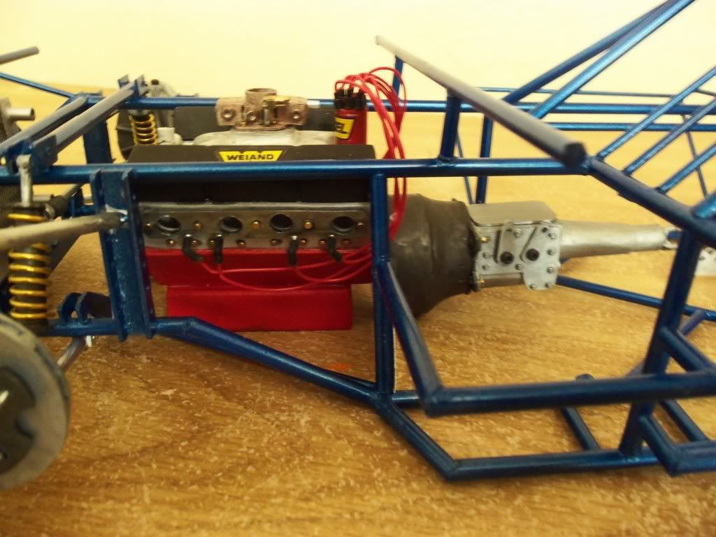

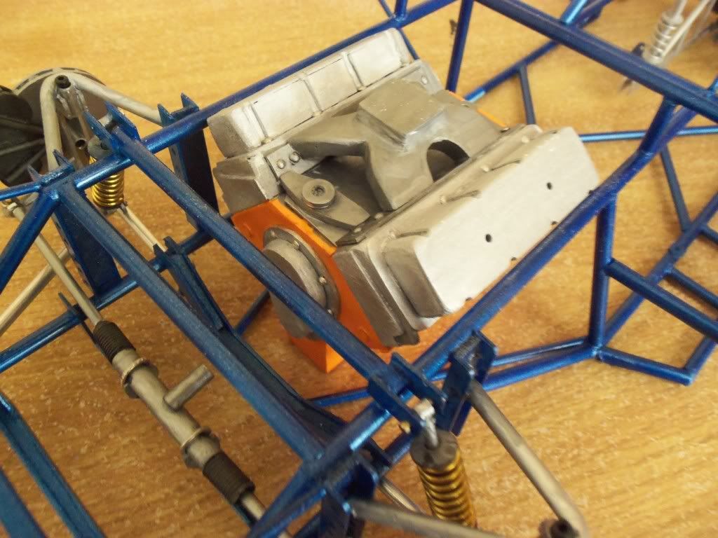

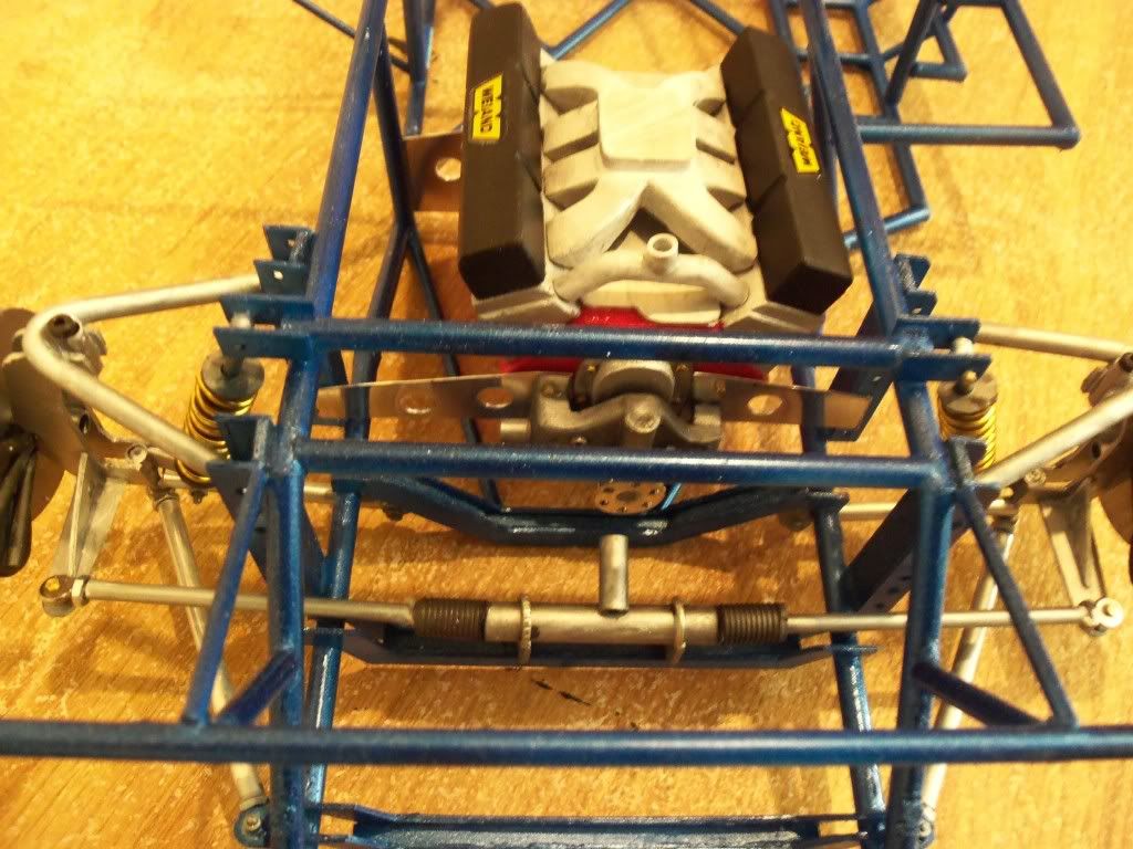

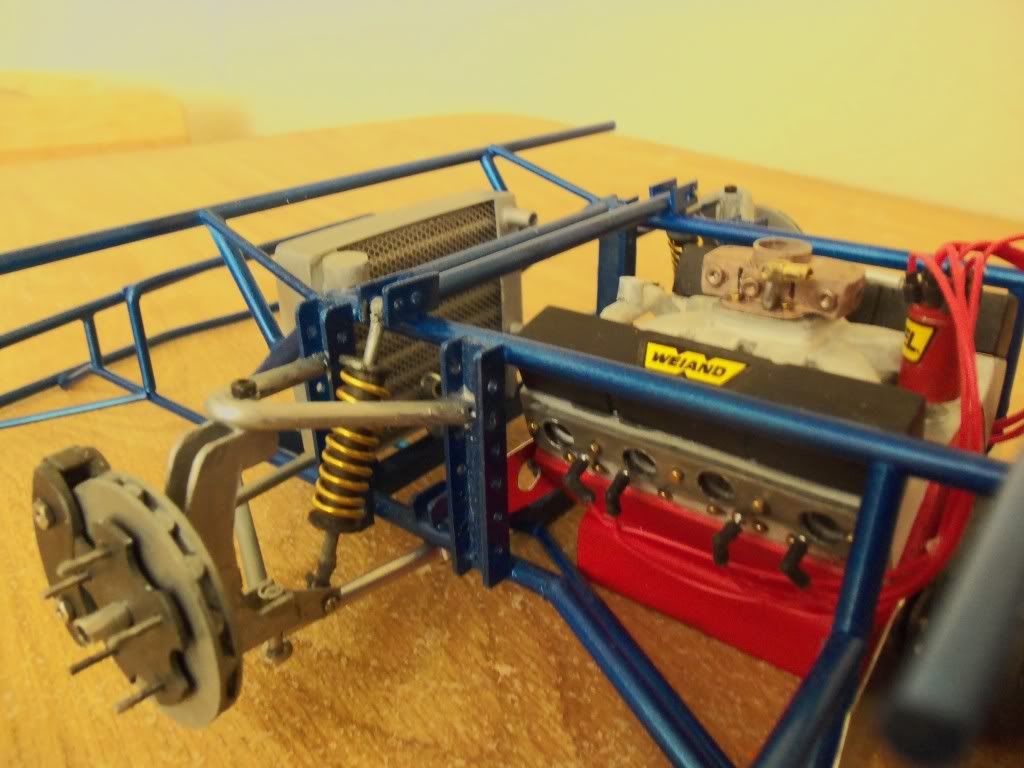

Old Sprinter Posted January 31, 2012 Author Posted January 31, 2012 (edited) Okay, I built a small block to replace the big motor. It is the right thing to do and I will build a big block modified, someday to put that giant in. Installed the motor plates and ready to move on to the transmission and radiator. Ken Edited January 31, 2012 by Old Sprinter

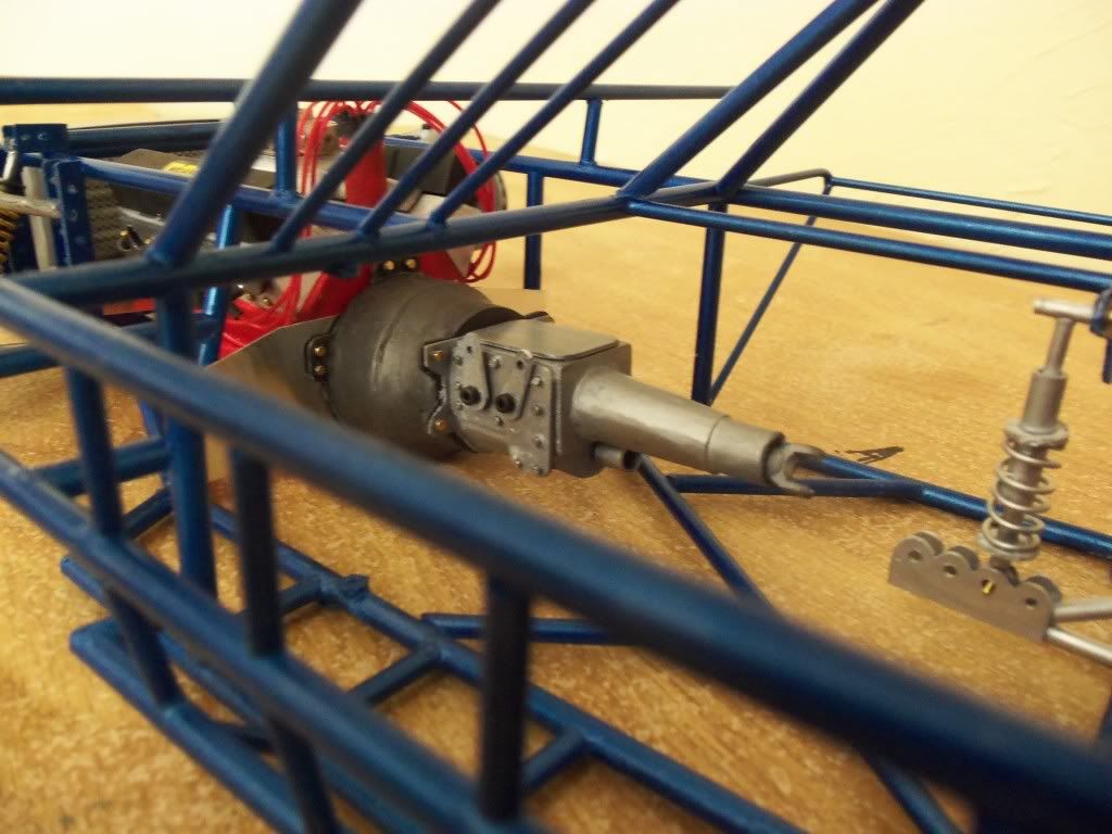

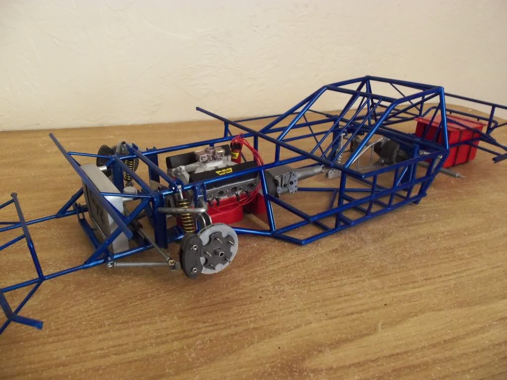

Old Sprinter Posted February 2, 2012 Author Posted February 2, 2012 Thanks Dave and Joe. It means a lot to me. I installed the Brinn transmission, scatter shield, radiator and ignition system. Next up is to finish the rear and make the driver's seat and cockpit.
roadhawg Posted February 2, 2012 Posted February 2, 2012 Lookin' awesome!! What color is the blue? I'm starting on an asphalt car and need that same color....or close to it.
Romell R Posted February 2, 2012 Posted February 2, 2012 THIS IS FABTABULOUS!!!!! is that a word? Well it is now.... Great job on the motor and all the fab work tranny looks great too. one question looks like the drive shaft will be at an angle to connect to the rear axle tranny seems to be sitting just a lil on the high side, or is that just picture perseption. (picture perseption?? ) or do these cars run that way?
Old Sprinter Posted February 2, 2012 Author Posted February 2, 2012 (edited) Thanks Tommy and Romell. The color is a Tamiya TS-19 metallic blue. The transmission lines up with the crank shaft and there is only a quarter of an inch ( scale 2") difference between the output universal joint and the center section pinion of the rearend. The rear needs to raise up slightly but I think you're suppose to have the driveshaft on a 3 to 6 degree angle downward. Could be wrong, but that's the way open wheel cars used to be. It does look a little goofy in the picture because of the angle of the photo. Ken Edited February 2, 2012 by Old Sprinter
Romell R Posted February 2, 2012 Posted February 2, 2012 Thanks Tommy and Romell. The color is a Tamiya TS-19 metallic blue. The transmission lines up with the crank shaft and there is only a quarter of an inch ( scale 2") difference between the output universal joint and the center section pinion of the rearend. The rear needs to raise up slightly but I think you're suppose to have the driveshaft on a 3 to 6 degree angle downward. Could be wrong, but that's the way open wheel cars used to be. It does look a little goofy in the picture because of the angle of the photo. Ken Yeah I thought my eyes could be playing tricks on me thx for clearing that up buddy.
