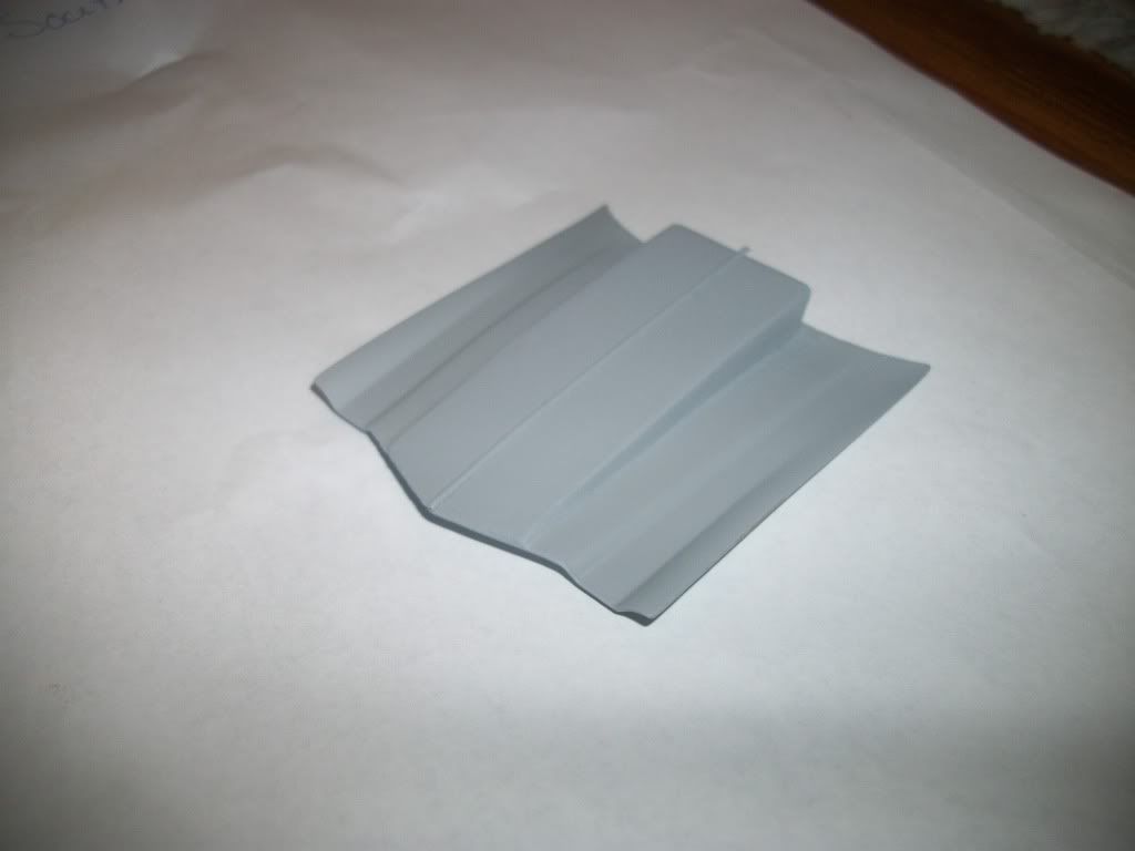

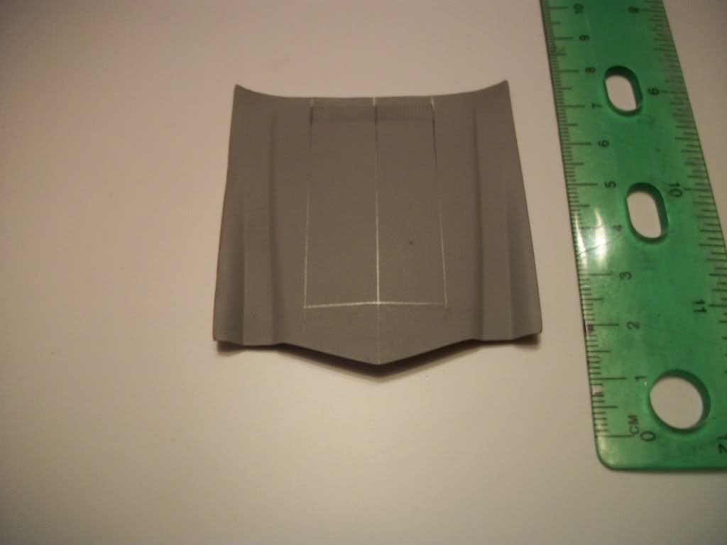

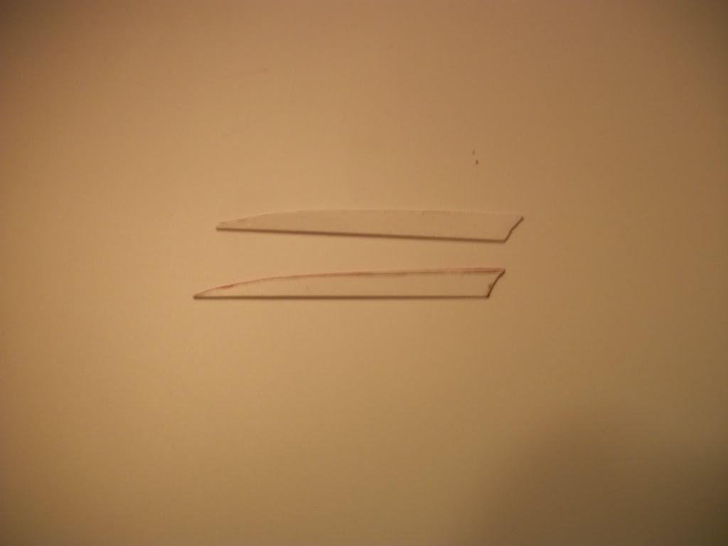

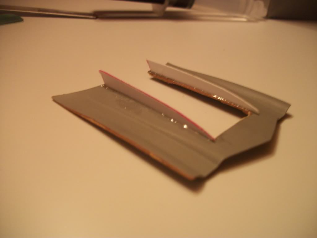

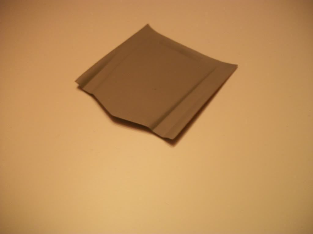

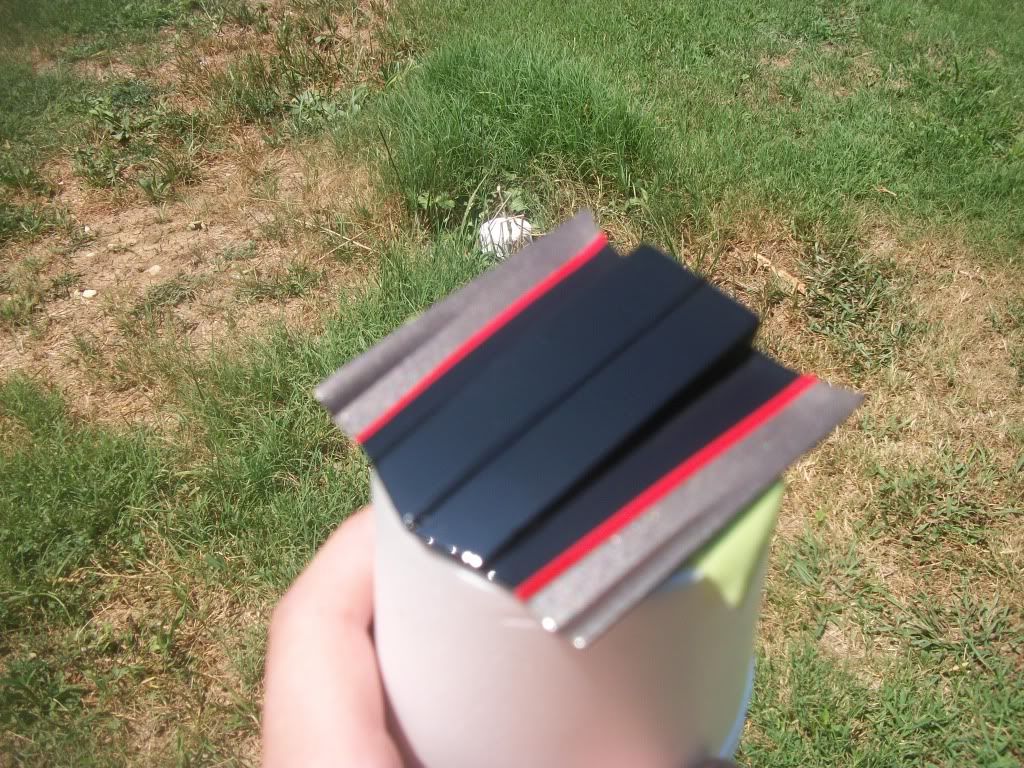

BKcustoms Posted January 8, 2012 Posted January 8, 2012 (edited) Well I figured I would show how I make cowl hoods for my projects, This is by no means the only way to do this but it usually works out well for me. What you will need: .040 sheet styrene Ruler Hobby knife with sharp blade (scissors will also work) Half Round styrene strips. Here is the hood that will recieve the scoop Start by marking the center line of the hood and where you want the edges of the scoop to be with a pencil or sharpie Now cut out the area in between the outer lines (this will be the opening under the scoop) Now measure the length of the hood and figure out how tall you want the scoop to be, and cut the side profile of the scoop out of sheet styrene twice (one for each side) Next glue these pieces to the outside of the hole in the hood. After that is dry, cut a piece of styrene to fill in the space between the sides of the scoop. Edited January 8, 2012 by BKcustoms
SuperStockAndy Posted January 8, 2012 Posted January 8, 2012 Thanks for doing this, I'm going to build a cowl hood for a '70 Camaro too

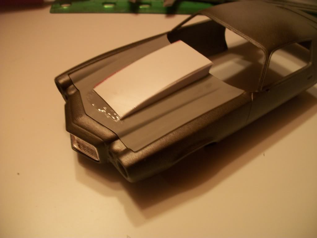

BKcustoms Posted January 8, 2012 Author Posted January 8, 2012 At this point you could fill in the gap in the front and have a smooth scoop or you could use some half round strips to make a body line down the middle like I did here Then use your favorite filler to clean up the edges and you can prime and paint it Hope this helps, let me know if anything doesn't make sense......Billy

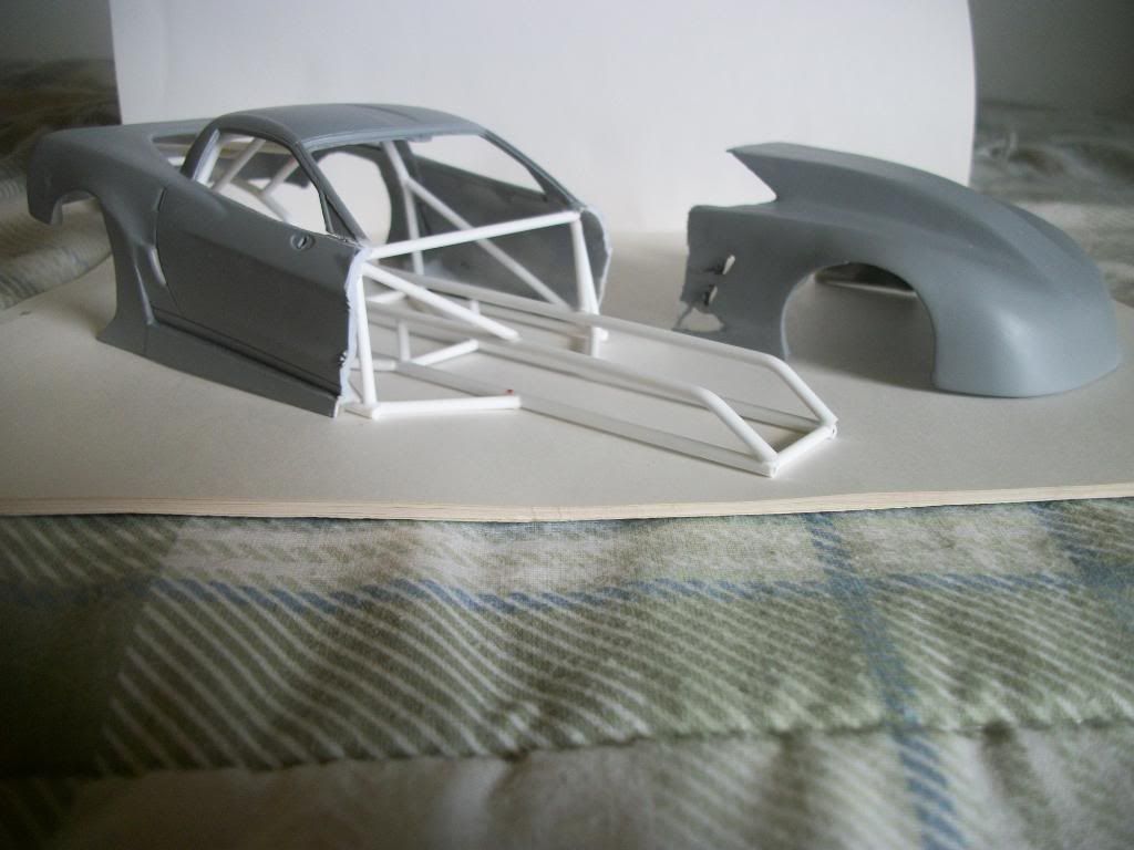

BKcustoms Posted January 8, 2012 Author Posted January 8, 2012 Here are a few other hoods I did using this technique 2002 Camaro ZR1 pro mod Thanks for doing this, I'm going to build a cowl hood for a '70 Camaro too Glad I could help!
