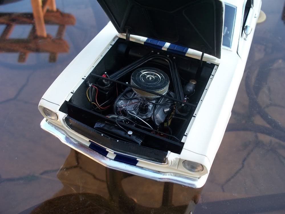

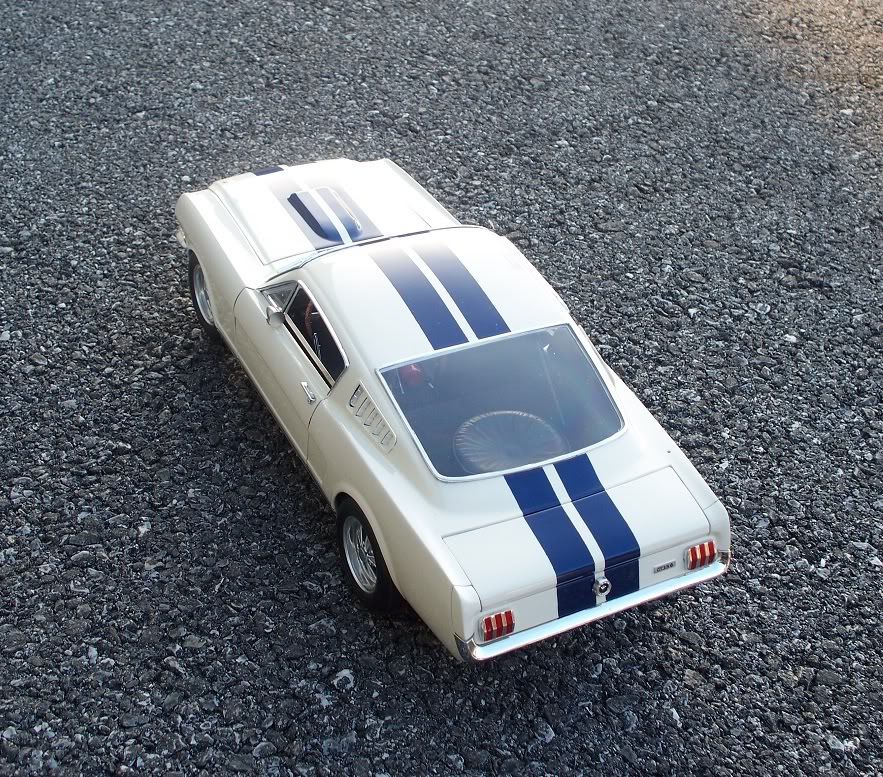

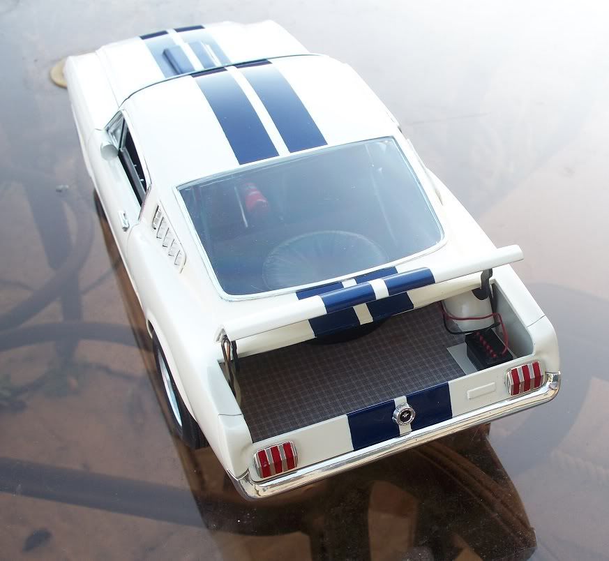

Hawk312 Posted January 10, 2012 Posted January 10, 2012 I can officially call this finished now, and finally. I started this back last July, starting from the Road and Track Revell kits from the `80`s. The kit took alot, and I mean ALOT, of work to get it to this point. I made alot of modifications to the body to try to get it to a convincing shape. If I had more time, I would`ve done even more with the roof line and A pillars. The suspension was lowered probably about 4-5 scale inches in the front, and about 2 or 3 in the back. The tires are the "skinnies" from the Corvette/Camaro Revell kit. I also needed to add alot of details that you wouldn`t expect. For instance, there was no radiator hose connecting the radiator to the engine. :confused: Let me know what you think.

Prostreet Posted January 10, 2012 Posted January 10, 2012 Great build, paint looks beautiful. Oil pan looks a bit low, watch out for those speed bumps lol.
eviltwincustoms Posted January 10, 2012 Posted January 10, 2012 I agree, this is an awesome build. I would love to have a real GT350 in my driveway! The pic of the car sitting on that table, not sure what it is on, but that looks like a scale parking lot with cracks filled with Tar. Much better than the pic with the car sitting on the 1:1 blacktop. Looks out of scale, if you can photoshop that one pic and get rid of the chair you should put that pic in the "Is it Real or a Model" section.

deja-view Posted January 15, 2012 Posted January 15, 2012 (edited) Hi david (and all); I'm new to this forum, but have been building for over 50 years. I was particularly interested in this GT-350 because I have 3 of them sitting on a shelf with a "plan" to make two of them into the Camee and Christee Edelbrock sister's racing versions from years ago. I also restored and own a concourse 1966 Mustang GT convertible (factory) so I have quite a bit of research material and experience with the construction of the early Mustangs. I really appreciate the effort put into this model because Revell did a pretty poor job on the panels and some other details. I suspect it was just a retool of the old Bandai/Renwal kit from the 1960's. I hope I ever get to really working on the Edelbrock versions, but of course they will need the race front end rather than the chrome bumper. Until I have that there's not much point in starting. I will include a link to my Fotki website if you want to look at the Mustang pics or other 1:1 cars I have or have had for reference...or at the models have. But to one of the points of this post: I think this is a very, very nice build for sure. There is, however, one rather glaring mistake, and I think it is the fault of Revell or whoever issued the original insructions ( pulled them out and affirmed this). The radiator on all those Mustangs sits behind the radiator support, and not between the support and the grill. I'm not sure if this one could be moved now, but for future reference it should be placed behind. I'll try to post a pic if I can figure it out. Not trying to bust chops here...just trying for accuracy. Hosted on Fotki And a GT-350: Hosted on Fotki Cheers. http://public.fotki.com/dallas916/ Edited January 15, 2012 by deja-view
deja-view Posted January 17, 2012 Posted January 17, 2012 (edited) David...and all others who build this model; There is another error in the kit that should be corrected as you build: the GT series Mustangs with front disc brakes (Shelby or not) all had a larger, flat-topped master brake cylinder/reservoir. They did NOT have power brakes, and therefore would not have a vacuum booster. It is just one of the proper things to verify when looking at any Mustang claiming to be a real factory GT. I suspect this kit was adopted from the mid-sixties Renwal/Bandai kits of the NON-GT Mustang fastback. Without checking I don't believe any power brake option was available on these early Mustangs, and came into play on the Thunderbirds before the Mustang. But still, power DISC brakes were not available....and of course, ALL GT Mustangs had disc brakes up front. FYI: they really don't work all that well. The Mustang could get up and go, but didn't stop very well. This is the correct brake line routing (with distribution block) for GT Mustangs: Hosted on Fotki This is the flat cap that is a quick giveaway to the disc brake reservoir: Hosted on Fotki And, here's the correct control arm/spring/brake line/shield/spindle detail at the wheel: Hosted on Fotki With the brake rotor/hub assembly in place. Note the pwer steering rack to the upper right of the shield: Hosted on Fotki Edited January 17, 2012 by deja-view

Romell R Posted February 27, 2012 Posted February 27, 2012 David i absolutly love this build, but I do have a question (and im not sure if its already answered) but did the actual car come with a more aggressive rear tire or were they skinnies like this? The reason I ask is because when i was a kid my mom owned one and i thought I remembered wide tires on her car (i could be totally wrong as I was very young) Regards Romell
Hawk312 Posted February 28, 2012 Author Posted February 28, 2012 Thanks again everyone! David i absolutly love this build, but I do have a question (and im not sure if its already answered) but did the actual car come with a more aggressive rear tire or were they skinnies like this? The reason I ask is because when i was a kid my mom owned one and i thought I remembered wide tires on her car (i could be totally wrong as I was very young) Regards Romell In most of my reference pictures, the tires were about twice as wide as the ones on this build. I am assuming that they had the original size tires? The buyer sent me about 50 pictures and he was really exact on what he wanted. He actually restores 1:1 cars, so I am guessing the pics he sent me were of accurate restorations. I think the kits tires were *really* wide, even wider than the slicks from the Camaro/Corvette/`57 Chevy kits, and just looked blocky and out of scale.
